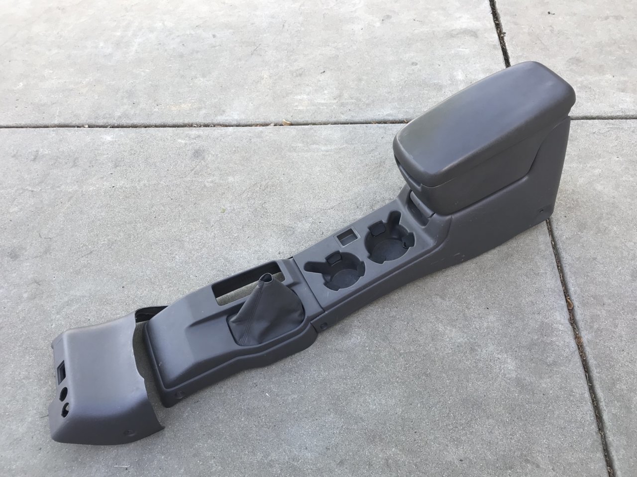

    I’ve been trying to find a OEM center console for my 1995 tacoma for a while now and haven’t had much luck. I’ve heard people say that 95-2000 have the same center console as the 96-02 4Runners but I still haven’t been able to find one online. Where should I look online to find one. Thanks

    The 96-02 4Runners have the parking brake in the center console so you’ll be losing a lot of room
    You don’t want the useless 95-00 Tacoma console either. Go find yourself a 01-04 Tacoma double decker console with real cup holders. 100x more usable.

    I’ve only been seeing consoles for autos. Would it fit my manual 4wd console/shift boot?

    Ignore everything forward of the cupholders. All center console designs are universal for all first gens, 1995-2004 manual, auto, extended cab, single cab, etc.

    Awesome it looked like it would be ok

    Make sure if you get the 01-04 console, you get the bracket that goes underneath the rear of it. That's what allows you to mount it to the floor properly.

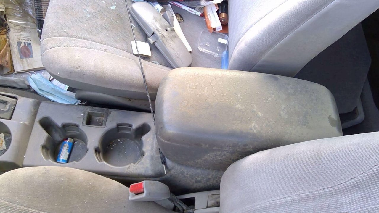

    ...no shortage of these off ebay......however if you can find one on facebook market might be 1/4 the price.....

    That a parts truck?
