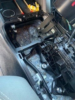

    On our last long trip my wife noticed that the cups in the cup holder were getting warm. I pulled the center console and saw there was a little insulation but lots of bare metal on the transmission hump, hence the heat and warm cup holders, especially the front two.

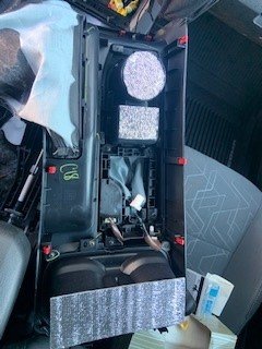

    So I had some this insulation lying around (It was one of the folding windshield heat shields. I used part of it to insulate the bottom of my daughters terrarium (Gecko)). I used some silicone to glue them to the bottom of the cupholders.

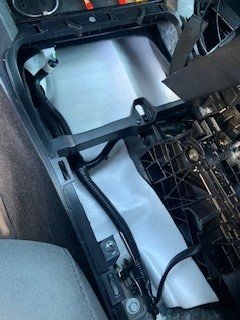

    Then I laid some of it down on the tranny hump with the reflective side down.
    If this works at least partially I may find some better insulation to see if I can cut the heat from the tranny hump. It really needs to be insulated better. It took about 30 minutes with about a dollars worth of material. YMMV
