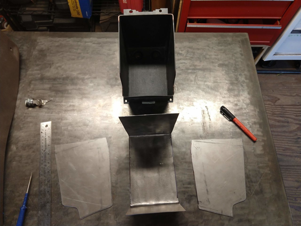

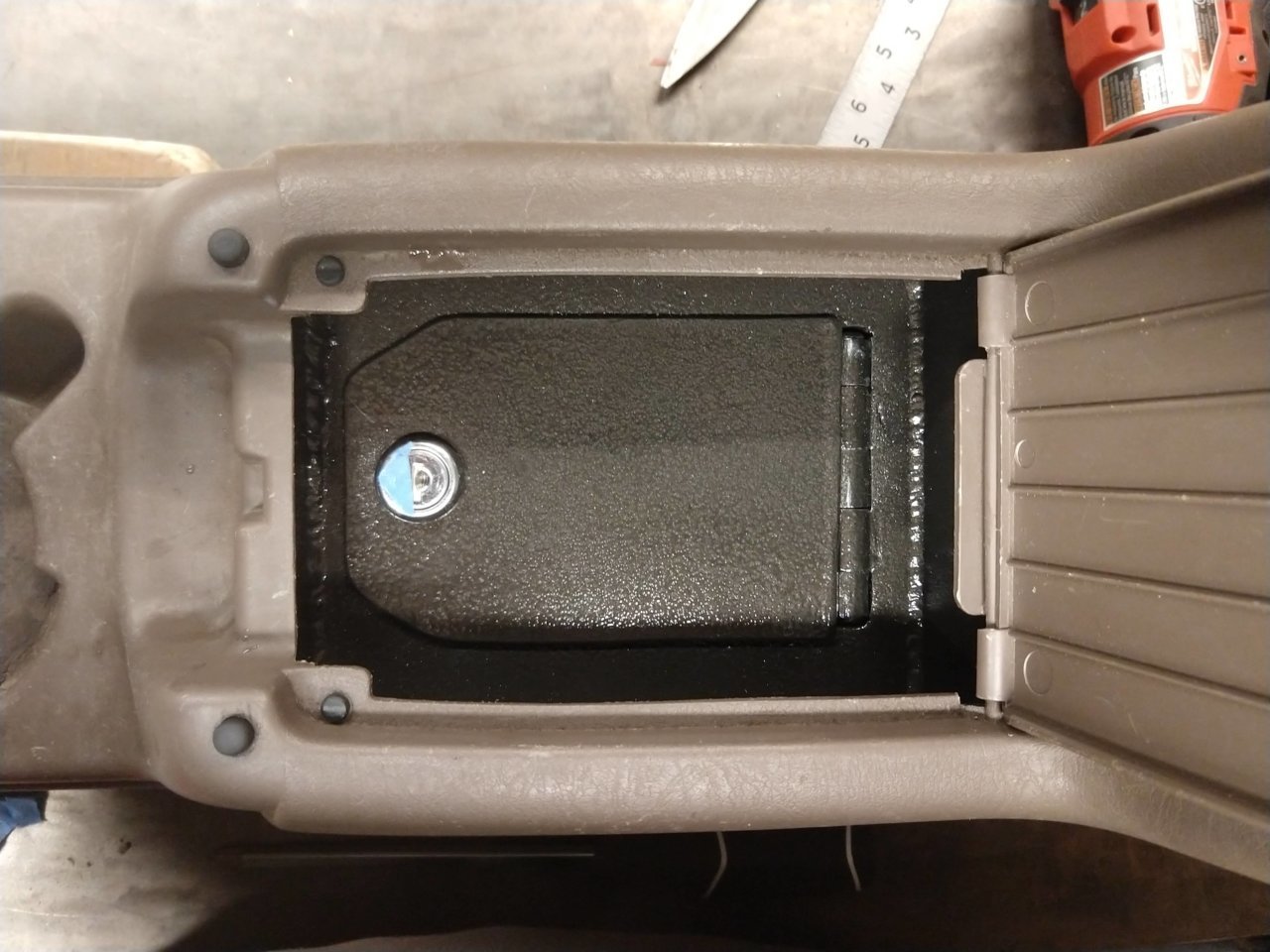

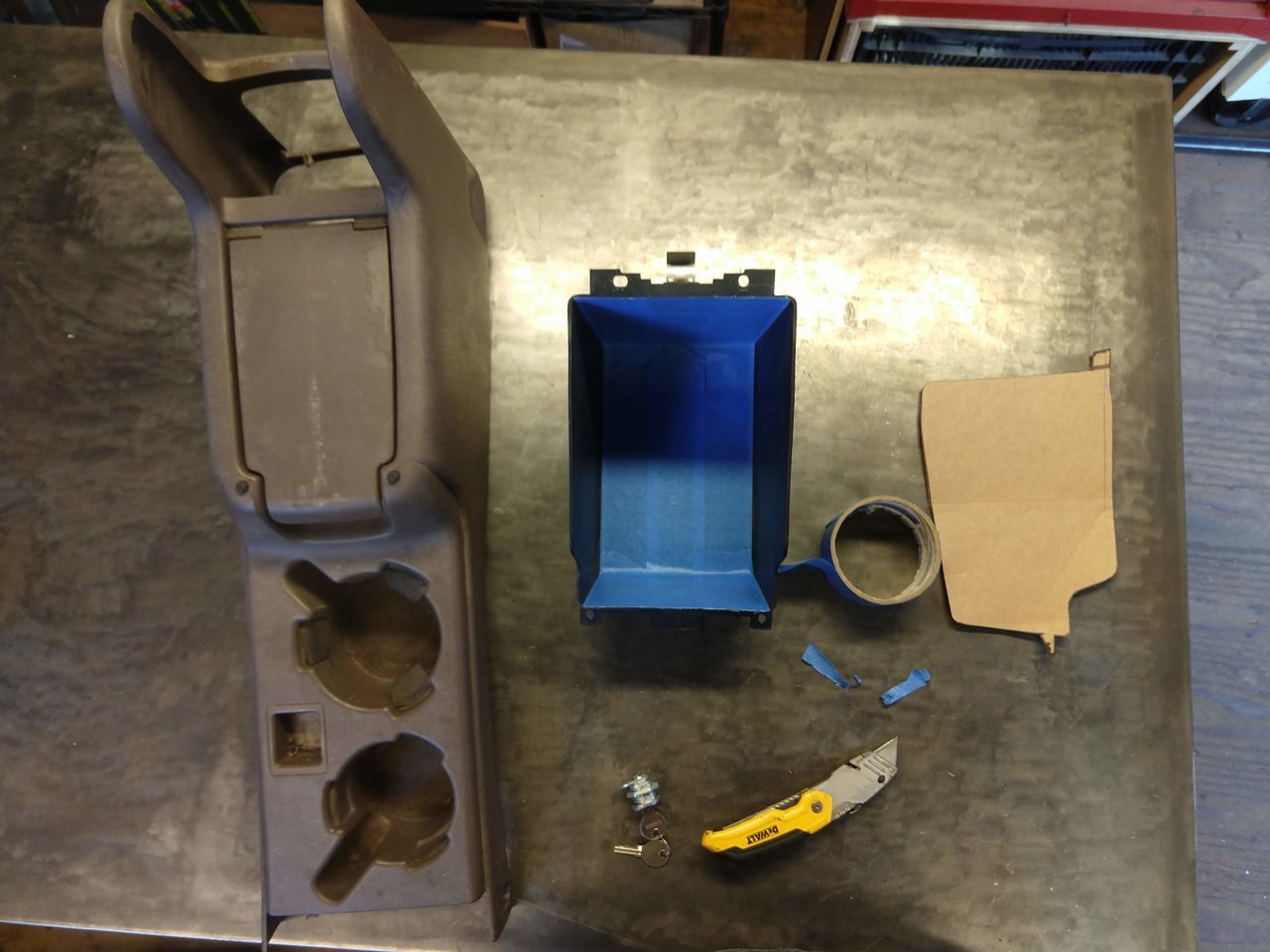

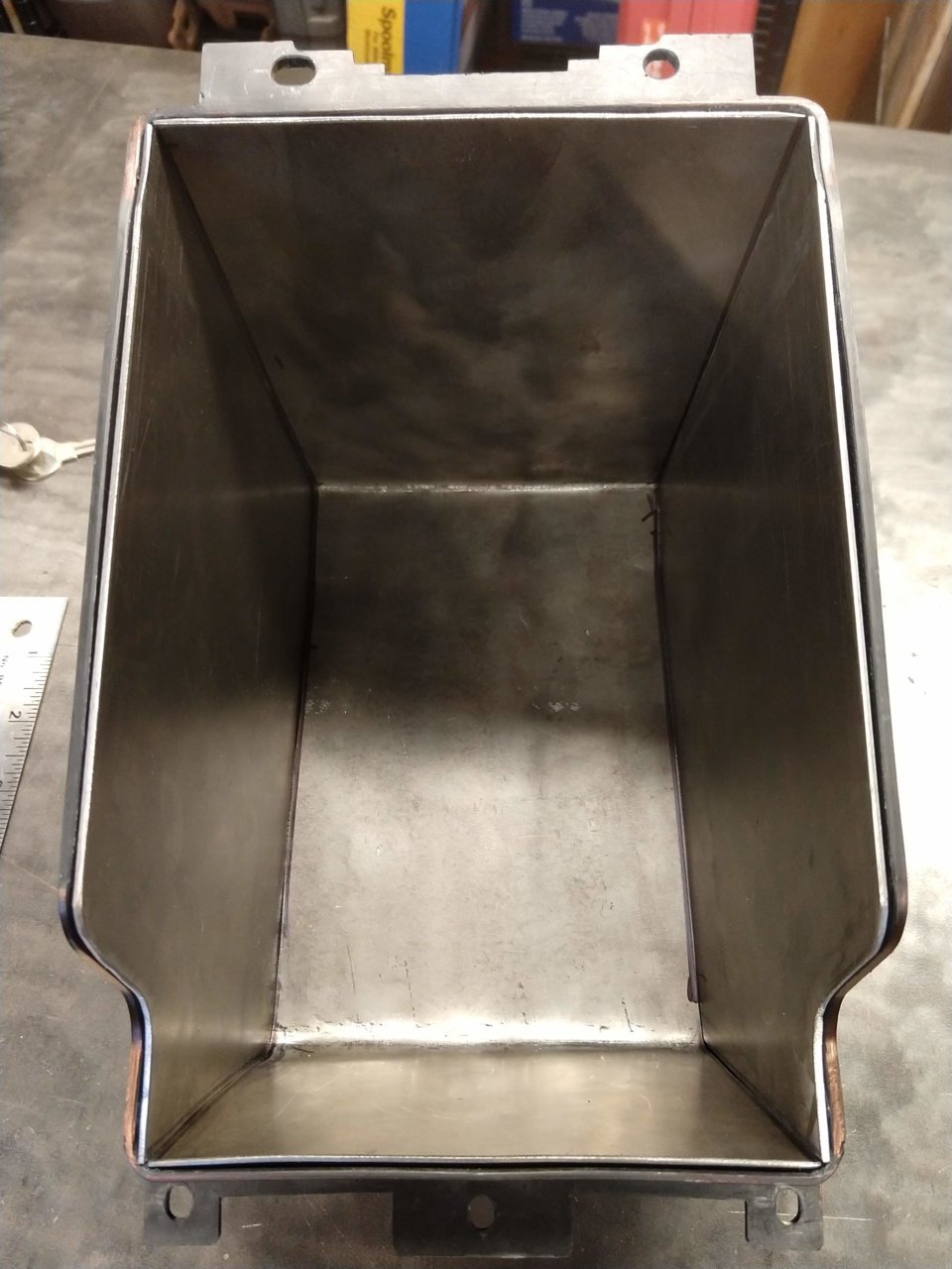

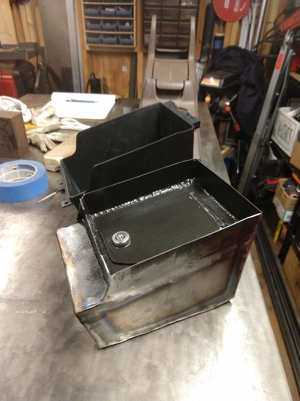

    Headed to Baja this winter and wanted a fairly safe spot that was easily accessible in the cab. Fabricated this lockbox for the lower section of the center console and am psyched on how well it came out. I was inspired by someone else's thread on here. It's funny there's a bunch of aftermarket stuff you can buy like this for 2nd and 3rd gens but no one ever started making them for the first gen's. It's fully TIG welded, 14ga on the sides, and 1/8" for the top and lid. I even was able to use a UWS toolbox lock cylinder from etrailer that matched the locks on my shell to avoid adding additional keys to the truck. If a couple people want one I'll make a few for members on here. DM me for pricing and info.

    Nicely done, why not make it the same height as the original opening?

    I went back and forth on it. Even thought about dropping the lid lower and making it a false bottom with some felt. But I'm always losing receipts and things like that so I thought the upper portion would be a great place to stash that sort of thing. I couldn't think of anything I needed to lock up that big. Mostly just phone, passport, cash, that sort of thing. It's definitely not an impenetrable safe, but should slow down smash and grab type thieves enough to have them looking elsewhere. I could make them with any height deck though. I don't currently own any guns, but it seems that's what a lot of people use these for and looking at mine I think a small sidearm would fit well in there.
