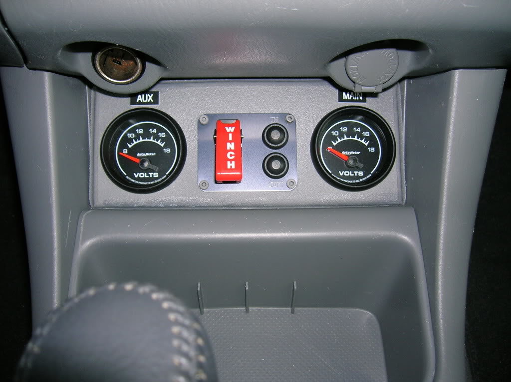

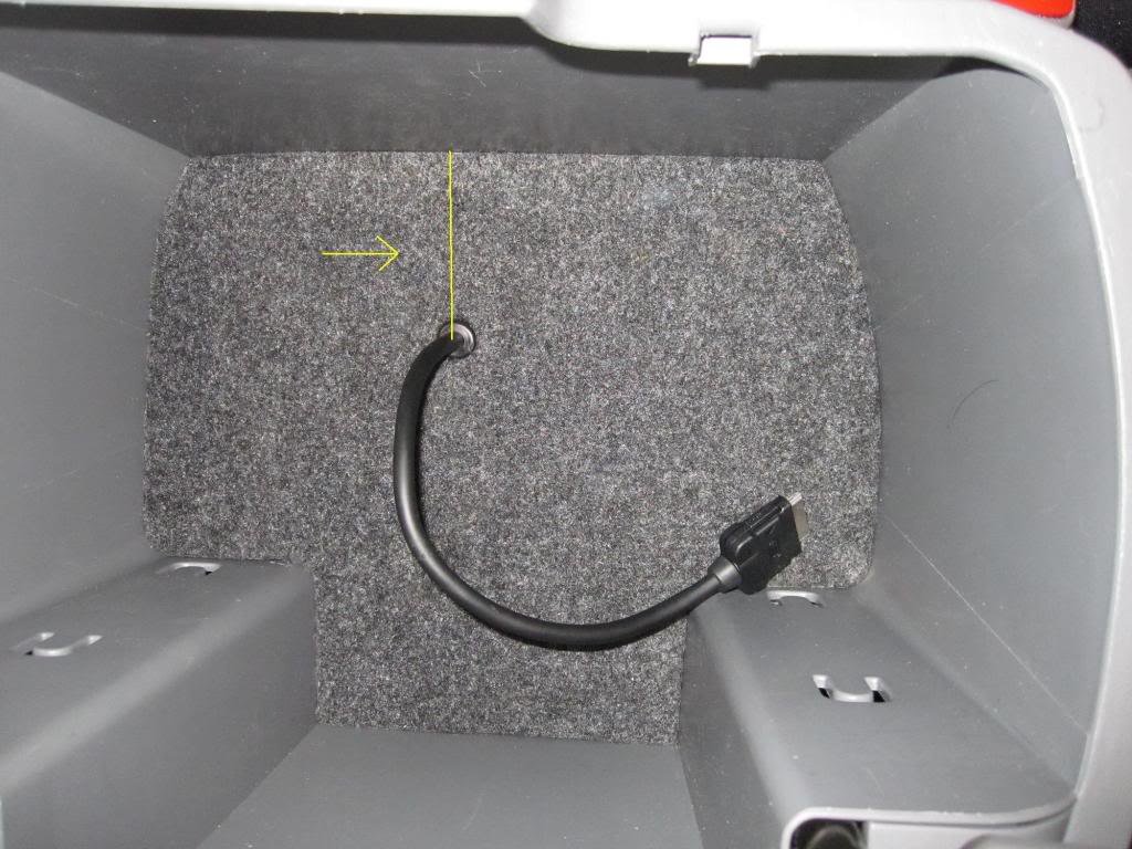

    I had to do this to run my iPod controller into the console:
    And to make my custom dual battery gauges and winch controller:

    My PA15-TOY is in the glove box. I like what you did. Could you supply some details ? How do you get the wire thru the grommet and thru the bottom of the center console ? The ends of the wire, especially the end in the pic are too big. Thanks.

    Yeah, my solution was to use a sharp blade (hobby knife) to cut the cardboard/carpet console bottom in a straight line (as shown by the yellow line in the pic). I cut directly from the edge to a hole I drilled large enough for the rubber grommet. Once you put it back flat, you can't see the cut b/c fo the carpety bottom.

    Wow. Not whip em out wed. just wow. I'm impressed with you computer skill, the yellow line and arrow in the pic. Thanks for sharing you secret. I guess it's a split grommet.

    I like what you did with the winch set-up. I'm thinking of doing the same but basically gut out the whole center console and customize it myself. Where do you get the mountings for all of that so it looks nice and not just hanging wire and switches?
