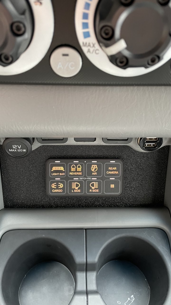

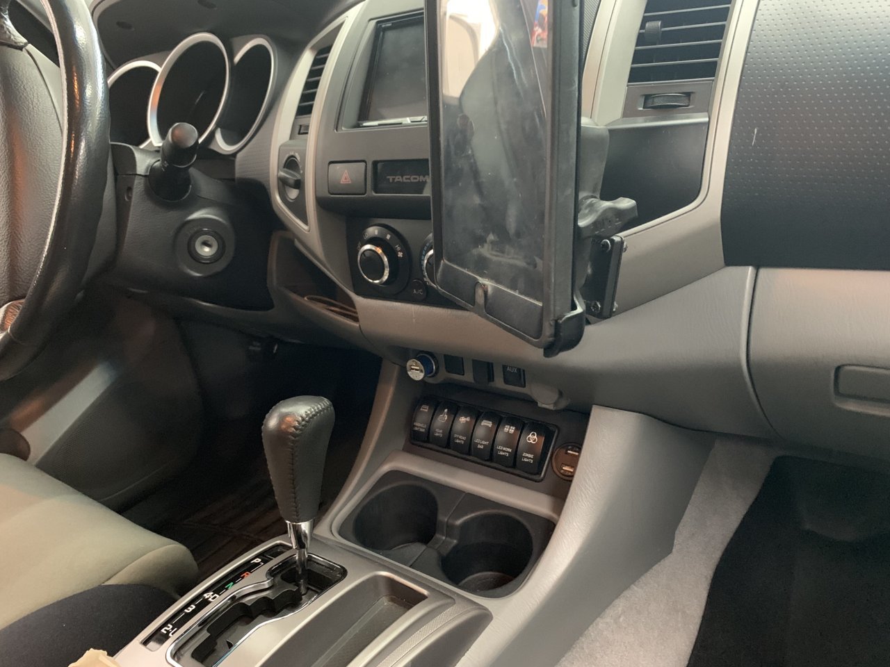

    Is anyone making these panels. I would be fine with it being blank. This way I could install my own switches

    I'm looking for one of these also, blank filler preferably so I can do combo switch and power ports. Anyone know of any being made?

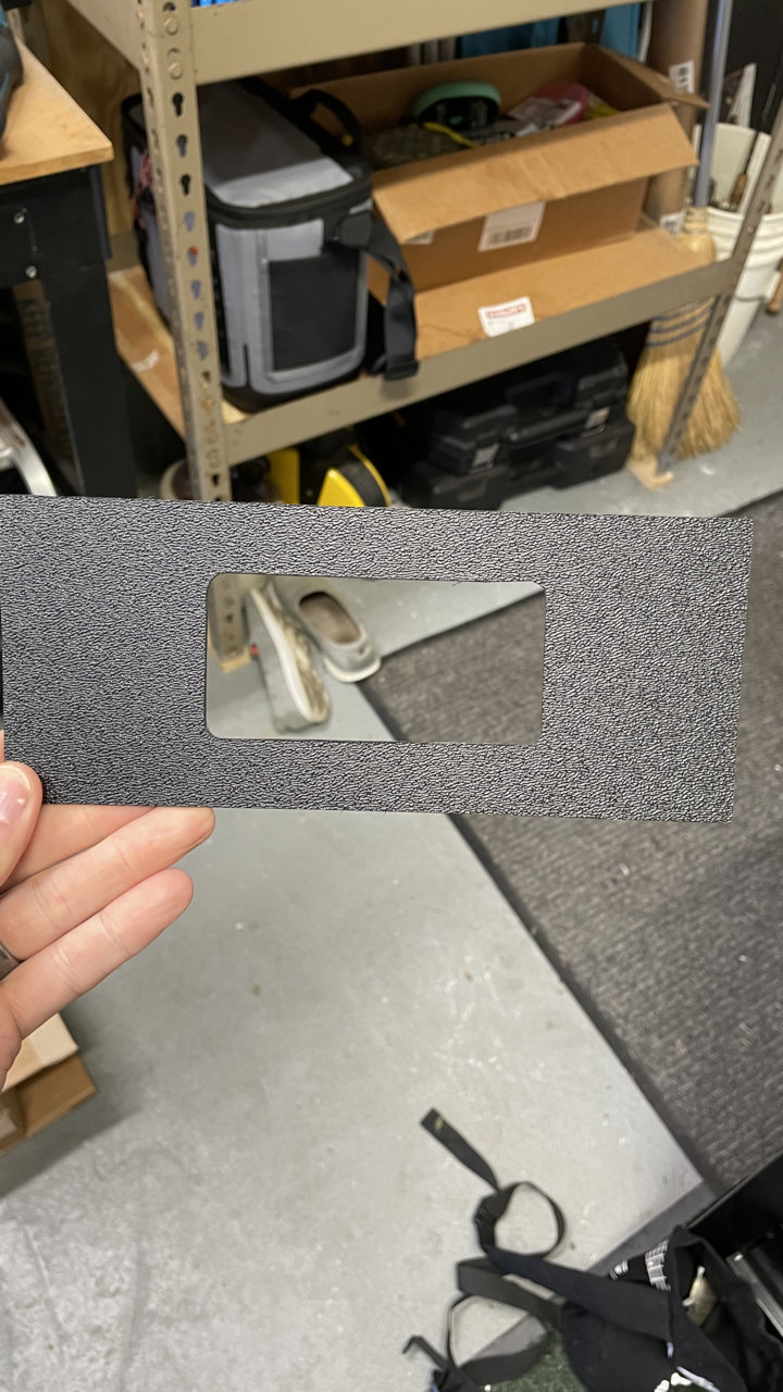

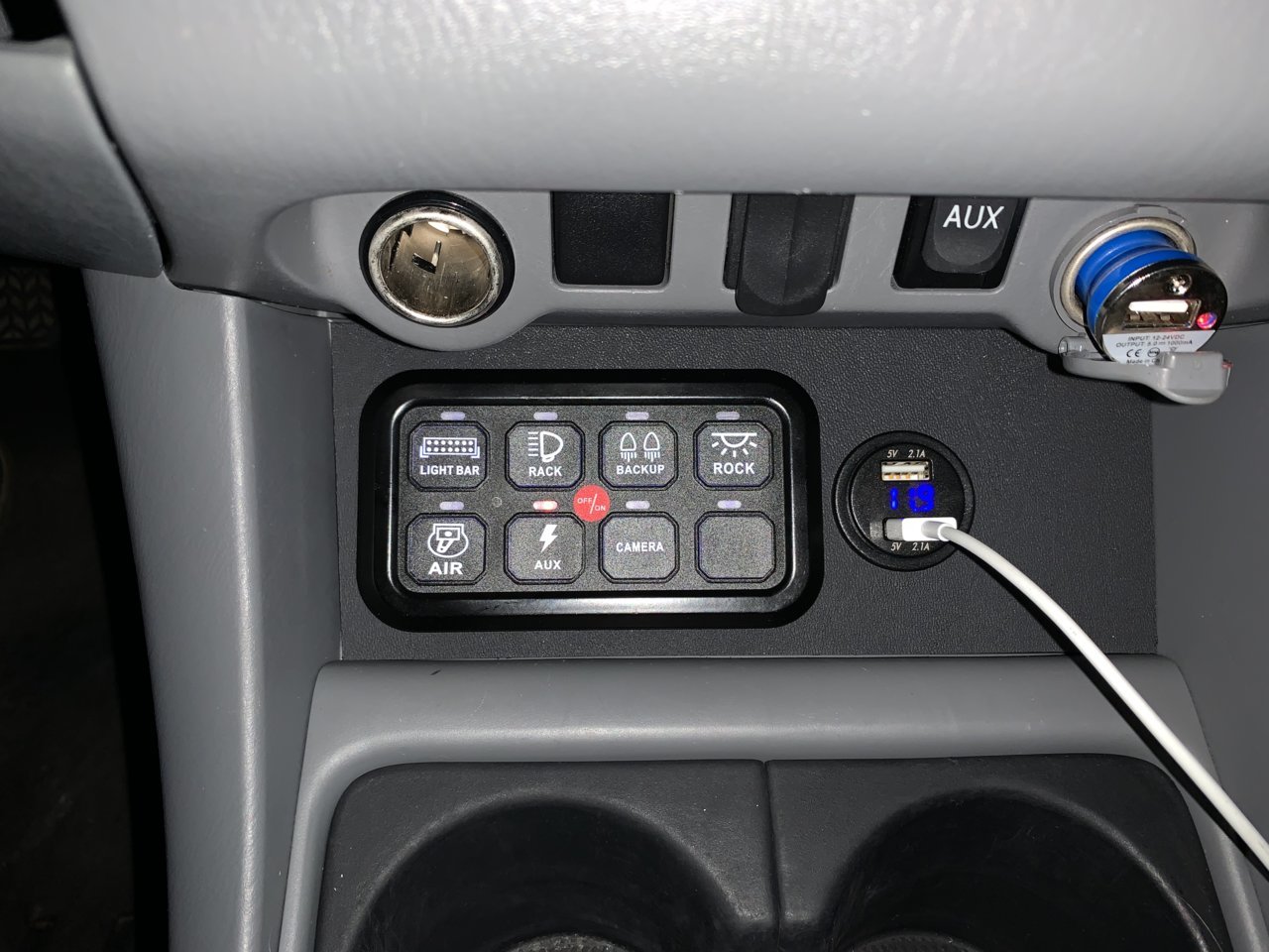

    I have a panel that i made for my switch pro. Then I moved it. I could measure it. I used a piece of black abs plastic 10F934DA-0910-4485-9703-C1EE20FD8608.jpgB46C6A14-1544-4326-90E4-9EB2EACE8C70.jpg

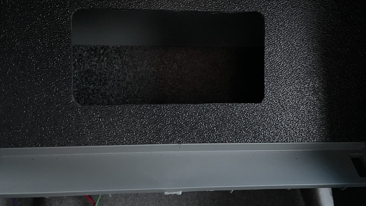

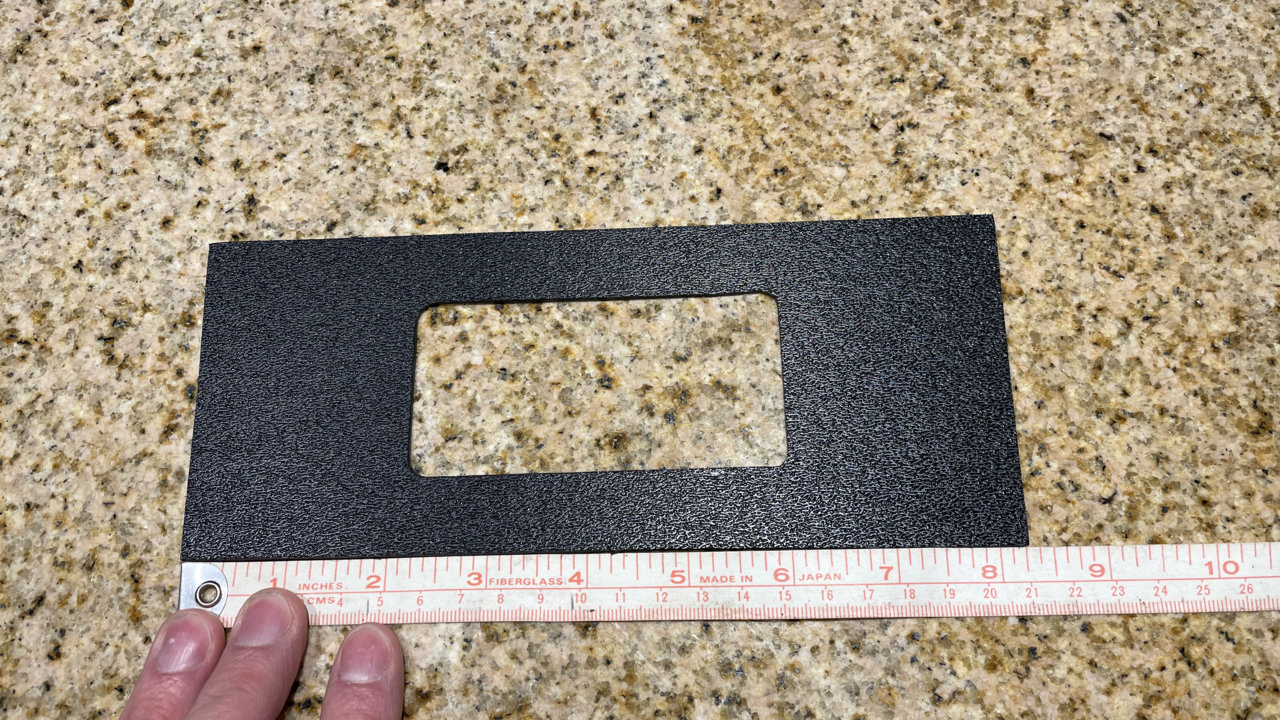

    Its has tapered sides. I did alot of filling and test fittings to get it pretty close
    The top measures 8 1/2
    The bottom is 8 1/4
    And the sides are 3 1/2 total in length tapered. And when I installed it i used some of the plastic and made 90 degrees brackets and adhered them with 3m double sided tape
    And the bottom edge rests on the lip of the cup holder tray. So when you snap the plastic in it holds it really snug
