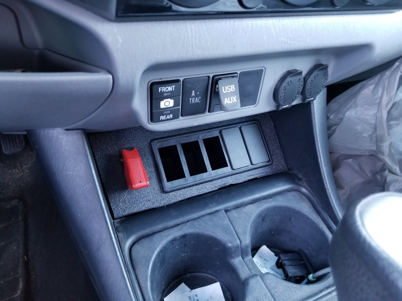

    I bought one and used it to install my Ham Radio and Anytime Backup Camera DPDT switch.

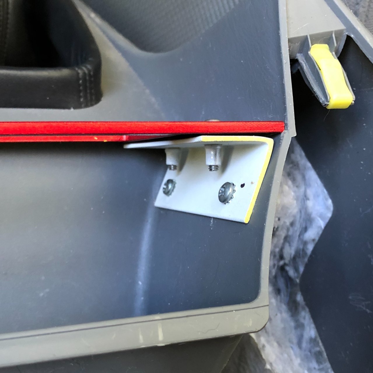

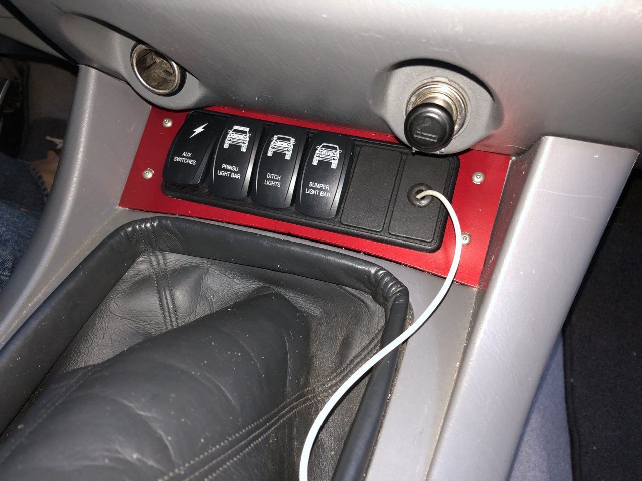

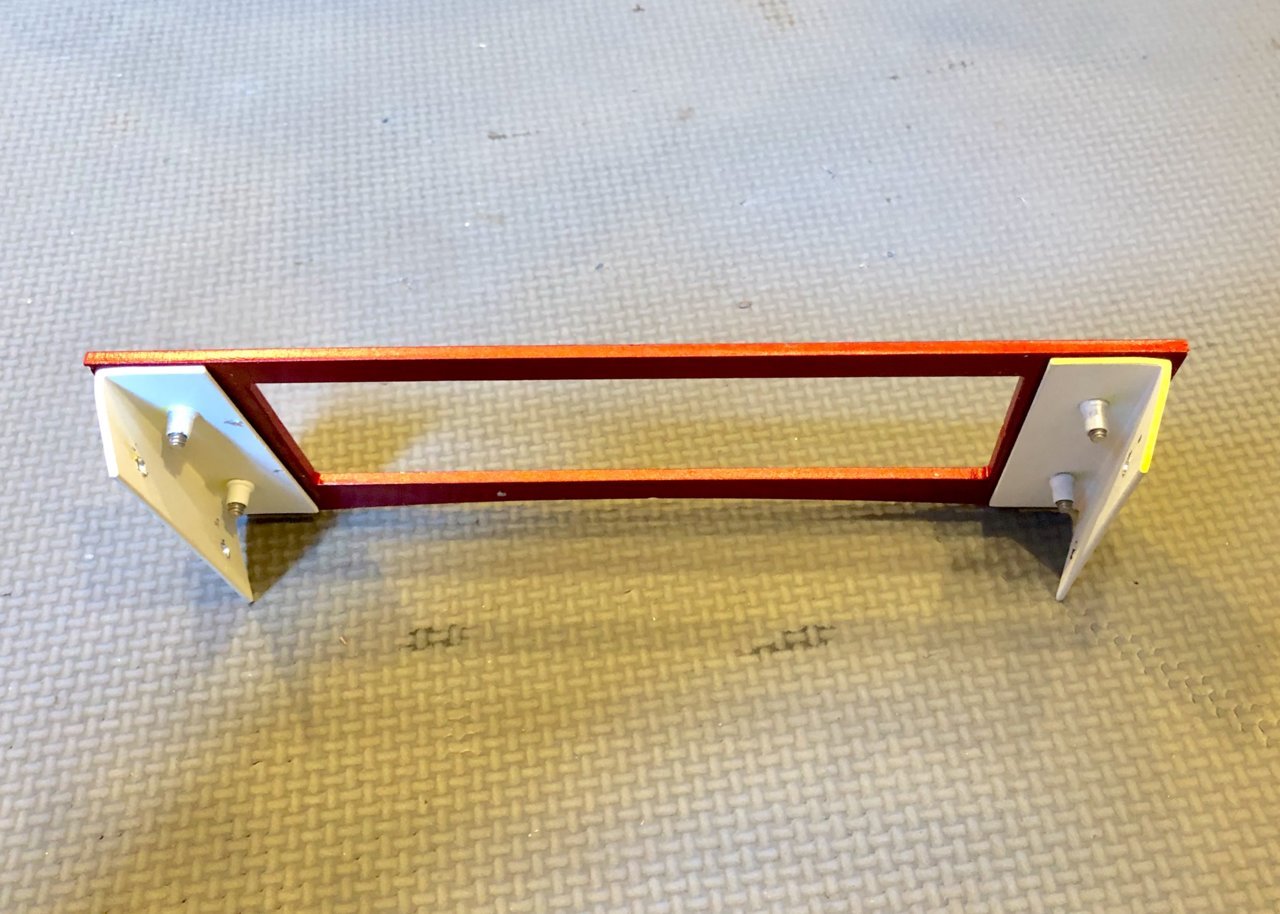

    Work in progress
    Couldn’t wait any longer so I made my own panel from 0.125 Al last weekend after several hours of trial and error with cardboard cutouts to get right shape. I wanted a hard mount so I used two pieces of 1X1X.063 angle extrusion I squeezed in a vice to get a tighter angle and also trimmed 1/8” off one leg to clear switch opening. I then added threaded pop-rivets to the angle pieces for the front panel to bolt into. Finally I matched drilled to the console and held in place with standard #6 screws. I Spent about a day and a half making this, so it’s a bargain if you can buy one from Iggy.
