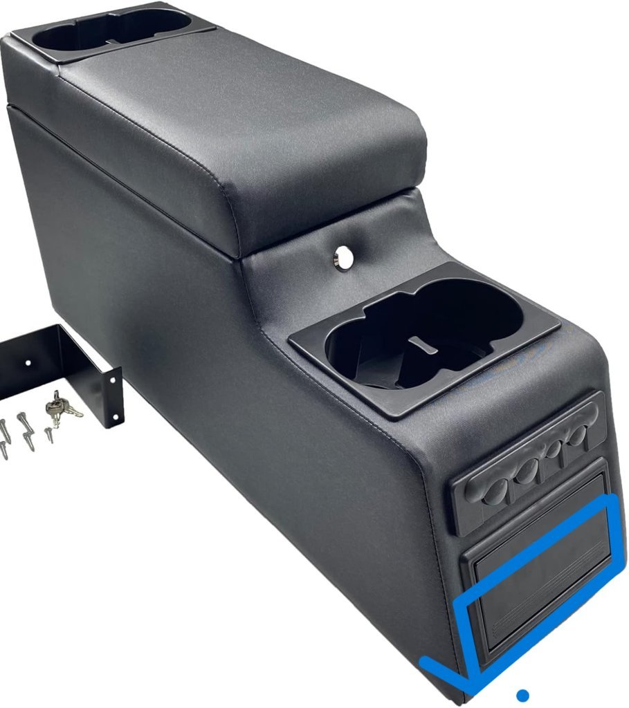

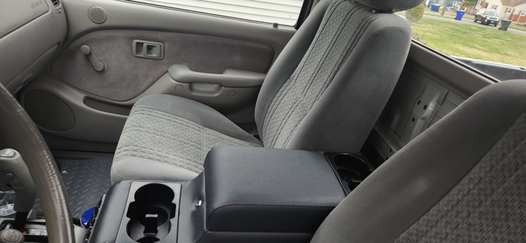

    Installed a center console made for a Jeep after a few cuts from my dremel oscillating saw and staple gun to put the fabric in place.

    Jun 5, 2023
    #426132
    54

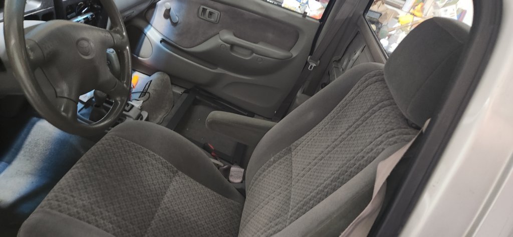

    Oh yeah had to take off the armrests on the seats that I put in from a Tundra for clearance for the lid and also taking out the original cup holder in the center.

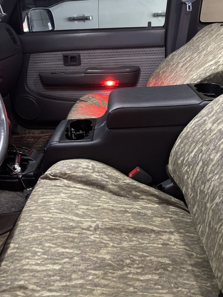

    I dont believe it. Looks photoshop :anonymous:
    do you have a better picture?

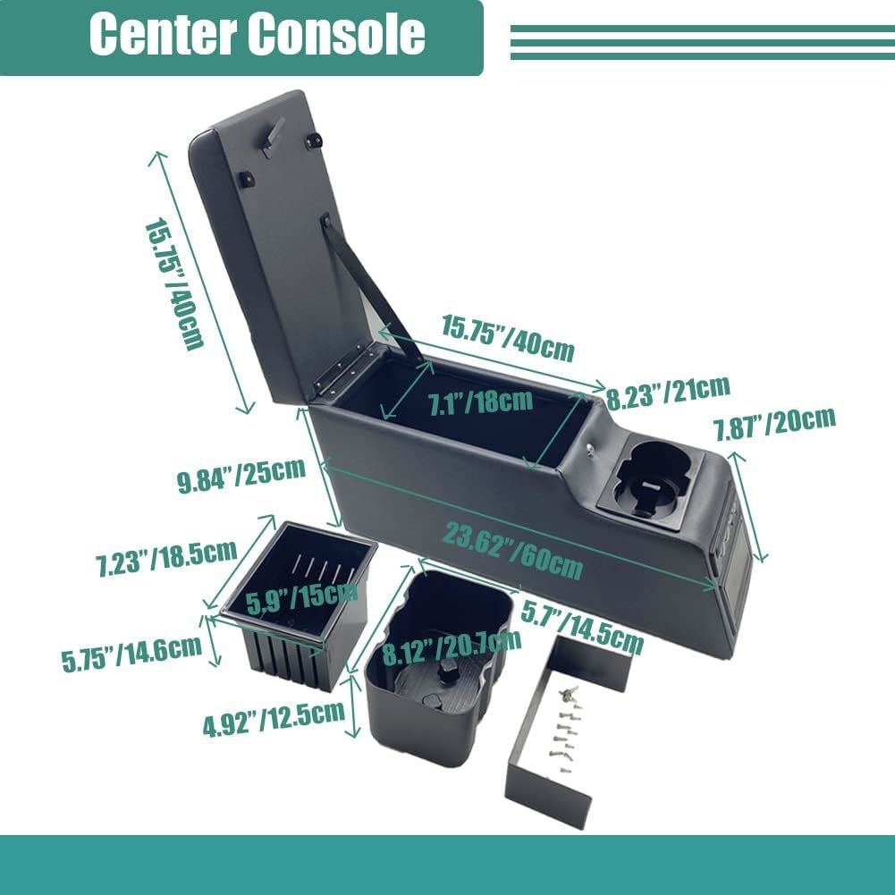

    Here are the specs

    I cut open the bottom half of where the sunglass holder is up halfway and about 3 inches of the bottom.

    if you have a extended cab or 4 door I wouldn't worry about cutting anything.
