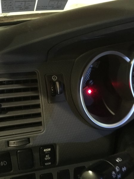

    Don't know why Toyota made it so hard for the 3rd gens.
    1st gen / 2nd gen:
    [​IMG] [​IMG]

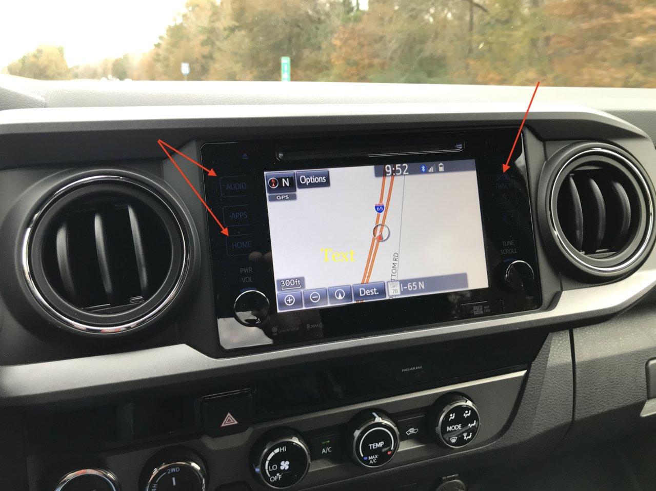

    Did you ever figure out how to make the lighting better on these buttons? I just purchase a new 2018 Tacoma TRD-OR 4x4 and this is driving me nuts. It is impossible to see these buttons on a sunny day without turning my headlight selector to DRL only (as this photo shows). Thanks for any help.
