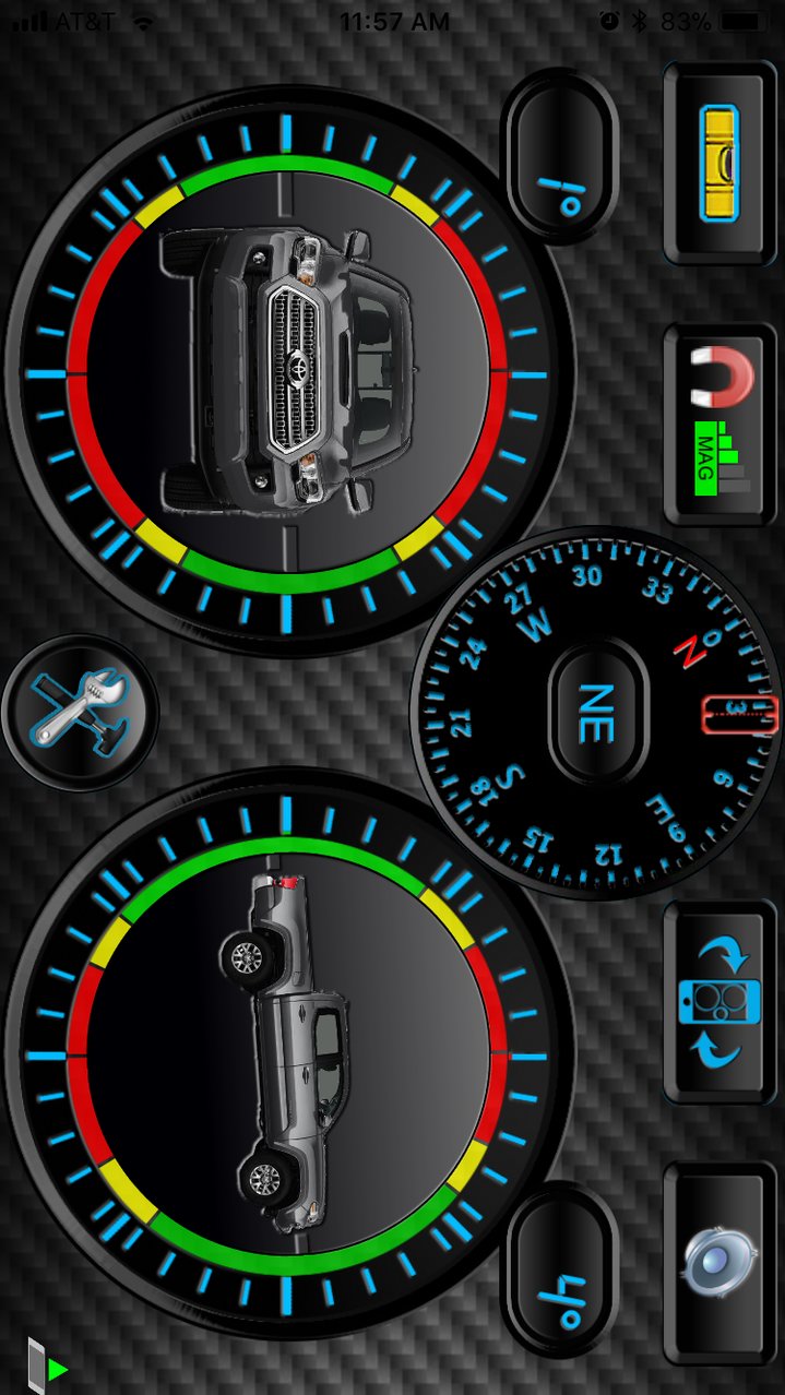

    My 2017 Sport does not have it,
    There fore I use my phone
    Useless compass, it goes crazy when driving, the degrees of inclination seems ok, can’t tell for sure.
    I would install the OEM if there was a way!

    You can always buy a cheap inclinometer and stick it on the dash somewhere.

    This an app??? Which app?
