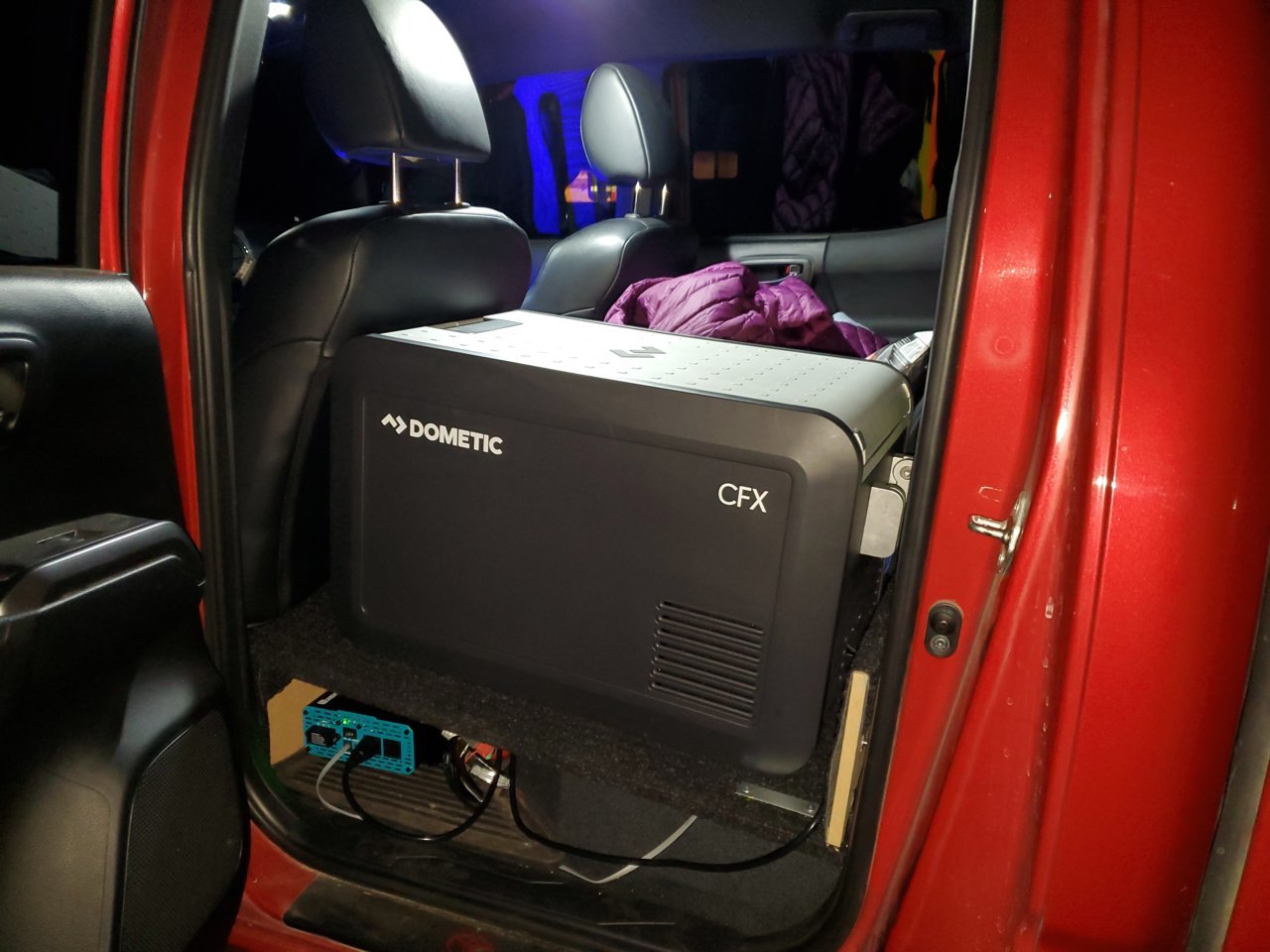

    My 1/3 rear seat delete. In the summer I put a Dometic CFX35 there. Works well for me. Still leaves enough space for 2 people in the back for short trips.20210430_183224.jpg

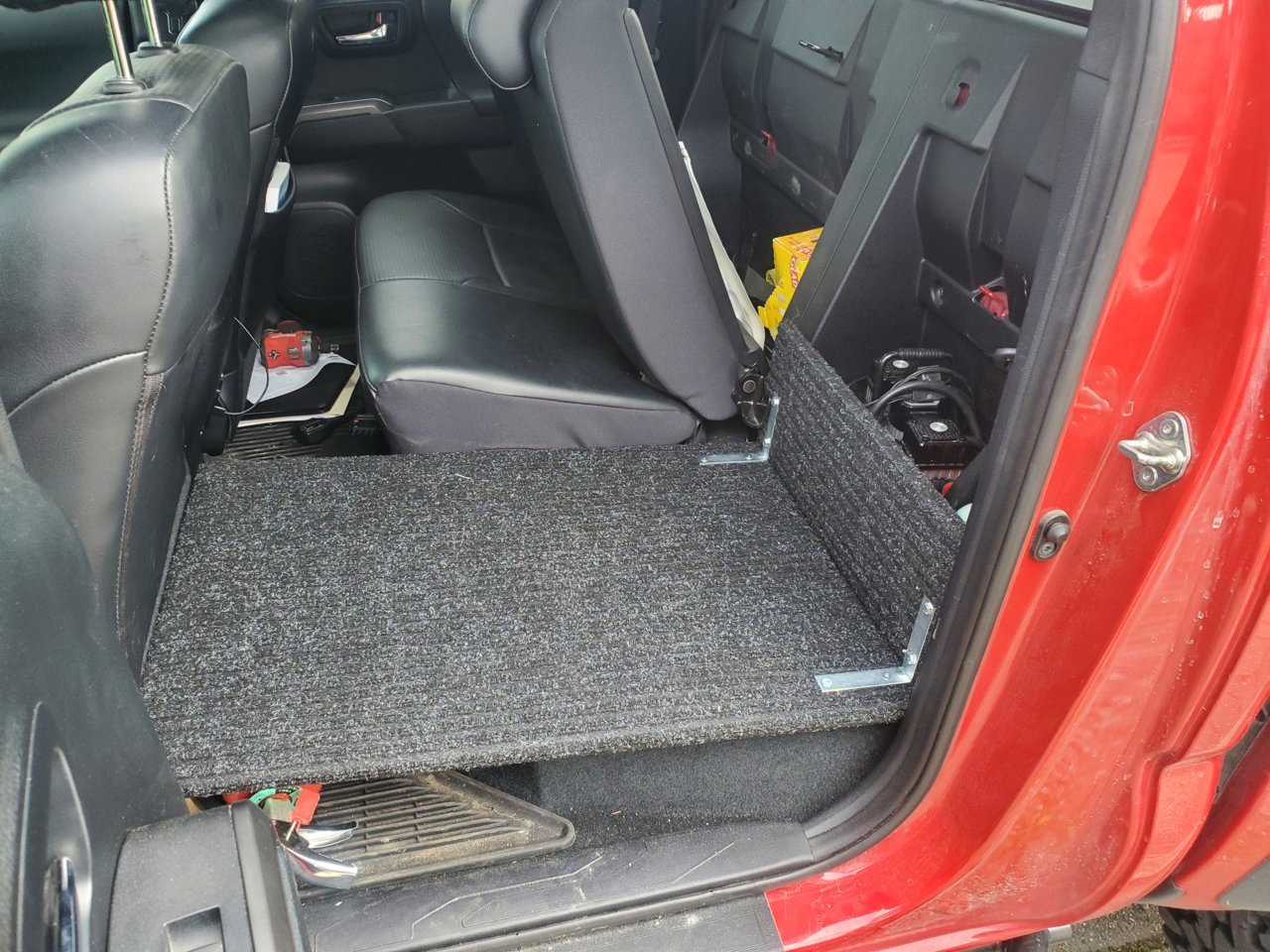

    Nothing in the rear seats. Couple bolts, that's it. No airbag or SOS's in the rear.
    I've taken out the rear 60 seat, to build a sleeping platform.
    that rear seat comes out easy.
    @BlackTruck15 you COULD rig up another 40 seat into the same spot, but it might not work that well. You have latches and bolt holes, you would have to drill more bolt holes, have backing threads (likely weld a nut in place). And fill the unused holes (this is easy, just put a bolt in there, that's what I did with my hardware when I have my sleeping platform in, bolts just go back in the holes, you can see it in the second picture above, bottom right that white patch is a seat mount or seatbelt mount something, removed it and put the bolt back in). In theory it could be done, but it's not a 5 minute project you can get on Amazon.
