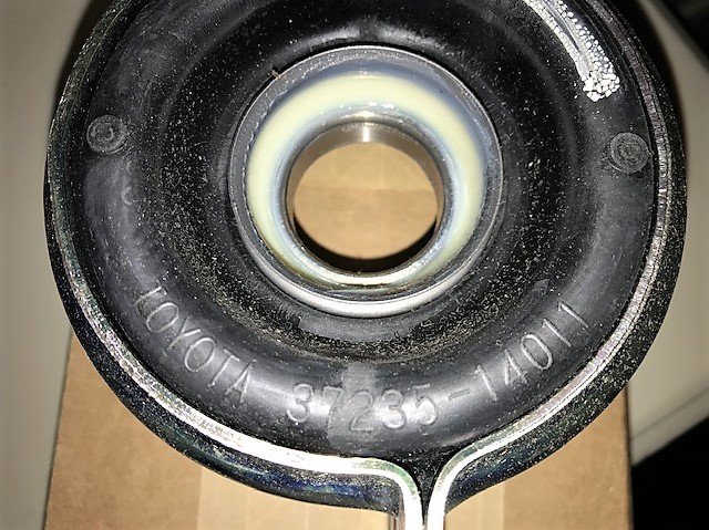

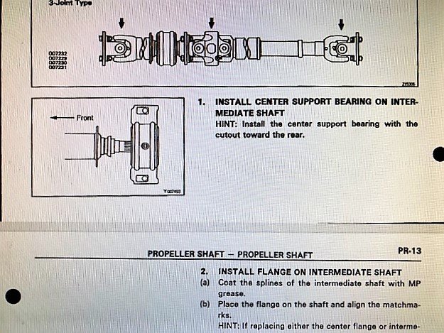

    I am doing a pretty extensive rebuild on my '97 V6 Taco 4WD 5 speed manual right now. Just bolted a Spicer 211750-1X Center Driveshaft Bearing in yesterday. The OEM Toyota center bearing part number 37230-35130 does interchange with Spicer part number 211750-1X (below). I do think the OEM Toyota 37230-35130 is a better center bearing than the Spicer; it has (2) more seals in it. But that OEM Toyota center bearing is much more expensive than this Spicer. The Spicer bearing is marked "TOYOTA 37235-14011" & was only $66.99 at Summit: Dana Spicer Drivetrain Products 211750-1X Spicer Drivetrain Products Driveshaft Center Support Bearings | Summit Racing. Amazon also has them. My old center bearing also had 1/2-3/4" play in it & the shop that put it on installed it backwards. Jeez! The new Spicer center bearing had zero play in it when installed. To keep a 25-year-old Taco up to speed especially for off-roading, you just have to look at/test everything important. New OEM LBJs are always a good start.
    "The Toyota Part number given of 37230-35130 does interchange to Dana/Spicer Center Bearing part number 211750-1x"
    By Mike Lamb MANUFACTURER on April 13, 2021
    Spicer 211750-1X center bearing is marked "TOYOTA 37235-14011":
    As per the FSM, the cutout in center bearing goes to the rear: install bearing, torque to 134ft./lbs., loosen the nut, retorque to 51ft./lbs., then stake the nut.

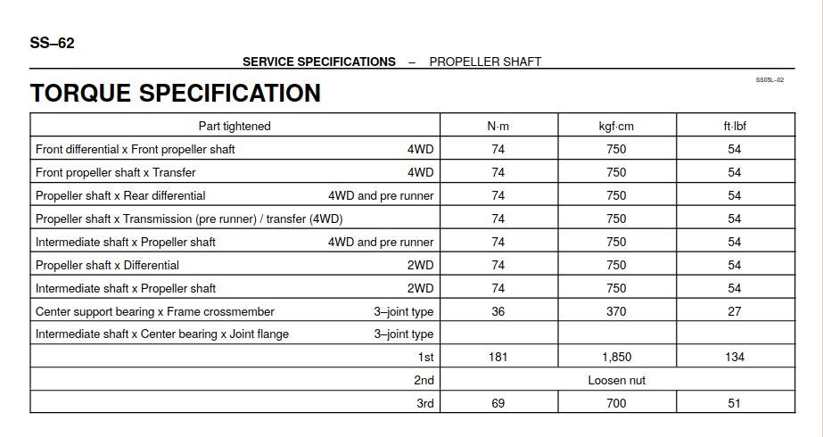

    Does anyone know what section this is under in the FSM? I have a printed out copy but it has no glossary or reference section. Seem to remember the torque specs being realllly weird for this job.

    Here's a screenshot.

    Ok thats it....thanks man! I knew it was some weird torque loosen then torque again. Gotta love these 100+ pounds of torque then hey loosen it up jobs lol. I sure hope my old ass snap on torque wrench is still calibrated right.

    The orientation of the center bearing and the torque sequence can be confusing. The old center bearing on my '97 Taco was installed by a full-time auto repair shop that had been operating for decades. And it was on BACKWARDS! That is the reason I posted the proper orientation and torque sequence above. Make double sure the notch on your pricey new OEM Toyota center bearing is to the rear before you seat it to 134ft./lbs. Once you seat that bearing, it may take a puller to get it back off.
