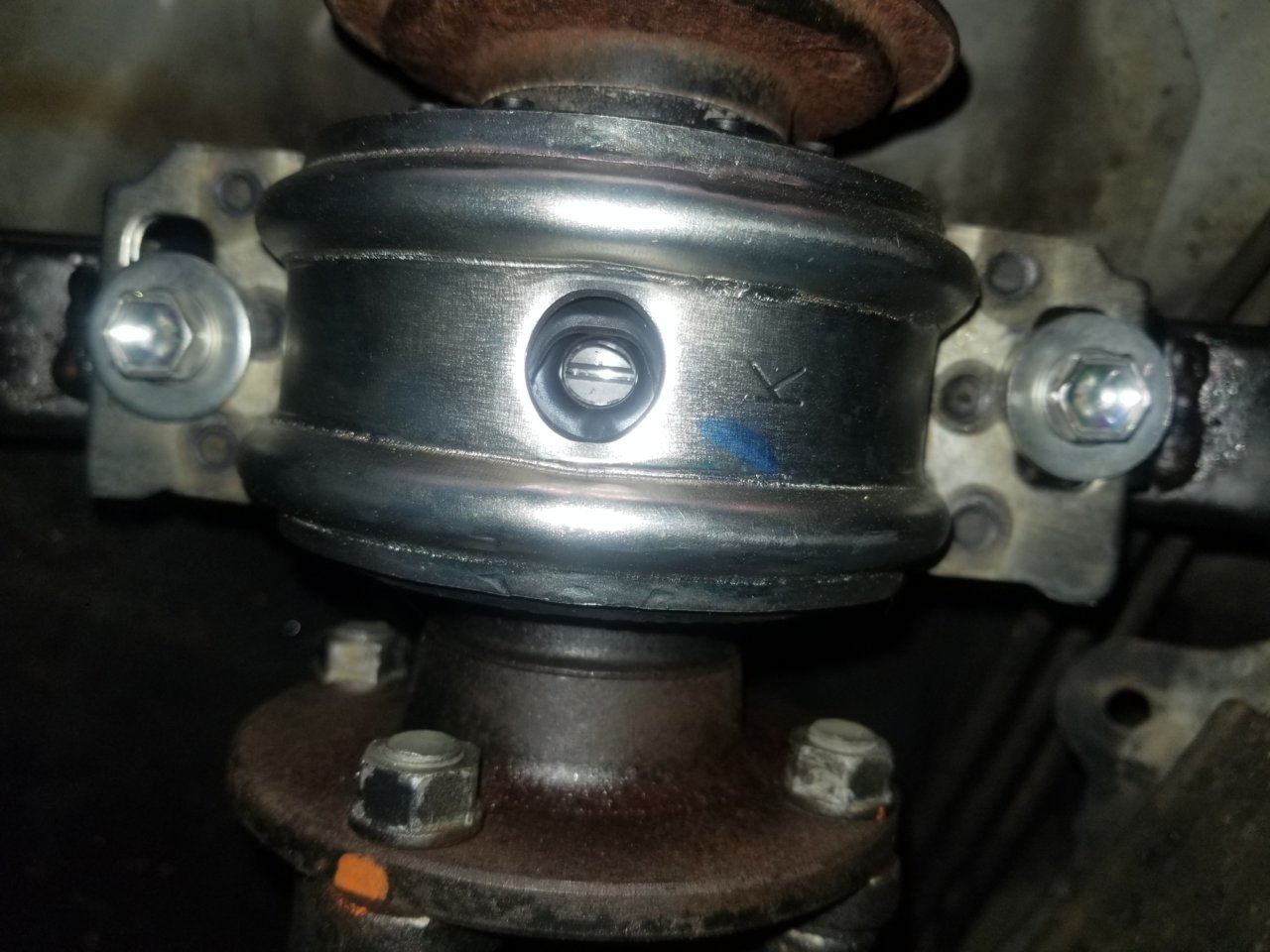

    Ok so got the bearing on an when I tightened it this is how it looks. Should I try an straighten it more? If you look where the bolts are you can see its not straignt.20220901_134038.jpg

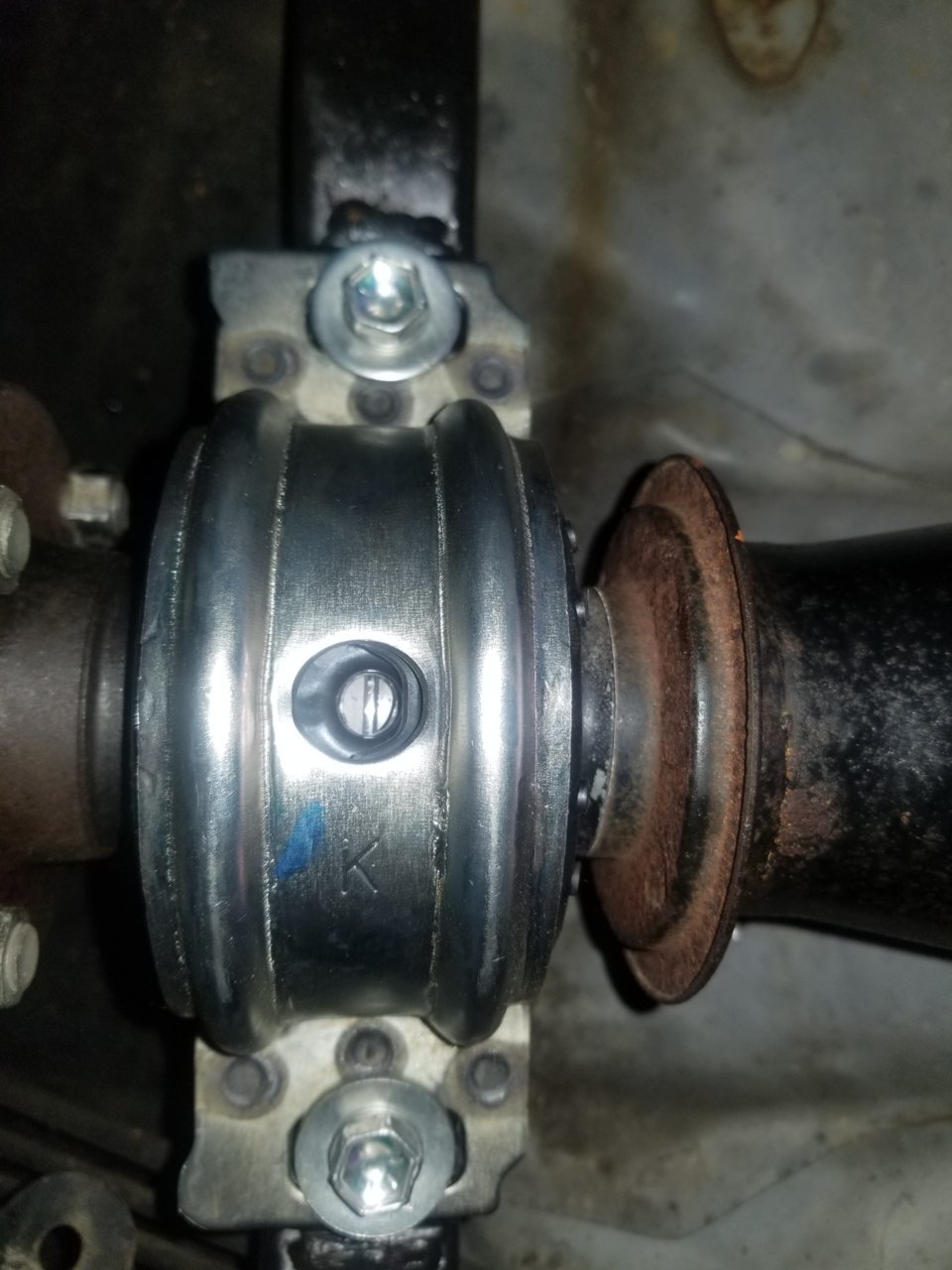

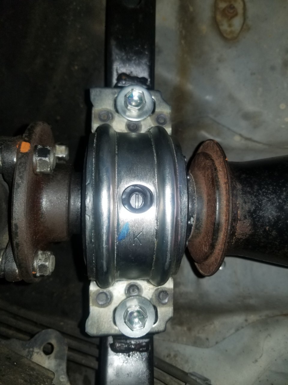

    That looks straight enough. Road test it and see how it feels.

    Feels solid havent had it on interstate yet but at 55 it felt good and that knocking noise is gone

    I wouldn't worry about how the bolts look... I'd be checking that the bearing is 90 degrees to the drive shaft.

    I would have let the mount find its natural position. Remember, the actual bearing is in alignment. The hunk of rubber it is pressed into is just sitting in the mount a little cock-eyed (can I say that now?). By twisting the mount to get even spacing in the holes "preloads" the assembly. It's reminds me of people who install and tighten upper control arm bushings with the suspension hanging. But in any case, your installation may last 9 years instead of 10. Did you stake the nut after the final tightening?

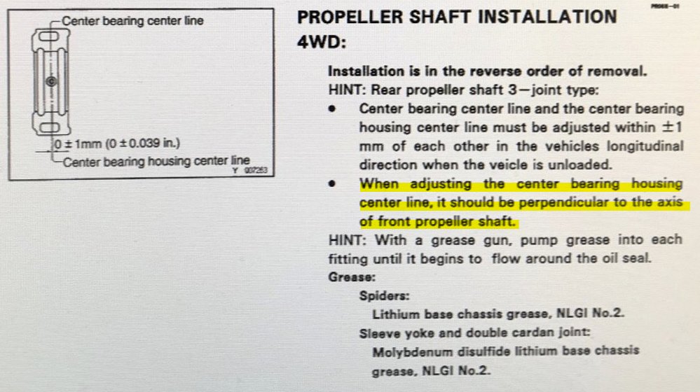

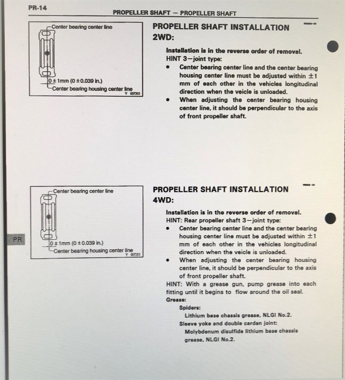

    The FSM instructions on this installation are below: 0 +/- 1mm (0 +/- 0.039")

    If the actual bearing is pressed all the way on the machined end of the intermediate shaft, then it has no choice but to be perpendicular, so you should be good. The OEM bearing is closer to having the mount perpendicular than the aftermarket bearings, therefore the FSM instructions are to make the mount perpendicular. Again, perfection is not required here. And frankly, I have never torqued that stamped steel nut to 160lb ft. That number is just to insure the bearing is pressed all the way on the shaft. When I am certain the bearing is pressed on all the way I back off the nut then go for the ~50 lb ft. Stake the nut and you're all set. Cheers
