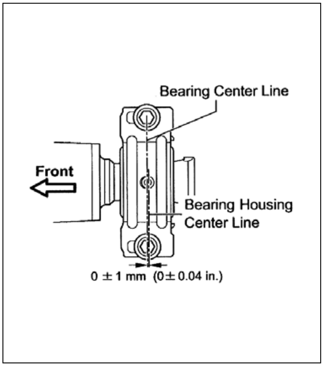

    I had to temporarily disconnect the Center Support Bearing in order to POR15 the frame crossmember. Are there any tips or gotchas for properly aligning it?
    This is all the frame replacement manual has...

    The driveshaft should do all the talking. Make the center straight with the shafts
