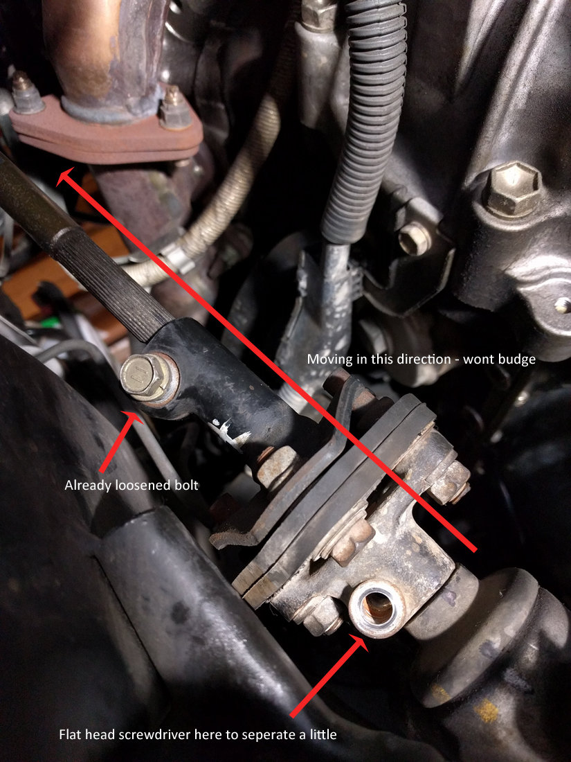

    So another update, juggling my free time and since I have a backup vehicle this job is dragging on o_O
    Anyway, inner tie rods have been replaced.
    Using what you all have suggested here as well as referencing this thread
    https://www.tacomaworld.com/threads...er-rack-alignment.452922/page-2#post-13311670
    Having a little trouble here:
    https://www.tacomaworld.com/threads...er-rack-alignment.452922/page-2#post-13348233
    Damn thing just doesn't want to budge. Suggestions? Thanks again - know I am really close to wrapping this up.

  13. Apr 10, 2018 at 2:21 PM
    #33
    Texoma
    Texoma IG: Triple C Chop Shop
    Feb 1, 2011
    #50374
    18,960
    Chris(Topher)
    Lago Vista, TX
    10 Taco 4x4
    A bunch a cool stickers, a bada ass MetalMiller Tx Longhorns grill emblem painted Hemi Orange, JBA long tube headers with o2 sims, Diff breather mod, Red LED interior lights, Fancy head unit that plays ipod n movies, Also DIY install factory stuff like, factory cruise control, factory intermittent wipers, OME nitro struts with 886x springs and toy tec top plate, JBA high caster UCA's for better alignmnet and dey beefier too, Old Man Emu Dakar leaf springs in da rear with the gear, U bolt flipper, Ivan Stewart TRD rims with 33" K Bro 2's, some bad ass weather tech floor liners so I don't muck up my interior, an ATO shackle flipper for mo travel in da rear wit the gear, also super shiny Fox 2.0 shocks back there too, all sorts of steal armor for bouncing off of the rocks like demello sliders, AP front skid, trans skid, n transfer skid, demello gas tank skid, and a tough as nails ARB bumper with warn 8k winch, I'm sure there's more
    Make match Mark and un bolt

    Update -
    Ended up confirming rack was definitely off by a full turn. Not sure when or how that occurred but now that its sorted, I have equalized the outer ties and wheels are really close. Left is still inward just a little but ran out of time today so wont be able to adjust until tomorrow. Once I've made my adjustments, I'll head in for an alignment. Will end up using a different shop or maybe just say screw it and pay the stealership to do the alignment. Still deciding. Once aligned, I'll update again with results.
