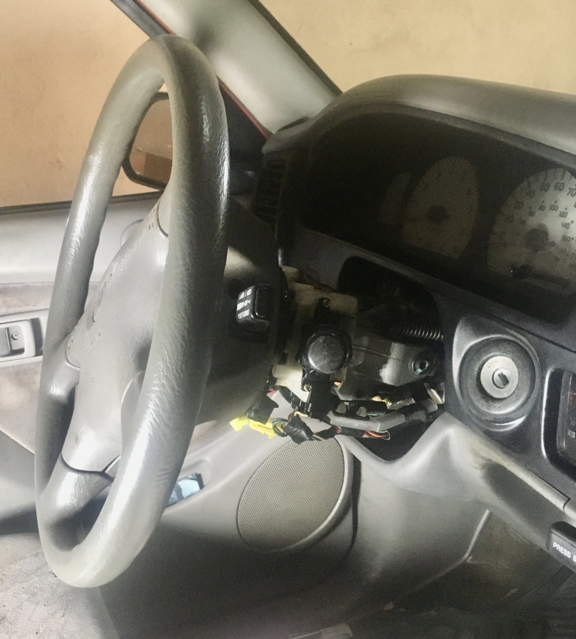

    Even I know the title is confusing. Just seems no matter how I worded it in a search, both parts are called steering wheel.
    I decided, since I had the wheel & column pulled, plus replacing the rack, I would straighten out the column, which somehow, someway ended up askewed left.
    I now need to straighten the top part of wheel to meet the bottom. I have directions in my Haynes. I have the wheels straight. Battery disconnected. However I am finding the torx screws hard to turn, so backed off to make sure the Haynes was covering everything. Maybe the screws are simply tighter than I thought they would be.
    The steering wheel is locked because the manual did not state to unlock it after disconnecting the battery.
    As an aside, I did center the rack.
    Am I missing some step or is it I just need to give the screws a little extra :muscleflexing:

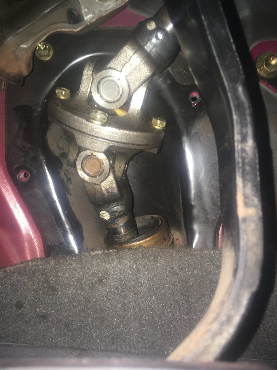

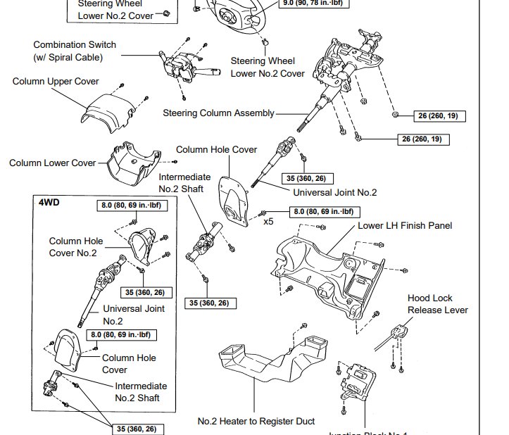

    Are you trying to center the steering shaft in the hole that passes through the firewall? Or get the wheel straight? If the latter, it's accomplished using the tie rod adjustors during an alignment. If the former, there are a series of slip joints in the steering shaft that need to be all simultaneously adjusted to get the steering shaft to be centered in that hole.
    There's one at the top of intermediate No2 shaft (at the steering rack) that needs a bolt loosened to adjust.
    There's one at the bottom of universal joint 2 that's free to slide
    There's one in the steering column assembly that I believe is free to slide
    When I had a non-centered steering shaft, I had the best luck by loosening the column at intermediate no2 shaft, the adjusting the top slip joint while simultaneously doing the one in the steering column assembly. Then tightening everything backup centered.

    The no 2 is so not coming out at the pinch bolt. Good idea though.

    As far as I could tell an alignment would not have fixed this whilst keeping the column where I had set it. I needed up pulling the steering wheel & got it pretty darned well lined up with the column. In fact when I drove to the alignment shop, i was pretty much dead on. Anyway, to answer my question, I was not missing anything. I just needed to put some more :muscleflexing: into the torx screws.
