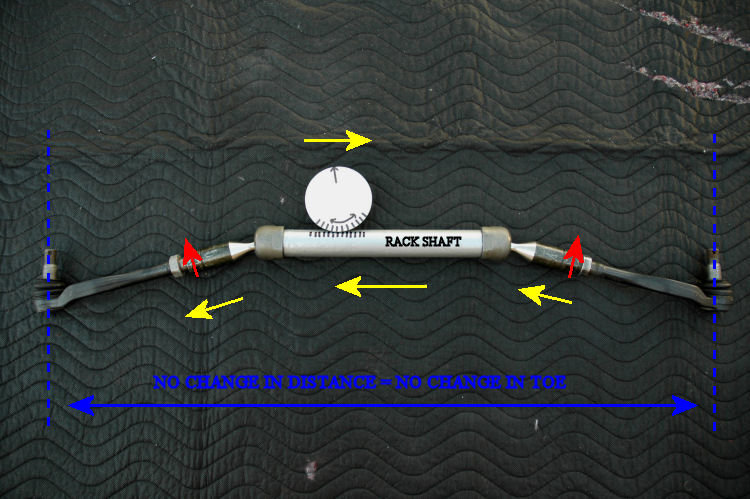

    From post #59 here https://www.tacomaworld.com/threads/how-to-do-an-alignment-at-home.252256/
    "On a 1st gen 4wd Tacoma, once alignment is complete, if the steering wheel is slightly off, it can be brought to center by turning both inner tie-rods in the same direction (red arrows) by the exact same amount (one direction or the other, looking at the rack from the rear). If one is turned a different amount than the other, Toe will change."
    I use the "flats" on the ITR as index marks to judge just how much each has been turned. One sixth of a turn makes a perceptible change in steering wheel position. "One spline off" on the steering rack splines makes a pretty big change, 10.3 degrees to be exact.

    thanks DP, that's a great description on how to do it the right way so you don't mess up the alignment.
    I had always been afraid to get the rack alignment off centered if I did anything other then turn the tie rods but that moves the wheel a lot so slight adjustments weren't possible with that method
    my only question is the point of view im seeing, are we looking at the front of the rack in this picture or from the back of the rack in that picture?

    That's like holding lug nut with a wrench and rotating the car. Toe adjustment is intended to be done by turning the ITR.
    As long as they are both turned the same there is no change in Toe. It's that simple.
    I made up that "pictogram" with Taco inner/outer tie rods and the steering wheel on the left side to be as easy to read as possible. It's looking forward at the rear of the rack.
    keakar[QUOTED] likes this.

    thanks, I always like to ask about the point of viewing angle because you just never know how a person is drawing it
