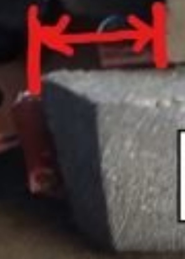

    Look at the photoshopped arrow on the right, the shoes frame can be seen. The very edge of the corner of the shoe has no support by the frame. No f_______ way that would create any kind of a problem.

    There's absolutely nothing wrong with that design. If you think there is then you should provide some factual evidence as to why it's inferior, otherwise it's just opinion.

    I highly doubt the shoes were designed like that. I'm pretty confident it was a quality slip at the factory. It's not so much the position of the brake lining as much as the negligence on Centric's part for not catching it in the first place. The lining is so far off that it makes me wonder if the lining is even properly bonded onto the shoe frame. Maybe the lining wasn't properly bonded to the shoe frame to cause it to move during manufacturing? Maybe the fixture that holds the shoe frame during manufacturing wasn't locked in place which allowed the lining to move? Maybe the Chinese kid fell asleep while clamping down the lining against the shoe frame while the "glue" was drying? Every answer to those questions leads me to believe the bond between the shoe lining and the frame may have been compromised which may have allowed the lining to shift. I mean I don't know, but I sure as hell wasn't gonna find out while towing a 5000 lb trailer down a hill.

    Real lesson learned: inspect the parts before installation. ;) This goes for both OE and aftermarket parts. This time it was a mfg defect. Next time it could be wrong part in the box, shenanigans by a previous customer, shipping damage, etc., etc.
    This. Best to return the part for replacement. I've used Centric shoes (exact same P/N as @Tah-koh-mah's) in my previous truck for 2 years with no complaints. Centric is StopTech and has access to OE design data. This was clearly a mfg defect.

    Nothing but guesses with no factual basis and you decided to trash a company name on the internet with absolutely not one fact. Whatever, have a ball.

    Nope, no guesses at all, the pictures I took clearly show an obvious flaw in the brake shoe lining being shifted too far to one side. That's a fact. No denying it. Here's another fact , during the manufacturing process something went wrong that caused the lining to shift. That "something" that went wrong is what makes the shoe unsafe to use.

    Absolutely not true. Just because the lining isn't located in the stock position doesn't mean it's a shit part, it only means that it's different. You also have absolutely no evidence the lining shifted. You have no clue of what you're writing about other than you wanted a part that was exactly like stock but cheaper. You're guessing in other words.
