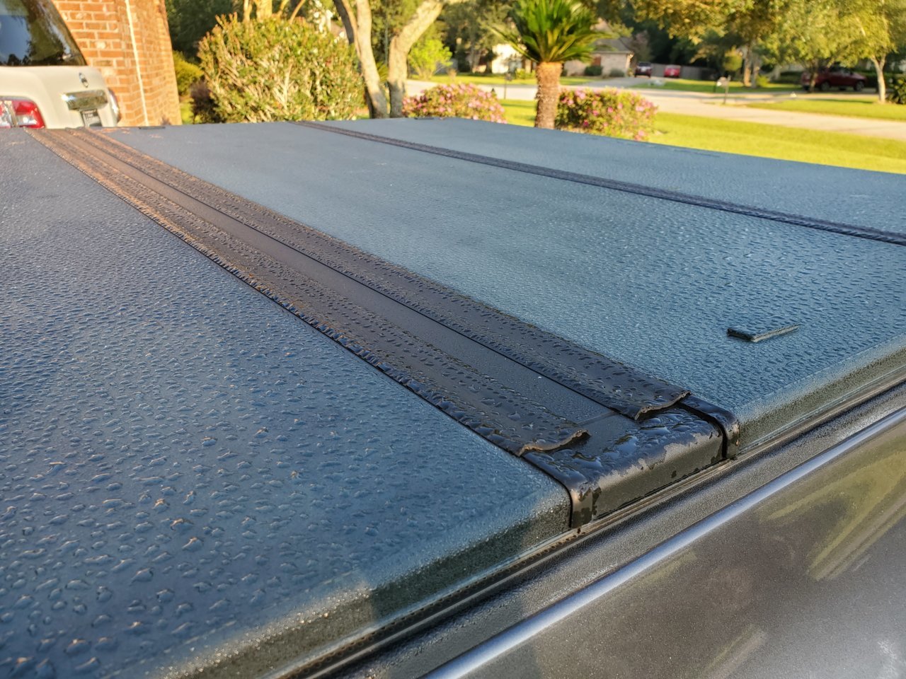

    I recently bought this Cerakote Trim Coat to use on the OEM tonneau cover on my 2017. The instructions say to wipe off any of the product that gets on painted surfaces or glass.
    I haven't been able to find any info about vinyl or rubber surfaces with regard to Cerakote. My concern is the rubber/vinyl parts where the hinges are located.

    It turned out pretty good, not perfect, but much better than it looked before the application. I used 7 out of the pack of 10 wipes. I wiped over the rubber part of the hinges as well, but I don't think that helped (or hurt) anything. In one place on the hard plastic part of the hinge part (between the rubbers) I have some peeling/chipping of the CeraKote. Maybe I didn't get that part clean enough I dunno. The applicator pads leave some white fuzz on the tonneau after the application, but that can be brushed off after a day or so. It takes a fair amount of rubbing/wiping to get the somewhat rough finish of the tonneau to look smooth and even during application. Water beads and sits on top of the finish to this day . . .
