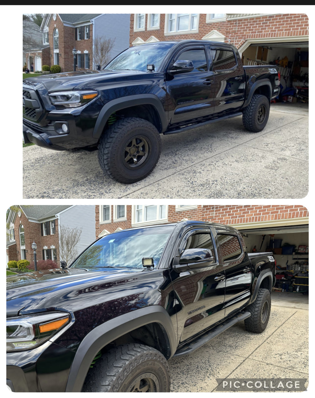

    Both Adams, top is the spray ceramic and bottom is the advanced graphene ceramic coating. The top was not polished or buffed before the spray.
