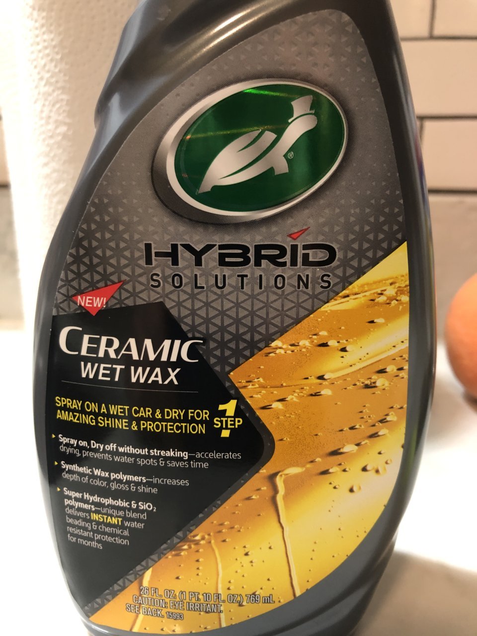

    Picked this up at Walmart today for $3.25 . Any good :notsure:

    If it doesn’t come in a glass bottle it isn’t a ceramic coating

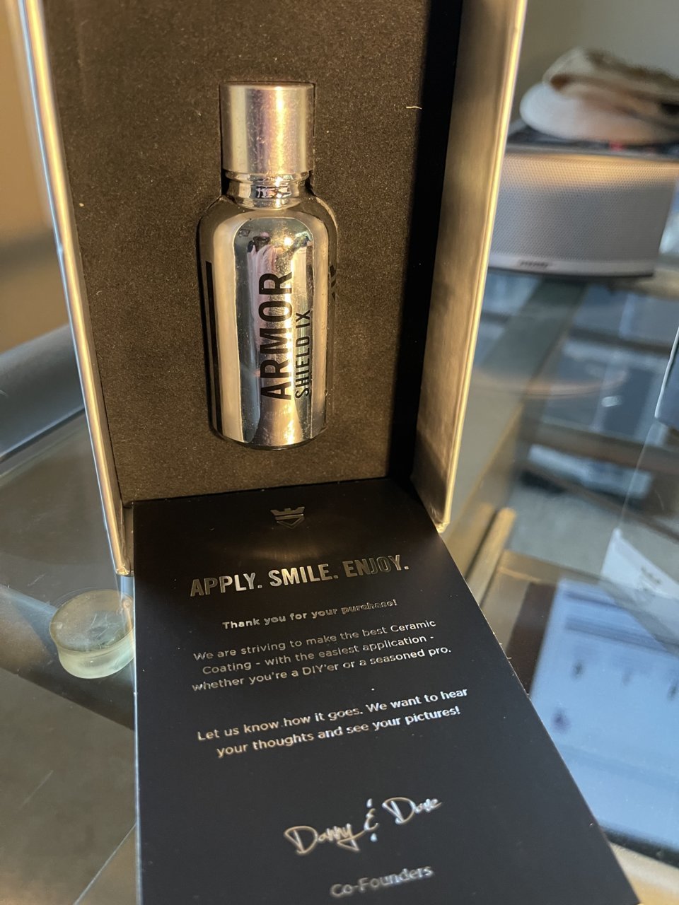

    I used Armor Shield IX two years ago. I did a clay bar treatment (40 minutes), wiped it down with isopropyl alcohol (10 minutes), and did two passes (40 minutes each) to ensure full coverage. The treatment only sticks to the paint, so the second pass was probably not necessary. I am 2 years and 3 months in, and the treatment is still hydrophobic. My vehicle is garage kept, but it is a daily driver, washed weekly. Treatment cost $69 per bottle. You will need a clay bar kit and a fresh package of quality microfiber towels (you will toss these when you are done). One bottle was good for almost two full passes. The most difficult thing about this process is paint correction if needed. I didn't need any correction, which is why mine was so easy.

    I did the same process. Seems to hold up well so far
