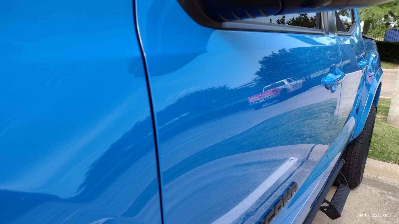

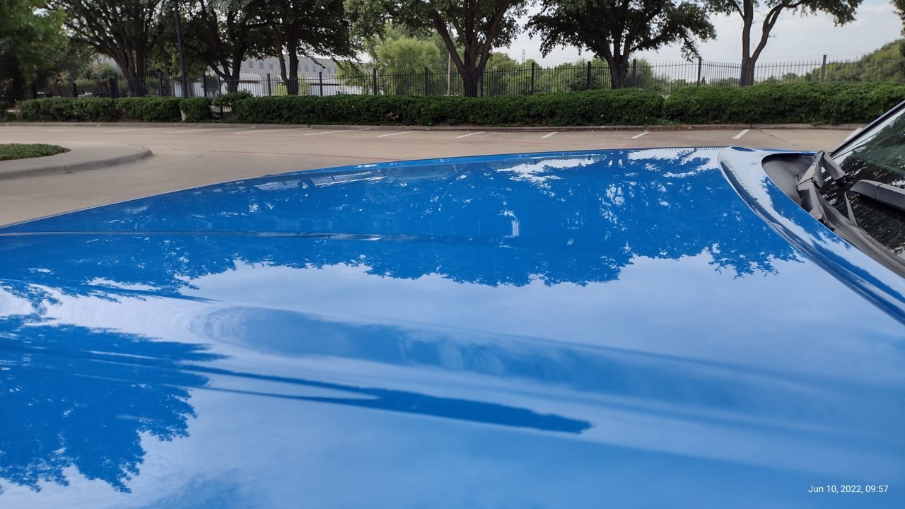

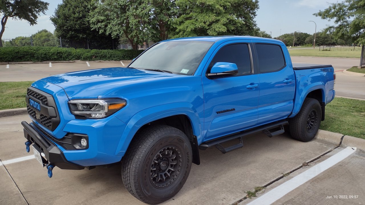

    I just took these pictures. I had the truck washed on Tuesday. It was a drive thru place, but it uses the high powered air to blow it dry.
    Since then it has been driven to work several times (36 miles round trip each time). It has been subjected to: Road Grime. Dust. Dirt, Pollen, Ragweed. Grass clippings. Mountain Cedar and whatever else mother nature has thrown at it.
    It's over cast right now in my area, but I hope these pictures can help you make a better informed decision.
    Full truck:
    Upclose drivers side door:
    Upclose hood:

    That is interesting… My current vehicles I’ve owned for 11 and 12 years respectively, but don’t have an exact plan for the truck. I will say I see a whole lot of faded paint on cars here in Arizona. The UV is intense here. And I don’t want my truck, which is red, to end up like those - whether that’s because I’m keeping it long-term or because I’m protecting its resale value. I spent first 30 years of my life in central Florida and don’t feel like I noticed that as much there as I do here in the desert. But I hear what you’re saying about how manufacturers are approaching their paint. I don’t have any salesperson trying to sell me anything (not yet anyway Lol), just researching options of how I might protect this new investment. Appreciate your input.
