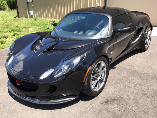

    I think its worth it. I had my lotus coated with nanohide and couldn't be happier. Bugs and dirt can literally be hosed off with water. Which is honestly one of the biggest reasons I went for it- easy clean ups. Im not a professional detailer so it was worth it to me. I chose not to treat my Tacoma since its my daily driver and monthly coat of wax is ok for me.
    This is right after paint correction and nanohide application. A year later, it still looks the same.
