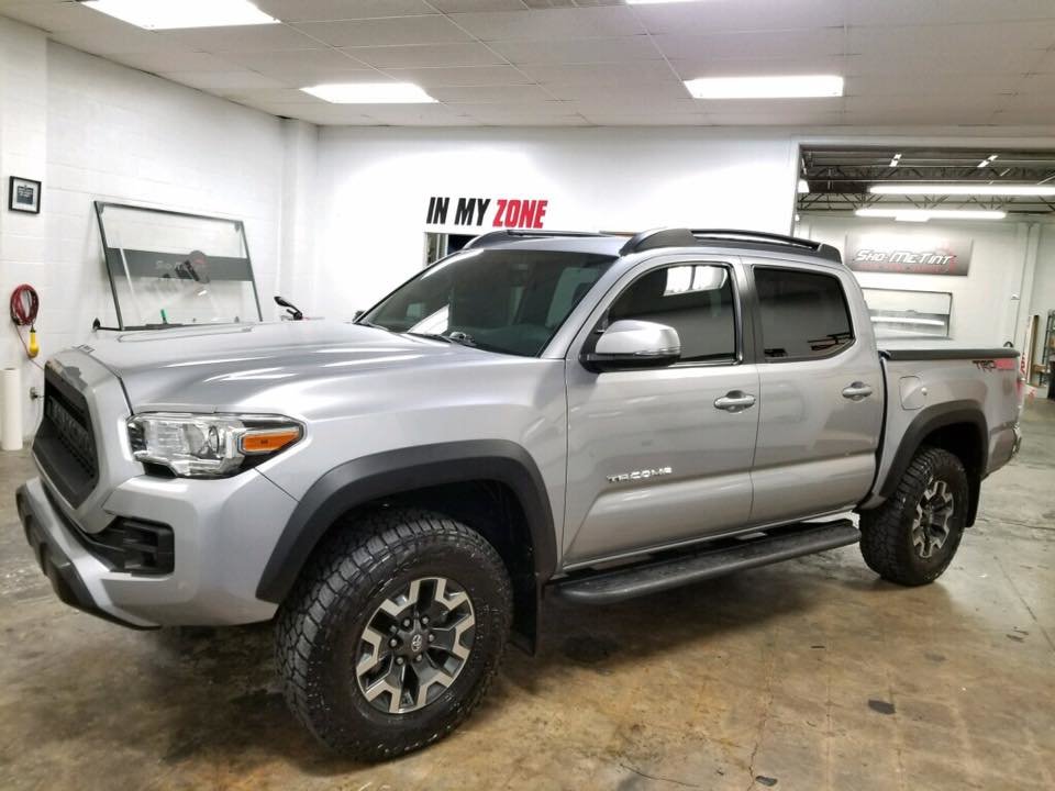

    Well, idk about the others but.. I am getting mine done through the applicator at Toyota in Alhambra. I am paying the dealer directly. I’m sure with the warranty card they are offering me and the receipt... they should be good for it?

    Does that price include paint correction? And which package is that? How long did they say they would need your car? I’m in your area and went through Aerowerkz. They did an awesome job on my truck about two months ago
