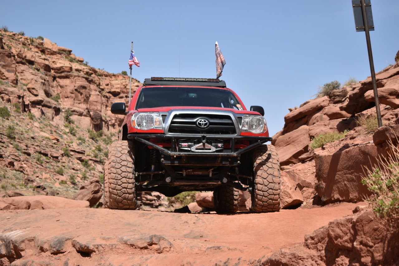

    Later in april I attended Best Of The West with warfab in montrose colorado, made a detour in moab to run Pritchett again and Top Of The World.

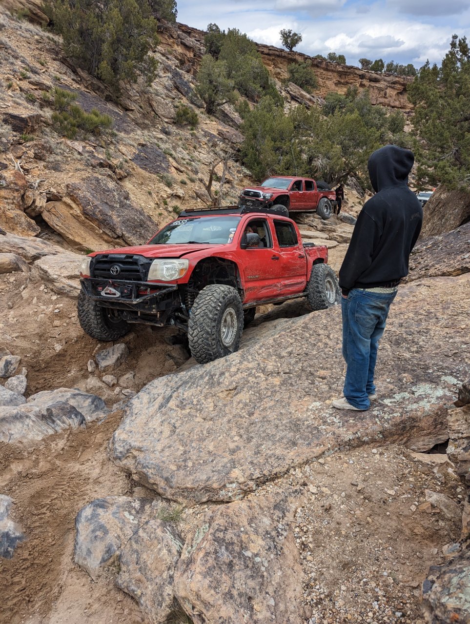

    After that i made another trip to sand hallow and ran Double Sammy, Milts Mile, and Johns Trail.

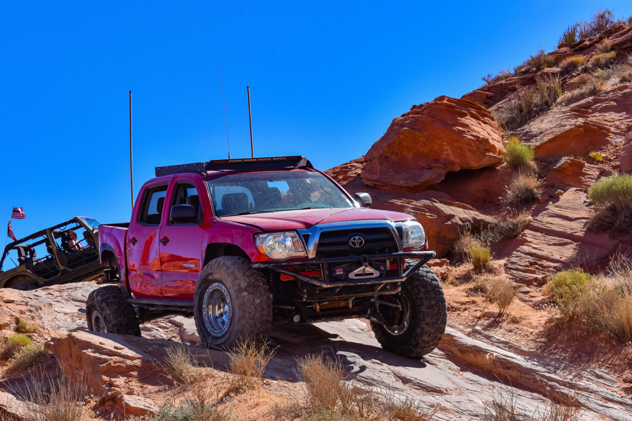

    Finally it was time for some upgrades, ive had some serious axle wrap issues since I switched to a shackle flip. So i installed a ruff stuff anti wrap bar, boxed the frame a bit more.
    Then i found a great deal on some used bfg krawler reds 39x13.5.
    Hopefully the truck does well with the larger tires, but i have a feeling i might be using my spare diffs soon

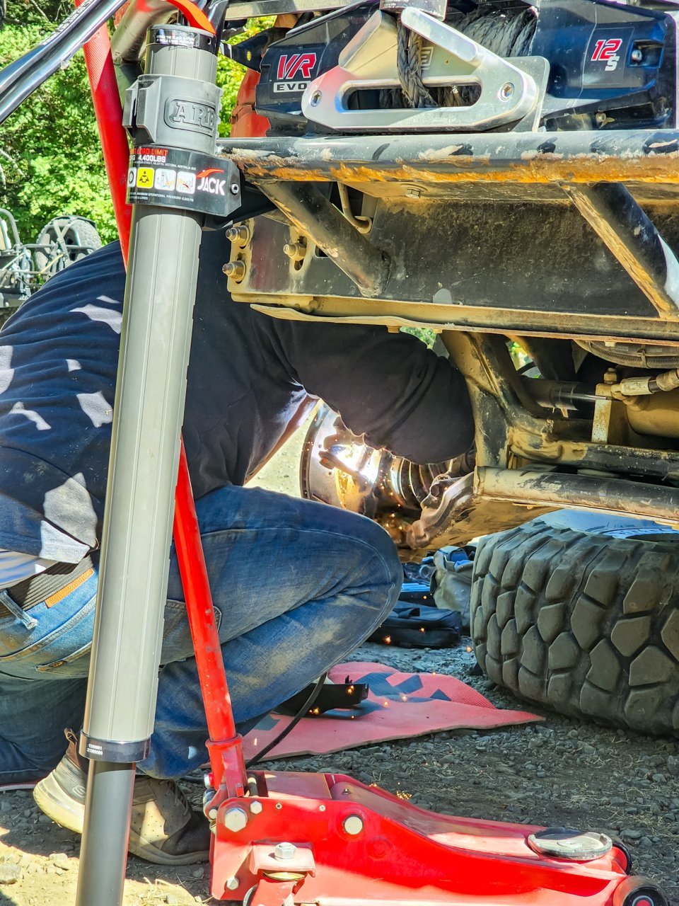

    Day 1started with me welding my double sheer that had cracked. Then we went and hit a trail where i broke my rear diff after the trans started slipping and i did a couple 4k rpm nuetral drops. Probably not the smartest idea of the weekend, but also not the dumbest.
    Luckily i brought my spare stock diffs. But the front was Open so we decided to weld it. Didnt take long to swap both front and rear diffs.

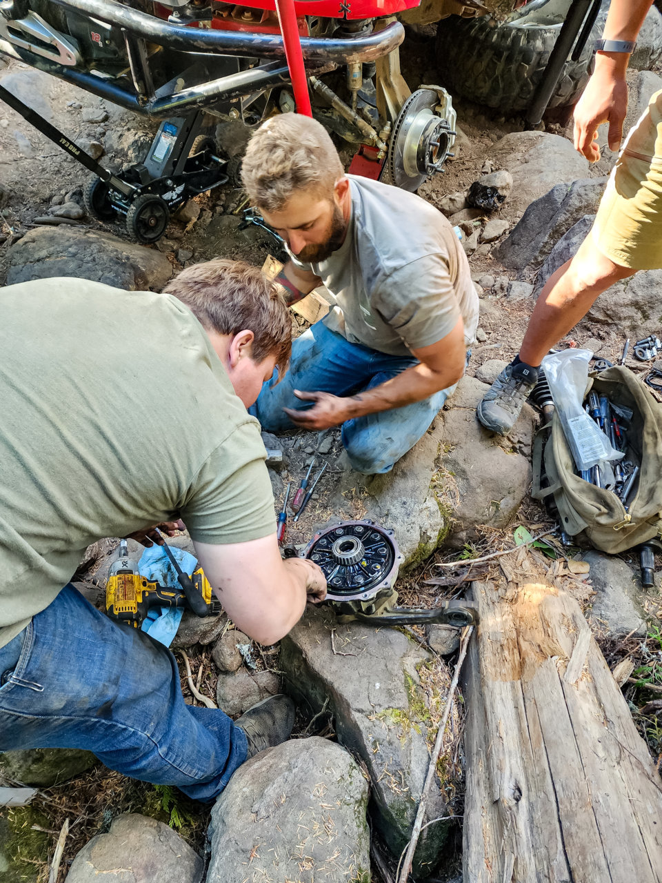

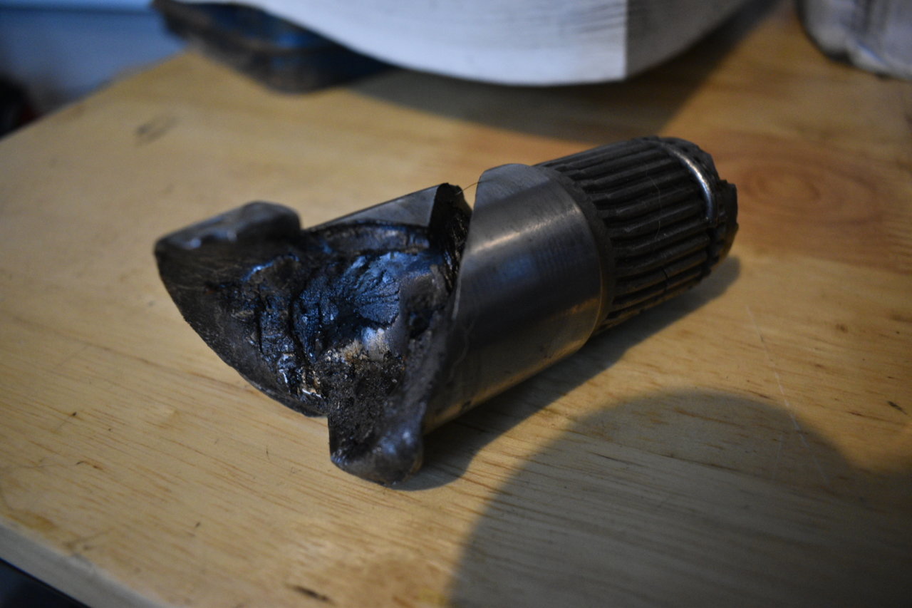

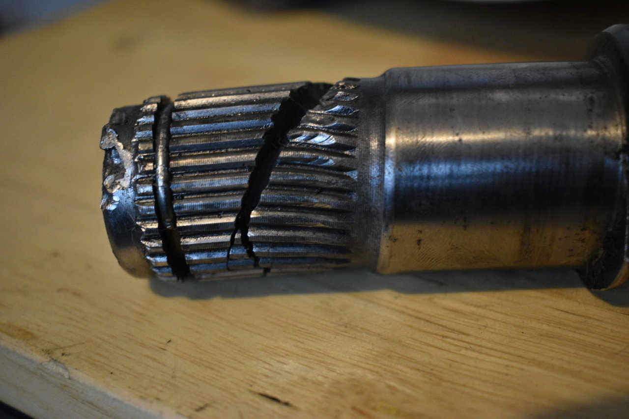

    Day 2 was an interesting day, got about half way through the trail and broke a cv axle while a buddy was driving. Ended up pulling the front diff out on the trail, stripping it down and taking the ring gear off and center pin out to get the stub shaft out that broke inside the diff. At the same time i think i broke the rear diff mount. Ended up putting a hole in the upper oil pan from the diff hitting it.

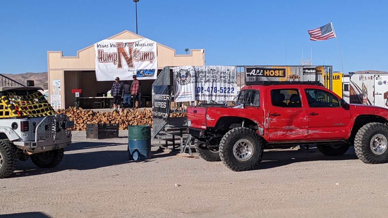

    Couple weeks later i went to rock therapy oct 2022 unfortunately i dont have any great pictures from this trip. But we did hells revenge twice, pritchett canyon and coyote canyon. Coyote kicked our butts and we only did half the trail before turning around. Broke my rear driveshaft on devils hot tub, broke a cv getting off the trail and then broke a winch line on coyote.
    Next i attended hump and bump early novemeber 2022, its a local event down here for las vegas. I volunteered to help lead some trails. Everything went well until the last day where i was chasing some SXS and hit a huge ditch i didnt see and that broke my shock.

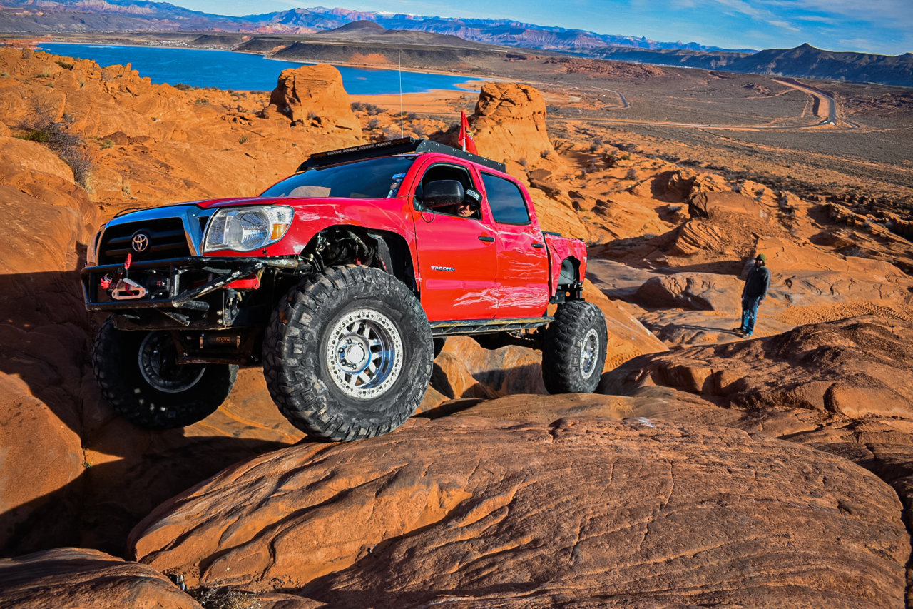

    Next month, december 2022, i went to sand hallow with a couple friends and ran a couple trails and tried a couple lines i havent been able to do before.
    I was able to get my rear diff repaired just before this and threw in my 529s back in.

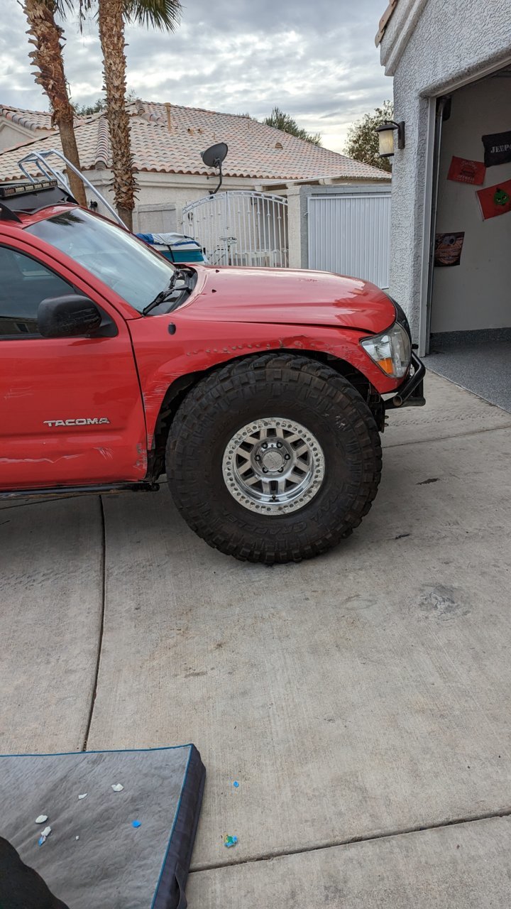

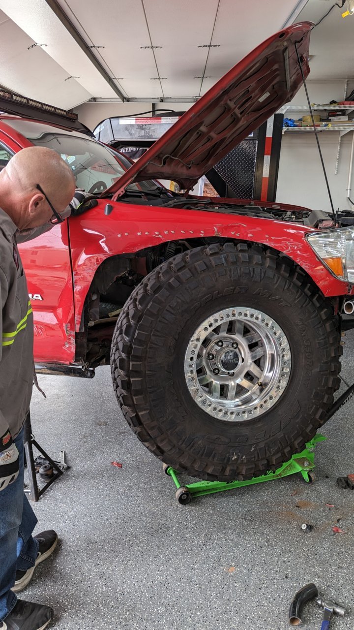

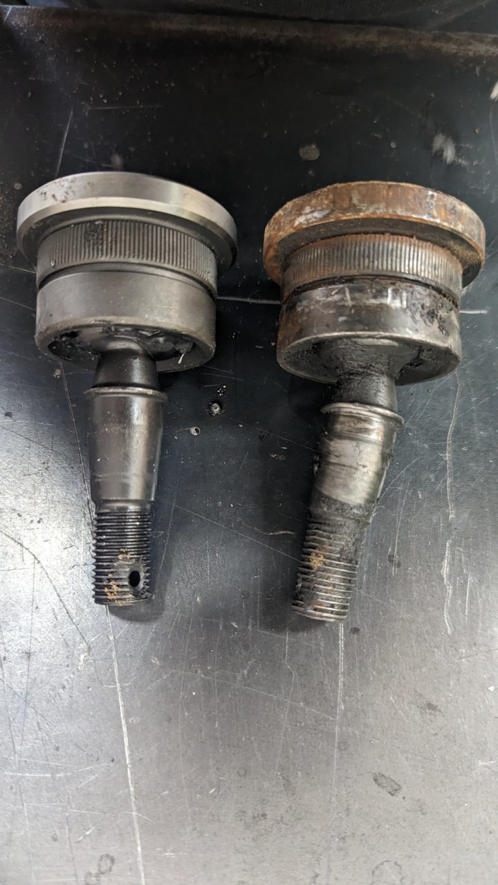

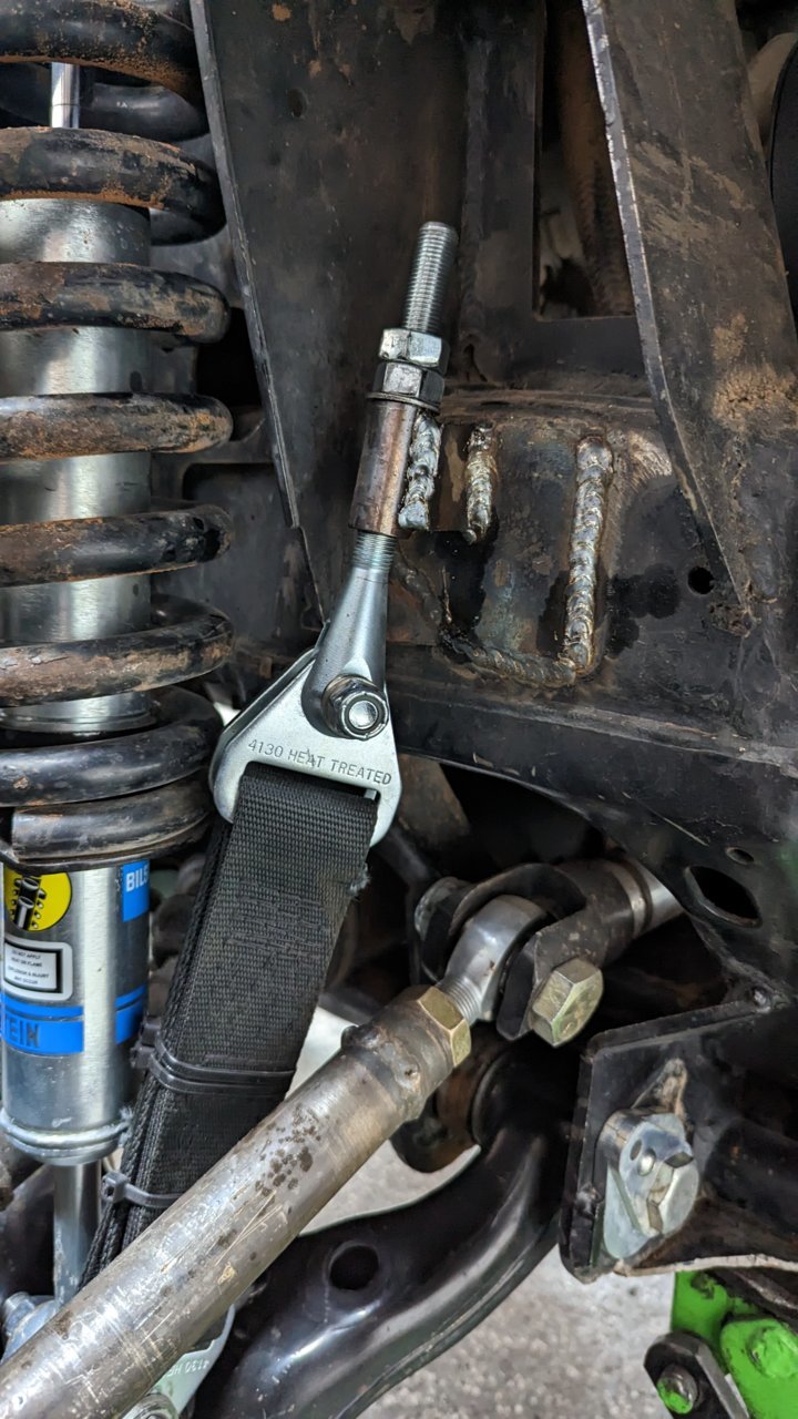

    Then i picked up some new (to me) 40x13.5x17 nitto kspecs and started the process of tubbing. I also found my UCA balljoints were bad and added limit straps.

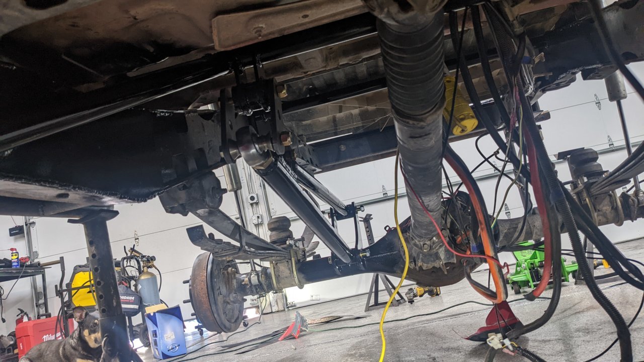

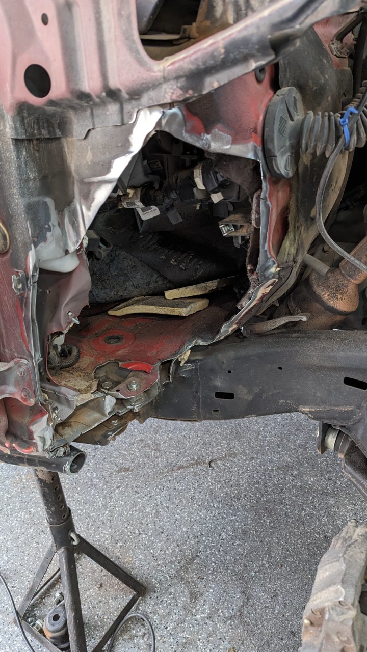

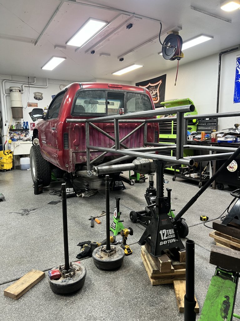

    Got a new truck, cut it apart and doing a trailing arm setup with about 21inches of travel
