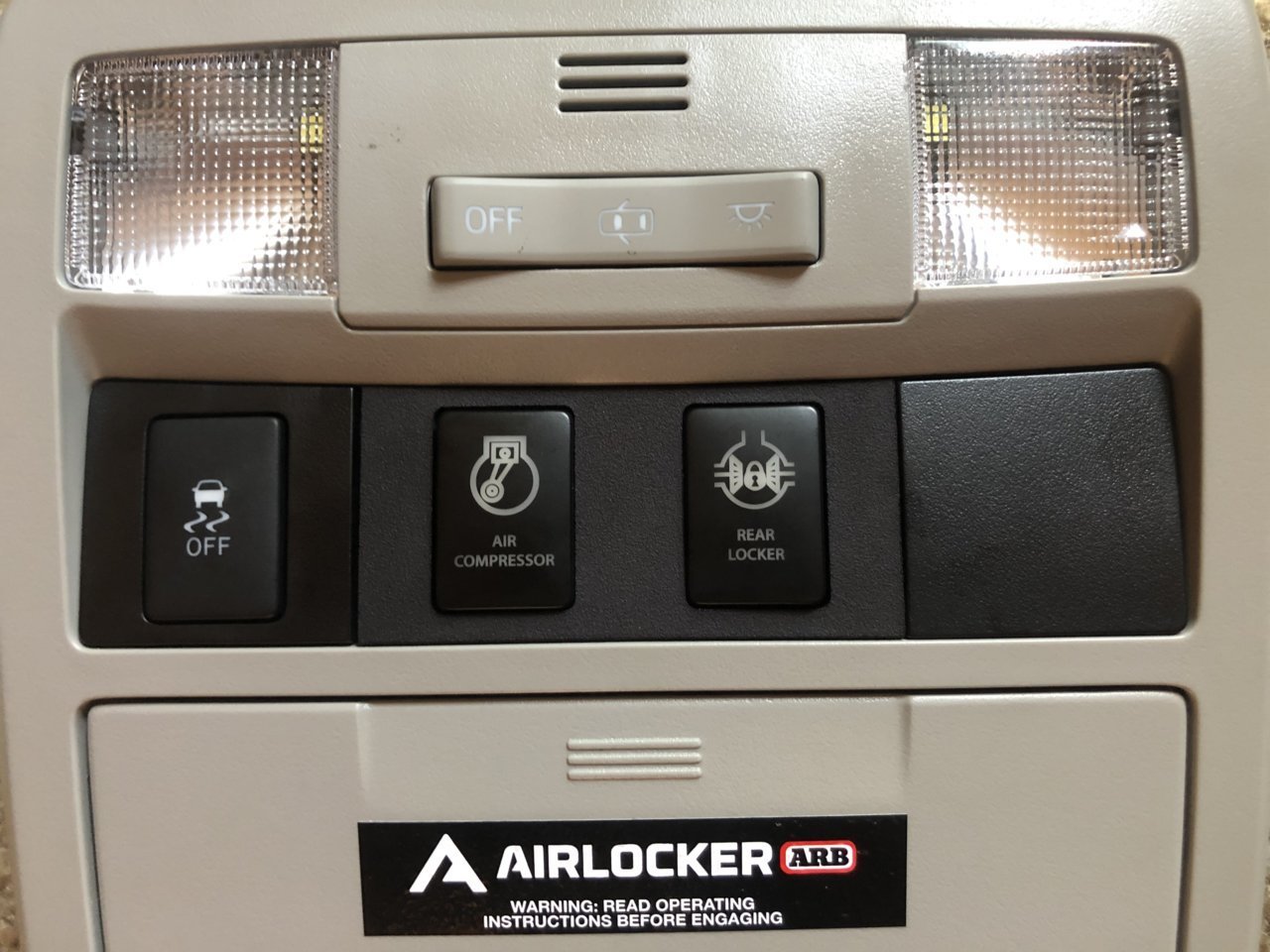

    Searched quite a lot and I couldn't find an answer.
    So I swapped my ARB comp switch out for a CH4x4 one and decided to pull the Q charger switch out and use that space. Also using the wiring from the Q switch to interface with the CH4x4.
    So the CH4x4 has 4 wires, Green, Red 1, Red 2, and black. The ARB has 5 wires. Red, red/yellow, blue/white, and 2 black. I merged the 2 black together so its basically 4 to 4. Per the CH4x4 wiring diagram, green gets 12V, black is ground, red 2 needs the dimming wire, and red 1 goes to accessory.
    Some searching showed the Q switch color code as grey for acc 12V, green for dimming, blue for switched 12V? and white for ground?
    I wired the CH4x4 switch:
    Green - Red/Yellow : 12V
    Red 1 - Red : air comp
    Red 2 - Blue/White : dimmer
    Black - Black : ground
    When I turn the dash lights on, the lower section of the CH4x4 turns on and then when the button is pushed in, the rest turns on and my air comp fires up. However, the switch doesn't dim. Not really a big deal, just curious if anyone has done something similar and gotten it to work? I did try wiring the white on the Q switch to black on the CH4x4 switch so the dimming would have its connected ground. But it made no difference.

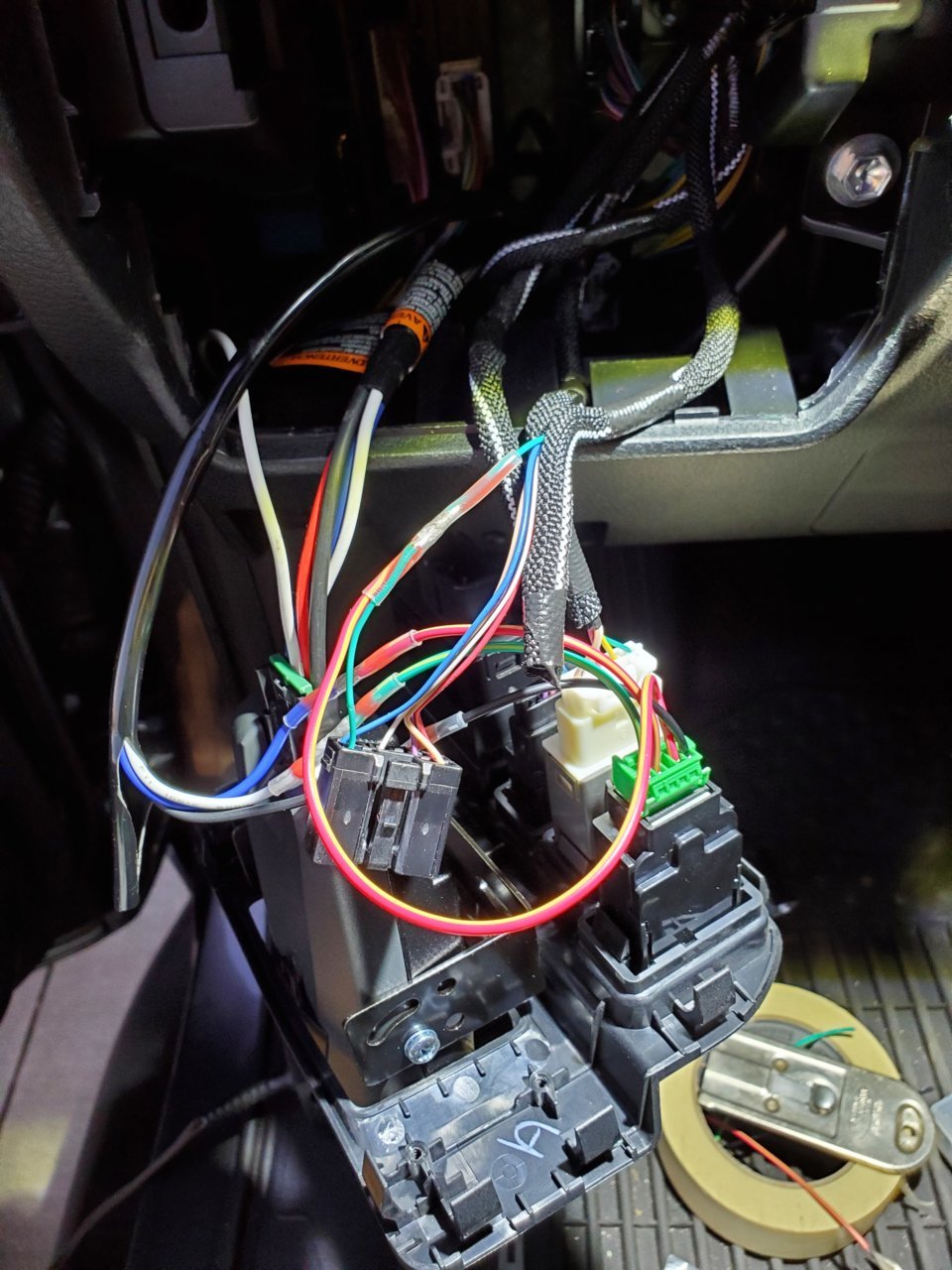

    I have two switches, one from Cali Raised and another from ARB.
    They both are LED lit (I know, I installed them) and they do dim with the panel lights.
    The LED illumination wire in the wiring harness is green. I'm guessing you are hooked to switched 12v and not the dimming circuit.
    Note my red and yellow wires hooked to the green one, that's the dashboard illumination wire.

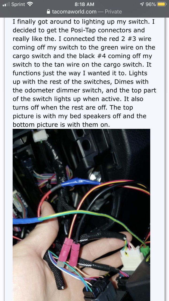

    I have mine hooked up just like yours. Green to 12V, red 1 to accessory, red 2 to dimming, and black to black. Your pic looks like your switch is connected to constant 12v and the only wire interlocked with the truck wiring is the green dimming wire.

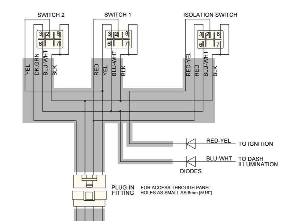

    Ahhhh you're trying to wire an ARB compressor. Didn't fully read the first post. Hold up I have a nerdy ass diagram for you.

    If you follow the black wire from this diagram all the way back to your compressor's relay you'll see that you actually don't need to connect the black wire of the switch harness to anything. You may ground it if you'd like, but it won't do much. It's just an extension of the ground wire that is grounded to the battery. If you connect this to your switch it won't dim as it's a constant (-). I took that pin completely out of my switch harness when I ran my CH4x4 switches.
    Wiring these can be a little tricky if you have a locker (I don't think you do, but if you do and need help let me know I can help you decipher this diagram), but if you're just using the isolation switch it's simple:
    You connect the RED/YELLOW of your harness to the GREEN ignition wire (1) on the CH4x4 switch. You then run the tail-end of it to a fuse tap. From factory the tail-end is bare to perform this operation.
    You connect the BLUE/WHITE of your harness to the RED 2 (pin 3) on the CH4x4 switch. You then run the tail-end of it to the GREEN (+) of a neighboring R44 connector for illumination (+). From factory the tail-end is bare to perform this operation (it's long as shit so cut it down to size).
    You connect the RED wire of your harness to the RED 1 (pin 2) on the CH4x4 switch. This runs to your relay and controls your compressor.
    I would recommend you take a fresh piece of wire (not on the harness) and connect it to the BLACK (pin4) on the CH4x4 switch. You then run the tail-end of it to the TAN (-) of a neighboring R44 connector for illumination variable (-).
    Might require some mental gymnastics but eventually it works as advertised.

    Thank you! That was the missing piece. Not hooking those black wires up from the ARB was holding me up. Tan to the black from the CH4x4 switch and black from ARB left off. Switch now lights and dims as it should. You rock!
