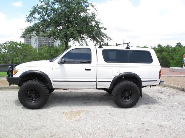

    This is what the truck looks like today

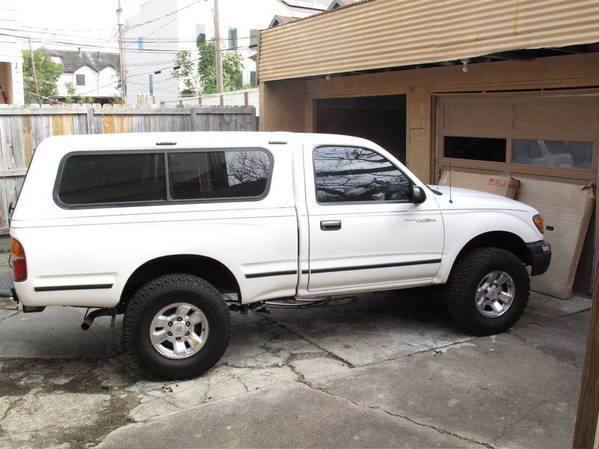

    My truck is a 2000 Toyota PreRunner Reg cab 4 cyl. Bought it brand new and the basics which was all I was willing to pay for at the time. Only mod for years was a Raven Cap to haul my dogs around in.
    This is what it looked like pre-mods.

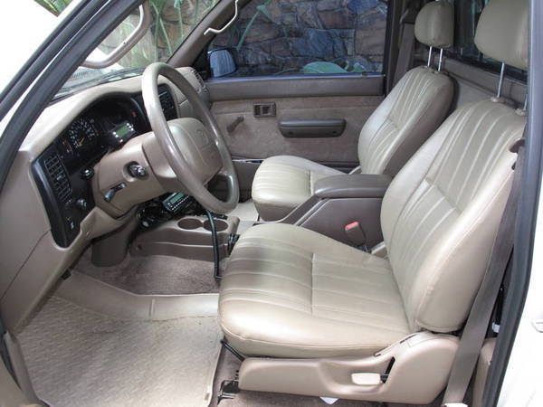

    I always took really good care of it but the interior was looking a little worn. I knew a guys who did some interior work for my dad so I went an talked to him. Leather seats with new padding and spring repair, new carpet, dash refurb. Cost me $550. Pretty good I think.

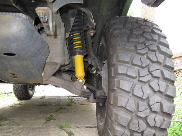

    Ordered an OME kit with 882s/N91S and Dakars and an ARB bumper. Had fun doing the install and it took about a day to assemble all.

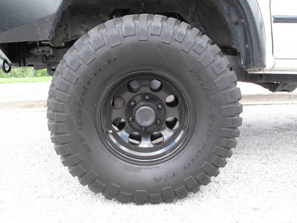

    After the lift my tires and wheels just didn't look quite right anymore. Time to upgrade those too. I new I wanted black rims but was undecided on size. Decided on 15s so that I could have more rubber between the rim and the ground. The BFG KM2s looked good so I said what the hell. Went with 33x12.5s and love the look.
    The truck after the lift, the tires and the alignment wondered on the road a bit. The caster just wasn't quite right and the ball joints looked a little stressed. Bought and installed some Camburg UCAs and after a quick install, I took it back to the alignment shop. 3 degrees Caster..Yeah! Drives great now.

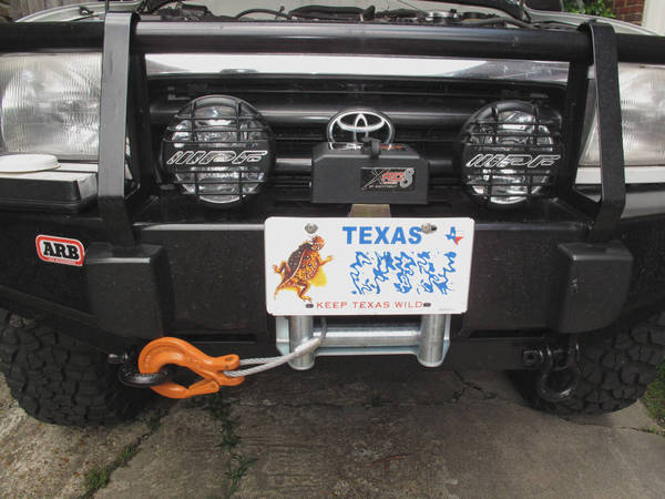

    The ARB bumper looked bare and the 882s needed some weight. Installed IPF 968s and Smittybilt 8k winch.
