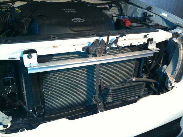

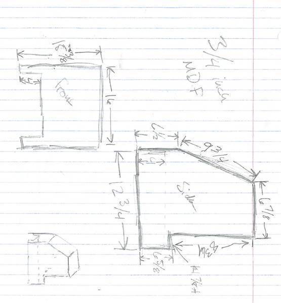

    Here is my chicken scratch measurements, my disclaimer is that this worked for me, I cannot guarantee it will work for anyone else. As Krappy said, modify the width of the box to get the volume you need for your specific speaker.

    Is that 1/8" angle aluminum? Will it support the weight of the Hellas? I cant really tell how thick it is from the pics.

    chadderkdawg
    chadderkdawg [OP] Don't ask questions you don't want the answer to..
    Apr 29, 2011
    #55763
    8,148
    Des Moines, Iowa
    09 FX4 F150
    1/8th by 1 1/2 aluminum, it should support them just fine.

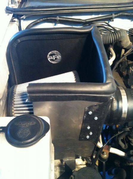

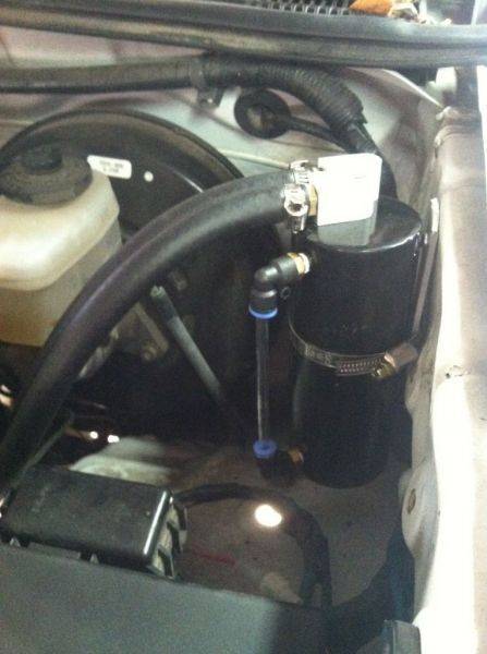

    Added a couple things yesterday, oil catch can, got it for 15 bucks on ebay, and about 2 bucks worth of hose from autozone, and my afe cold air intake that I modified the heat shield on to keep some of the engine bay heat out.

    If you haven't already .. I used some smaller but same thickness angled aluminium for vertical supports on my light bar. I found that after installing the lights, the weight made them shake and vibrate. The supports fixed that and they are solid now. Also had that same intake. :)

    It may be coming out... I pulled a milk shake out of it the other day...

    Isn't that good? Or do you mean the oil froze from the cold?

    This is what came out.... is that normal?

    It's not bad! Just fold the pinch weld over with a big hammer! Lol
