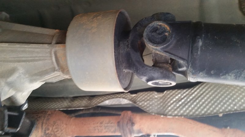

    Lifted without a driveshaft spacer, possibly.
    As you lift the rear it pulls the ds out of the transmission. You're actually pushing the rear end down to lift the truck & the ds isn't long enough. So if you ride with it like that & the rear drops it could pull it all the way out.
    I needed a 1.5" spacer to put mine back where it belongs.
    After my lift.
    After the ds spacer put it back where it belongs.

    Wow..1.5"? That's a big drop.
    You have a 6" lift, correct?

    Yeah, All Pro expos & 2" blocks.
