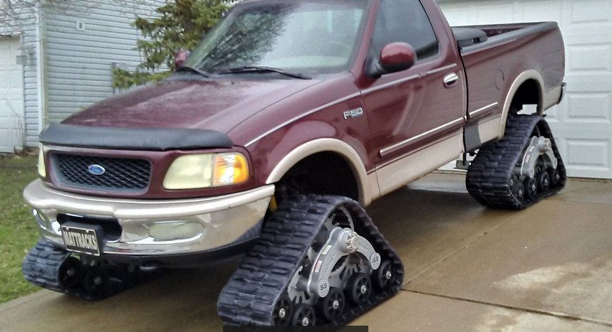

    Don't monkey about with chains. No need for winter tires. No TPMS worries. No problem with fluctuating tire pressures.
    Go full boss with a set of these........
