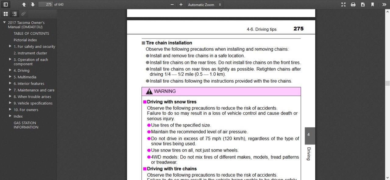

    Chains will not clear the front suspension components on the Tacoma's,chain up the front at your own risk.

    If only one set they go on the rear. If 4X4, and if you can make them fit front and rear for extreme conditions. I wouldn't use them on just the front unless it is a front wheel drive car.

    Yeah they are. Page 274-275 in Canadian Manual they dont recommend chains on the front

    Yes,in winter driving tips starting on page 272? I posted the relevant screenshot
