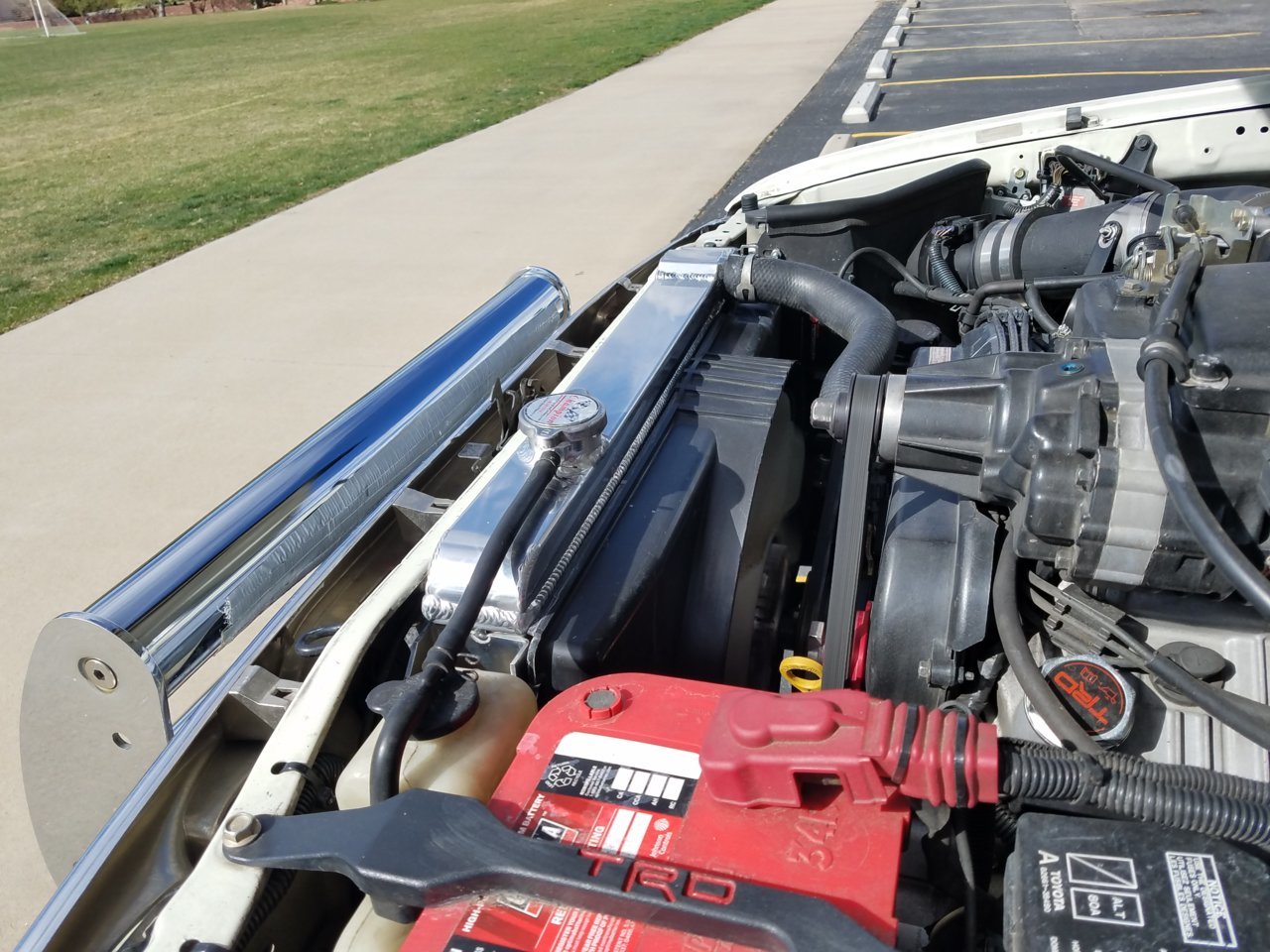

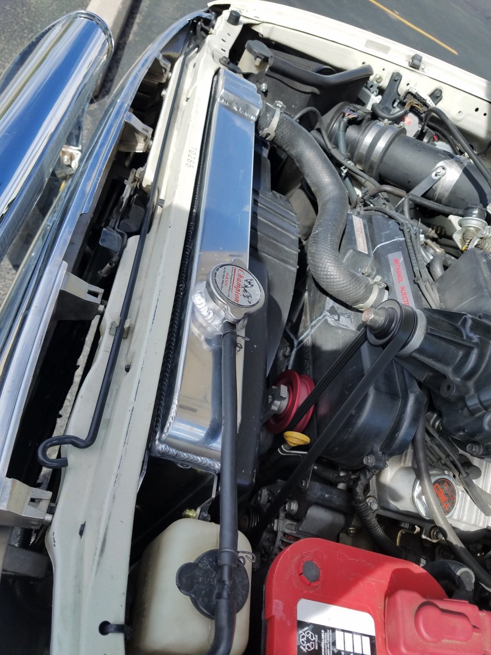

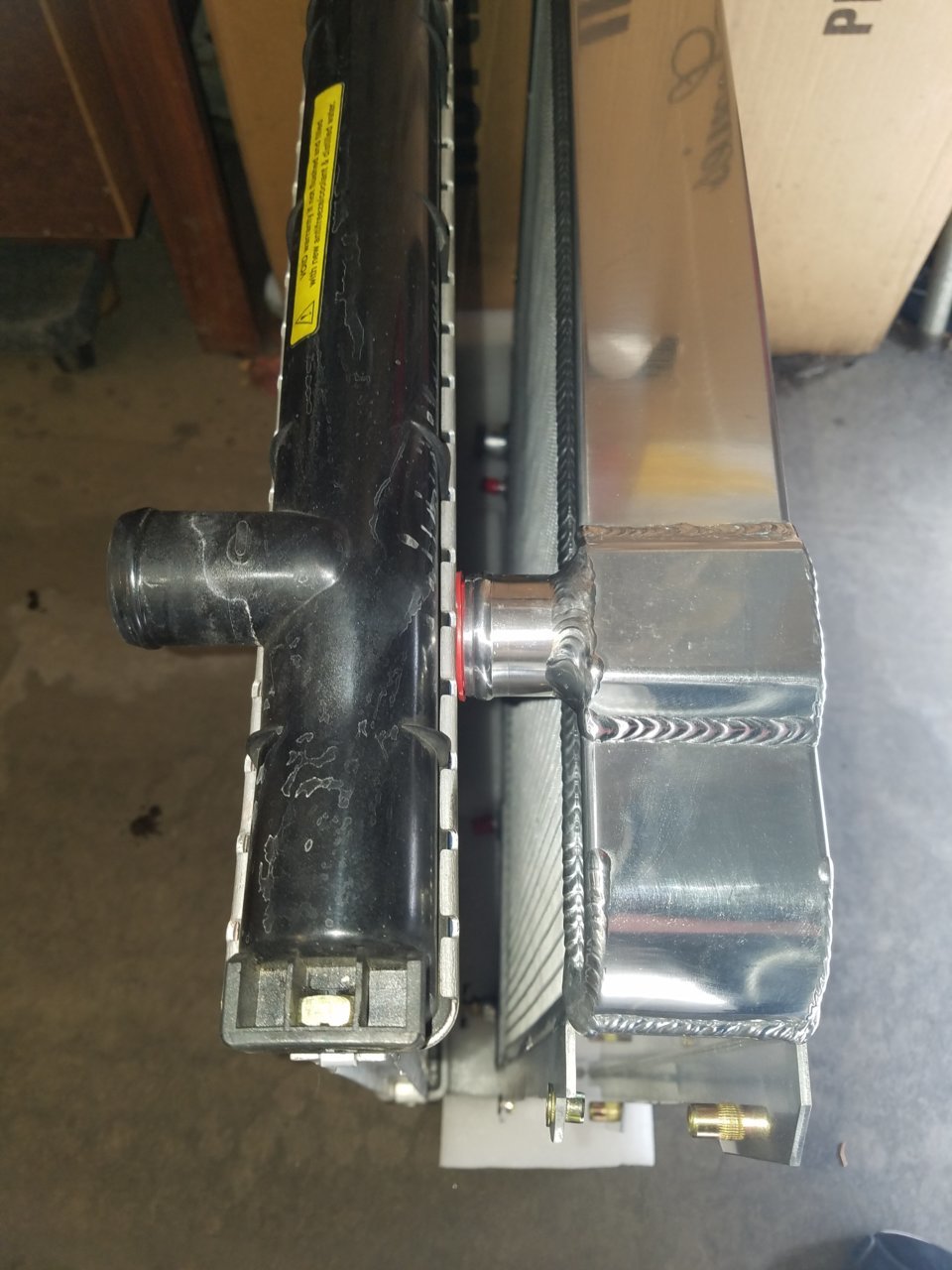

    So I finally found some time to do this swap today.
    This is how it went and what needs to be done with a 3.4, 5 speed tacoma 1997.

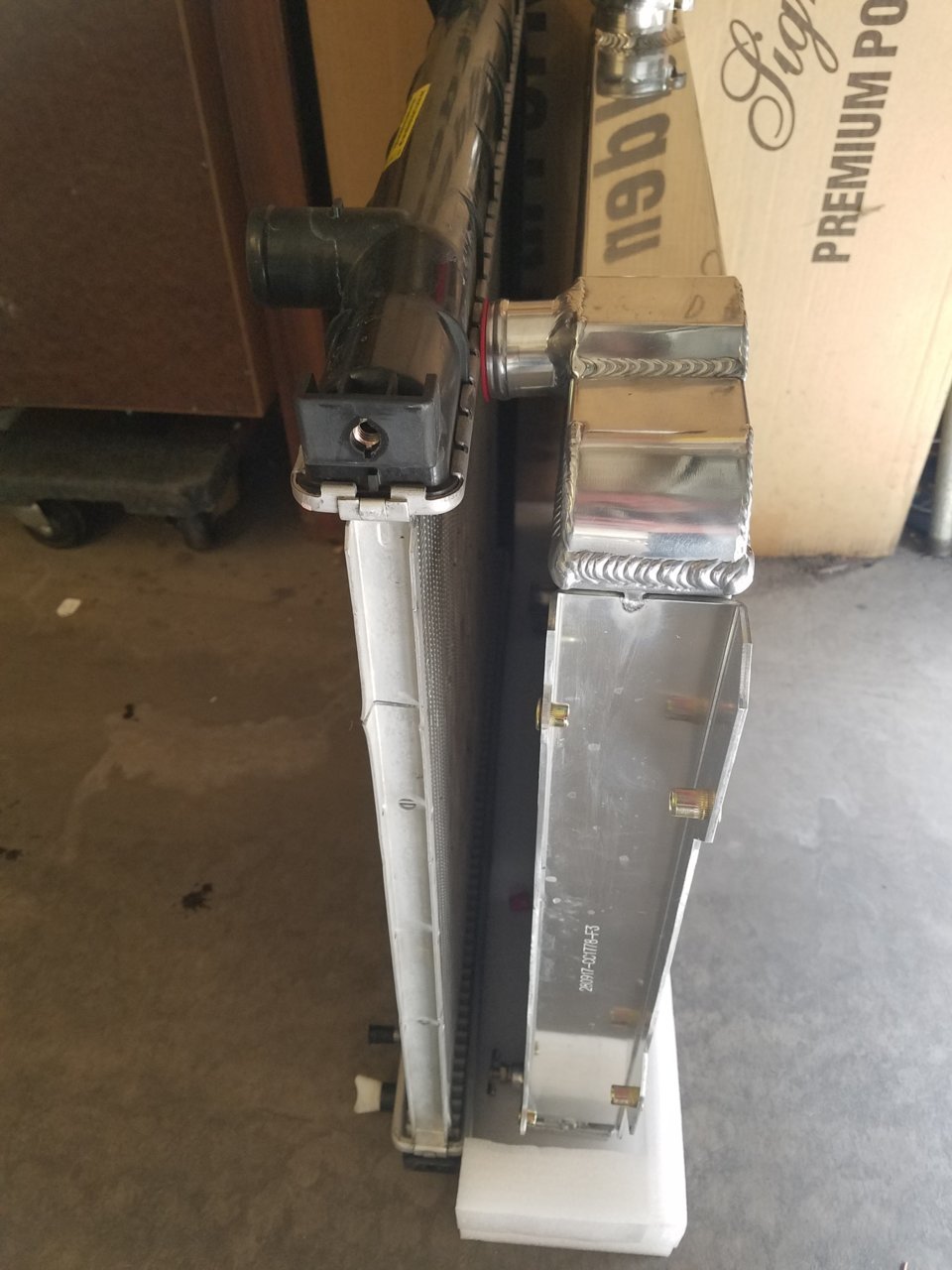

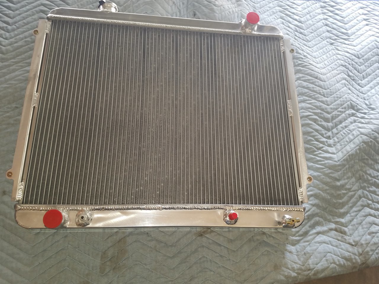

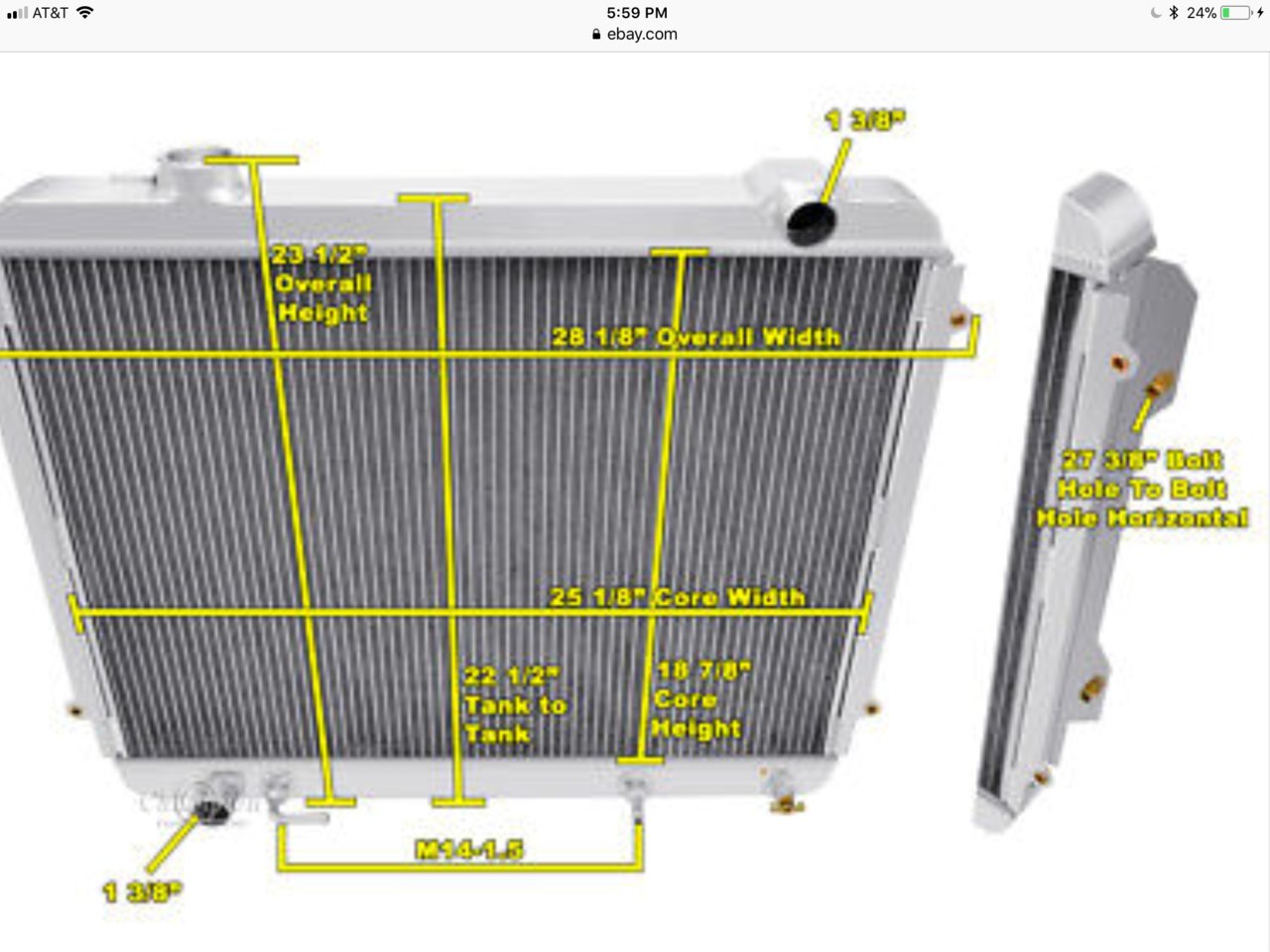

    The 3.4, 5 speed has a radiator core that is 20.75” tall.
    The Champion 3 core radiator for this swap is a little shorter in height at 18.90”.
    These measurements are the core height that does not include the tanks FYI.
    The swap is straight forward as in any radiator replacement.
    The Champion radiator is (2.5”) almost 3” thick and makes the stock core .75 thick radiator look pretty silly when it’s side by side.
    The 3 row Champion Radiator is huge compared to the junky plastic tank stock radiator single core.

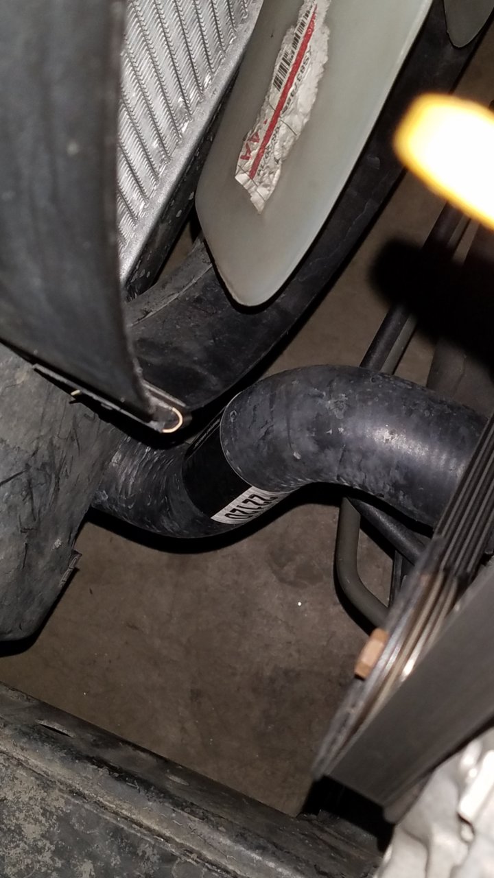

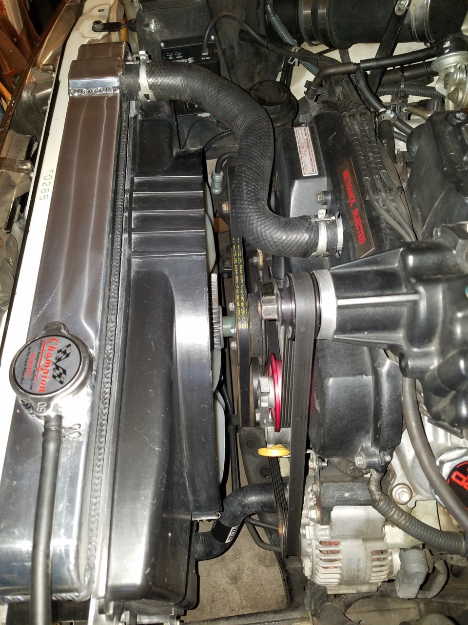

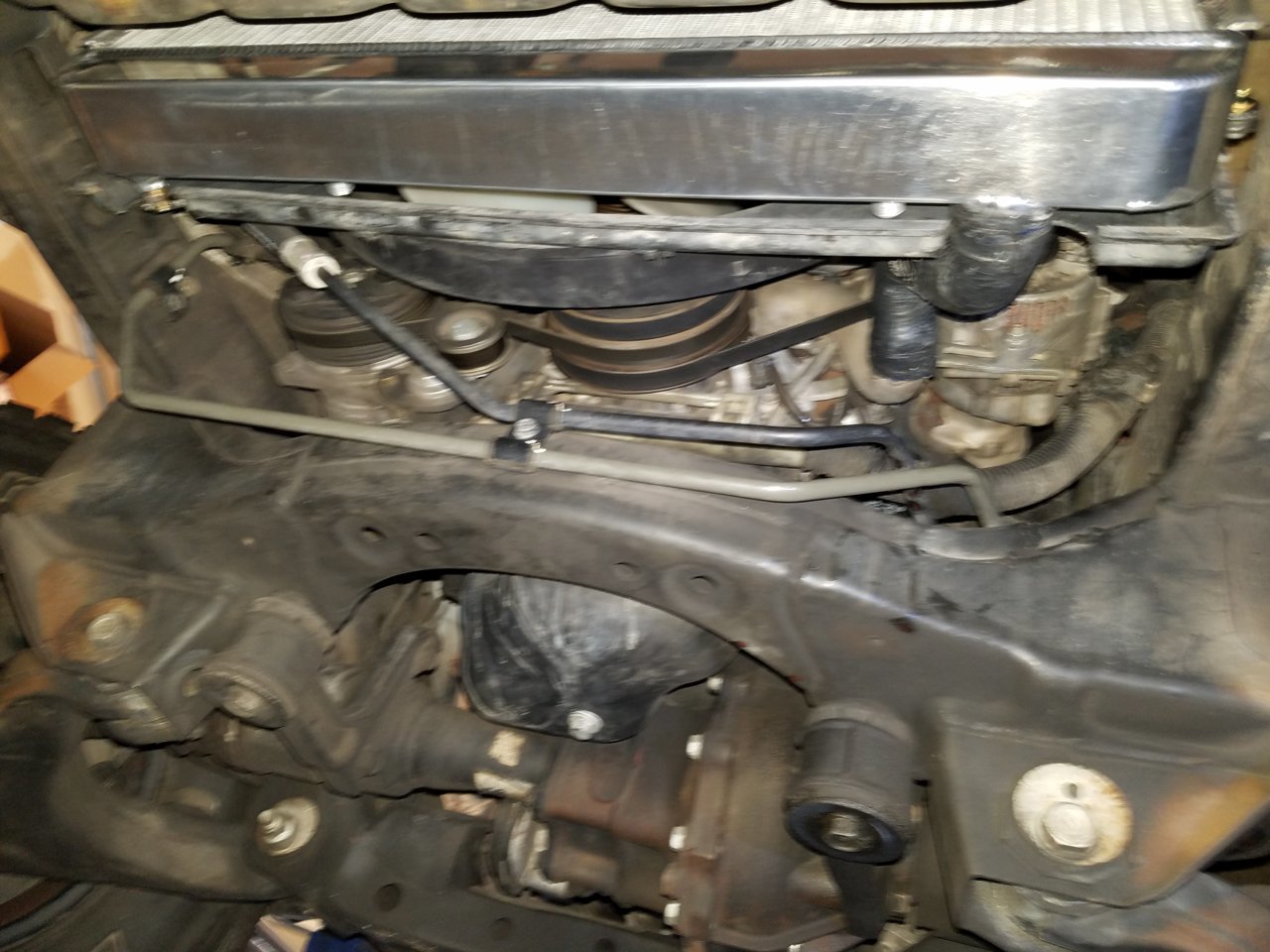

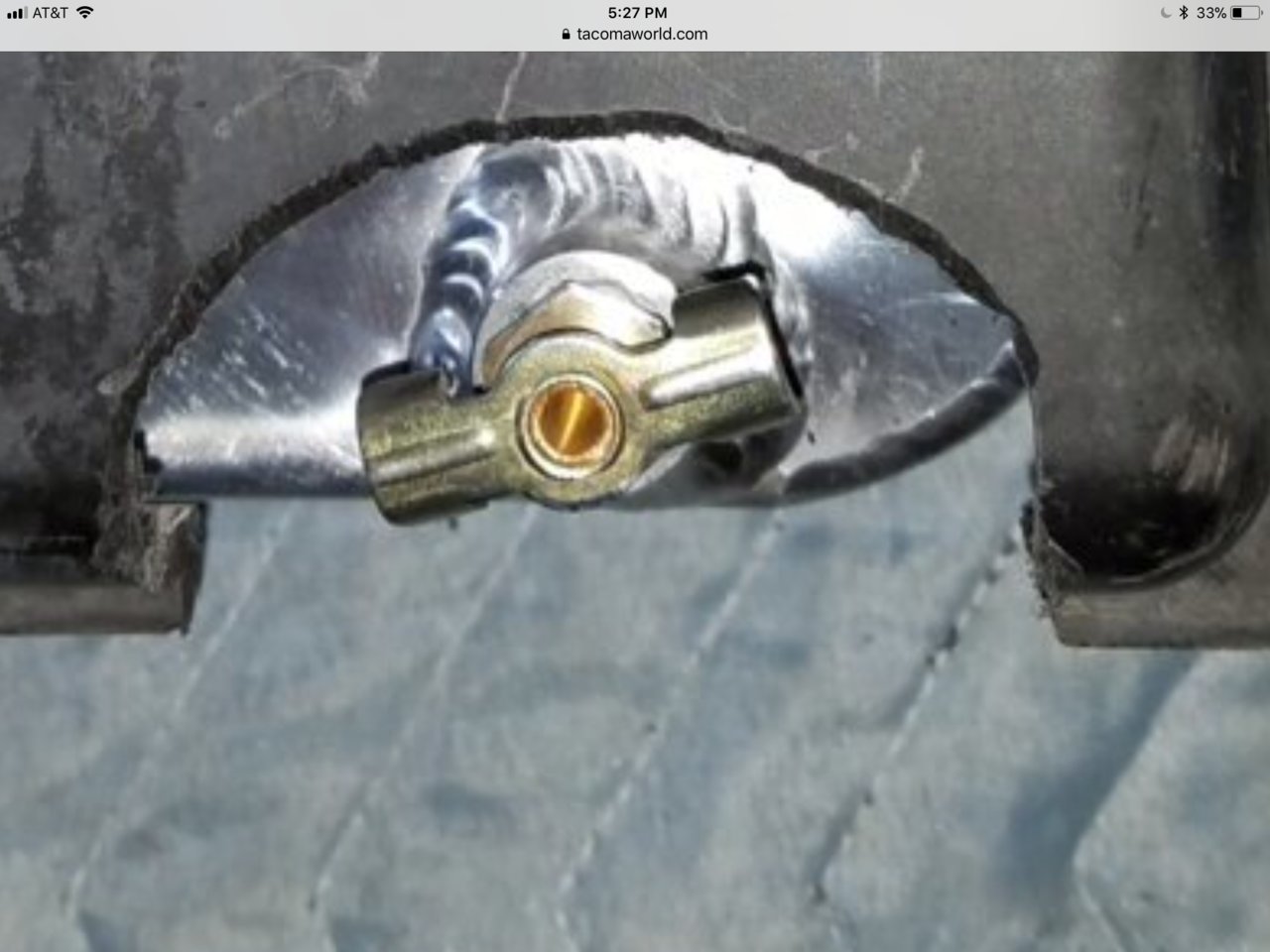

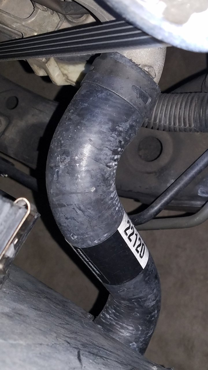

    1) The two hiccups you will have is the stock lower radiator hose will not fit.

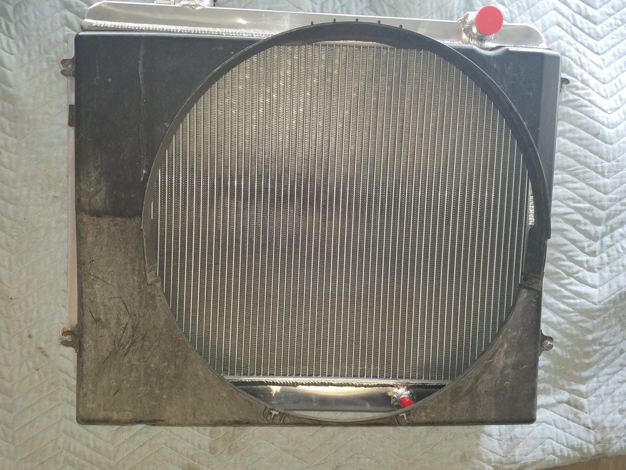

    2) The fan shroud will need to be cut where the lower radiator hose connects and the radiator peacock sticks out.
    3) The Champion Radiator cap is junk that comes with the radiator, ( they tend to leak and don’t seal well to the radiator) so spend 12.00
    and get a good quality replacement cap.
    Otherwise it’s all plug and play.
    The lower radiator hose you will need is a gates part number 22120.
    Make sure when you install the hose that the bend in the hose is twisted away from the shroud to give you extra clearance.
    This hose you will need to cut about 1.5” or so on either end.
    You will have to make a few cuts to get it correct for the final fit.

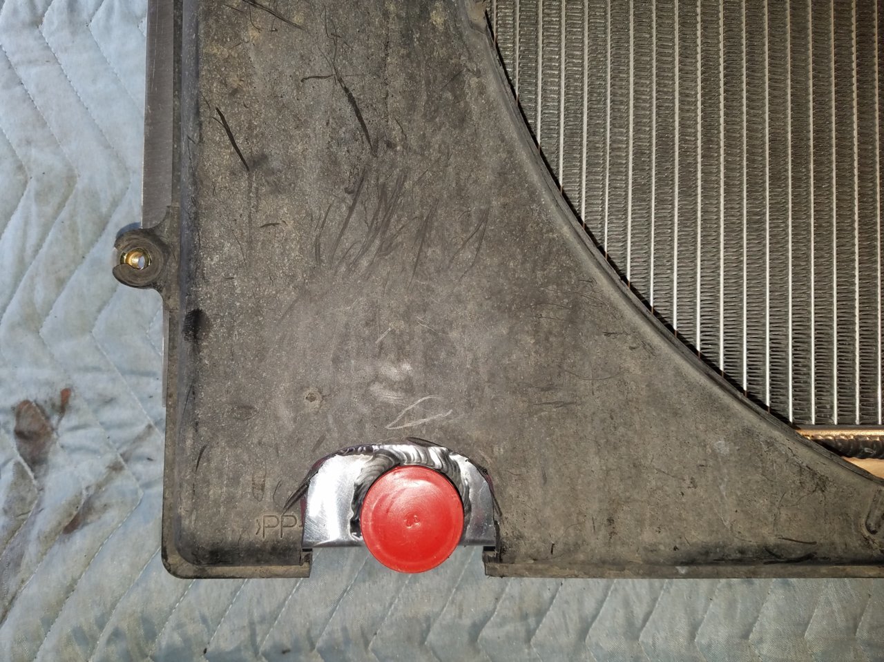

    The shroud I put over the new radiator and took a marker and marked the areas to cut out.
    Got my grinder and razor out and away I went.
    Make sure you give extra room for both the cuts for the new hose and peacock.
    The lower hose was a pain for me, so maybe connect the lower hose after you bolt the radiator it while you have extra room before the shroud is attached.
    The new gates hose will be very tight on both ends, make sure you wet down
    the hose for it to slide on easier.
    The OEM compression clamps will fit but you will have to fight to get them on.
    Or get a set of screw on adjustable clamps.
    I put in a new thermostat while I was there.
    REMEMBER THE THERMOSTAT JIGGLE VALVE IS POSITIONED AT 6 OCLOCK,
    NOT 12 OCLOCK
    So now I’m ready for some hot summer days.

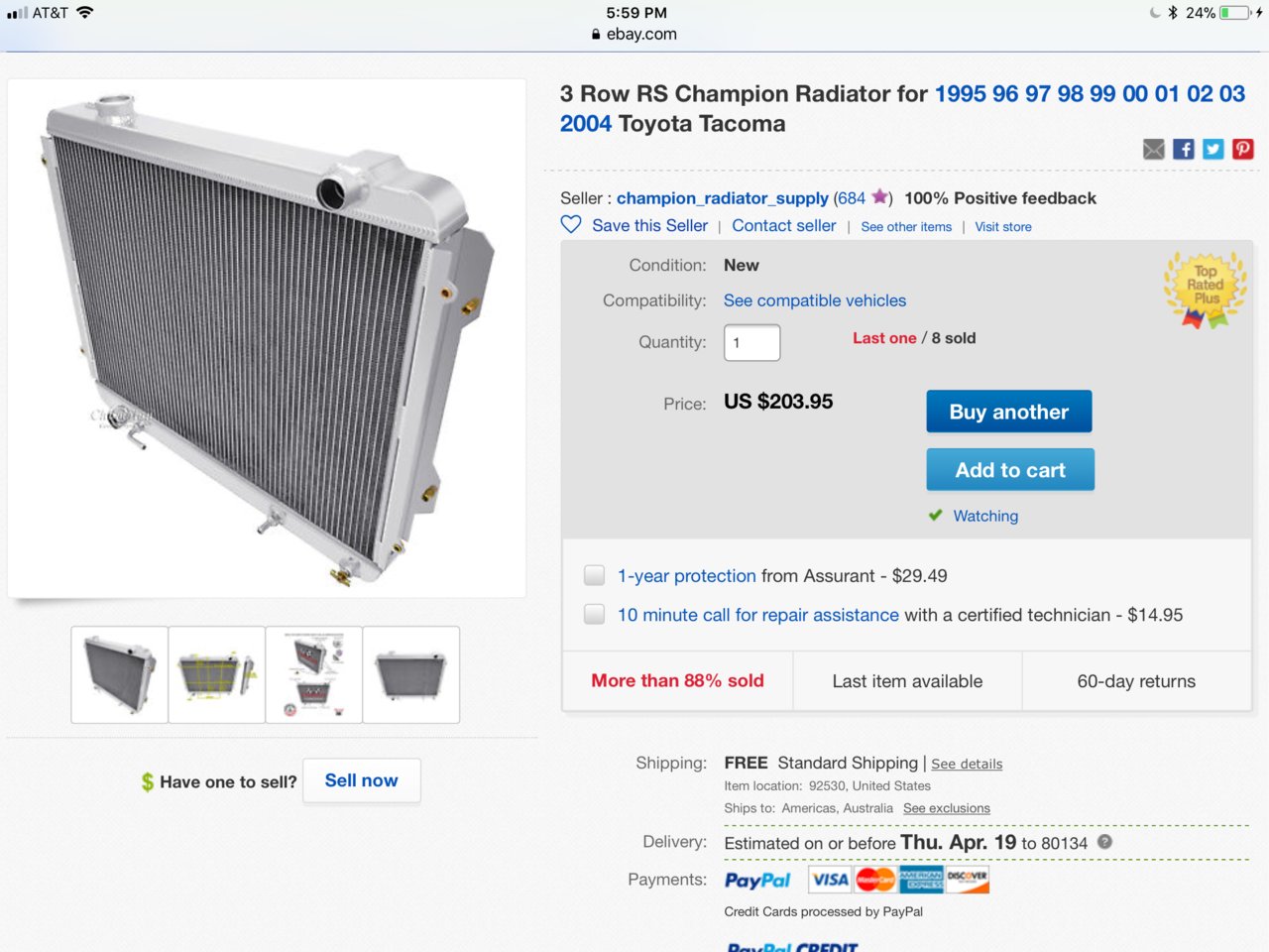

    Radiator is 203.00 free shipping on ebay

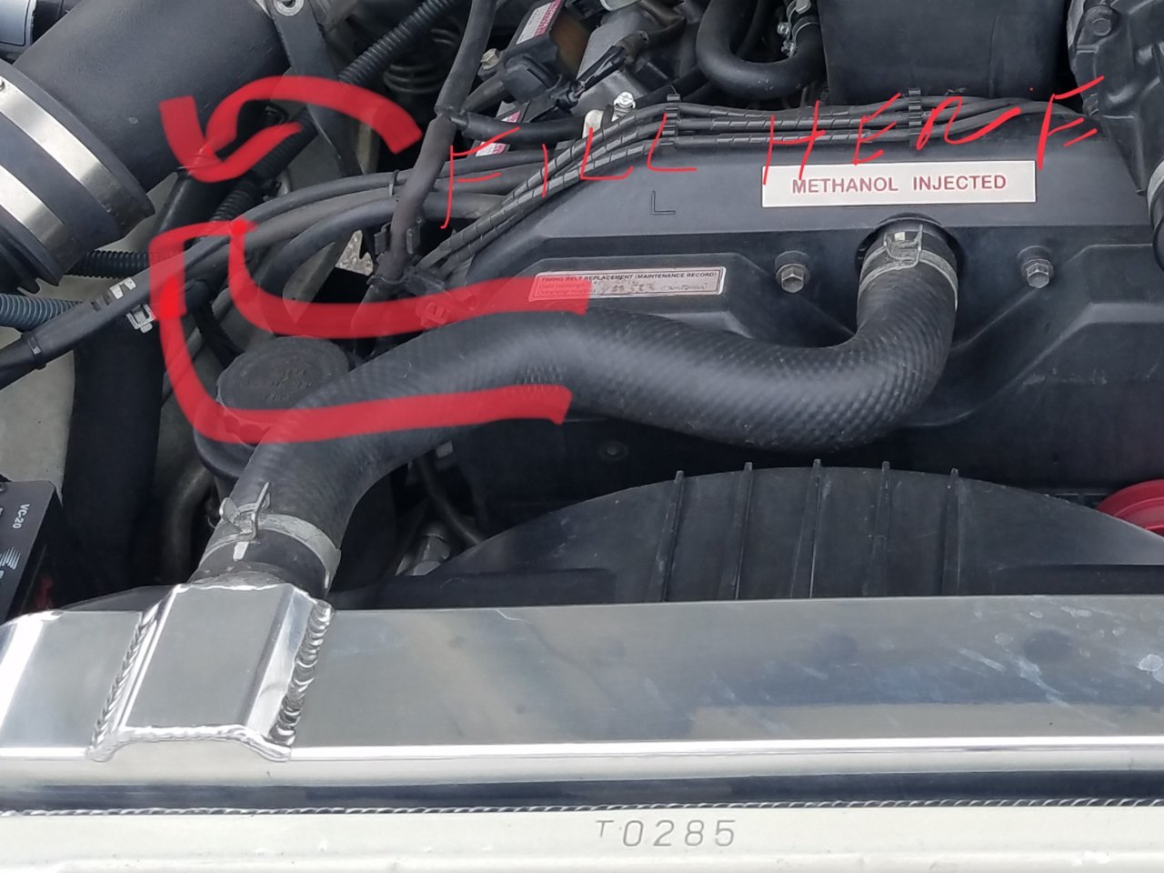

    Fill antifreeze from the top radiator hose on the engine side by bending the hose up at a 45 degress first to make sure there is antifreeze on the block side as the stat is closed and will not fill up the block side fully and remember to open the
    heater valve and burb the system as the heater hose valve is higher than the radiator cap.
    Also use some silicone spray to help slid on the ends of the lower radiator hose
    as its 1/8” smaller than the ends it goes on

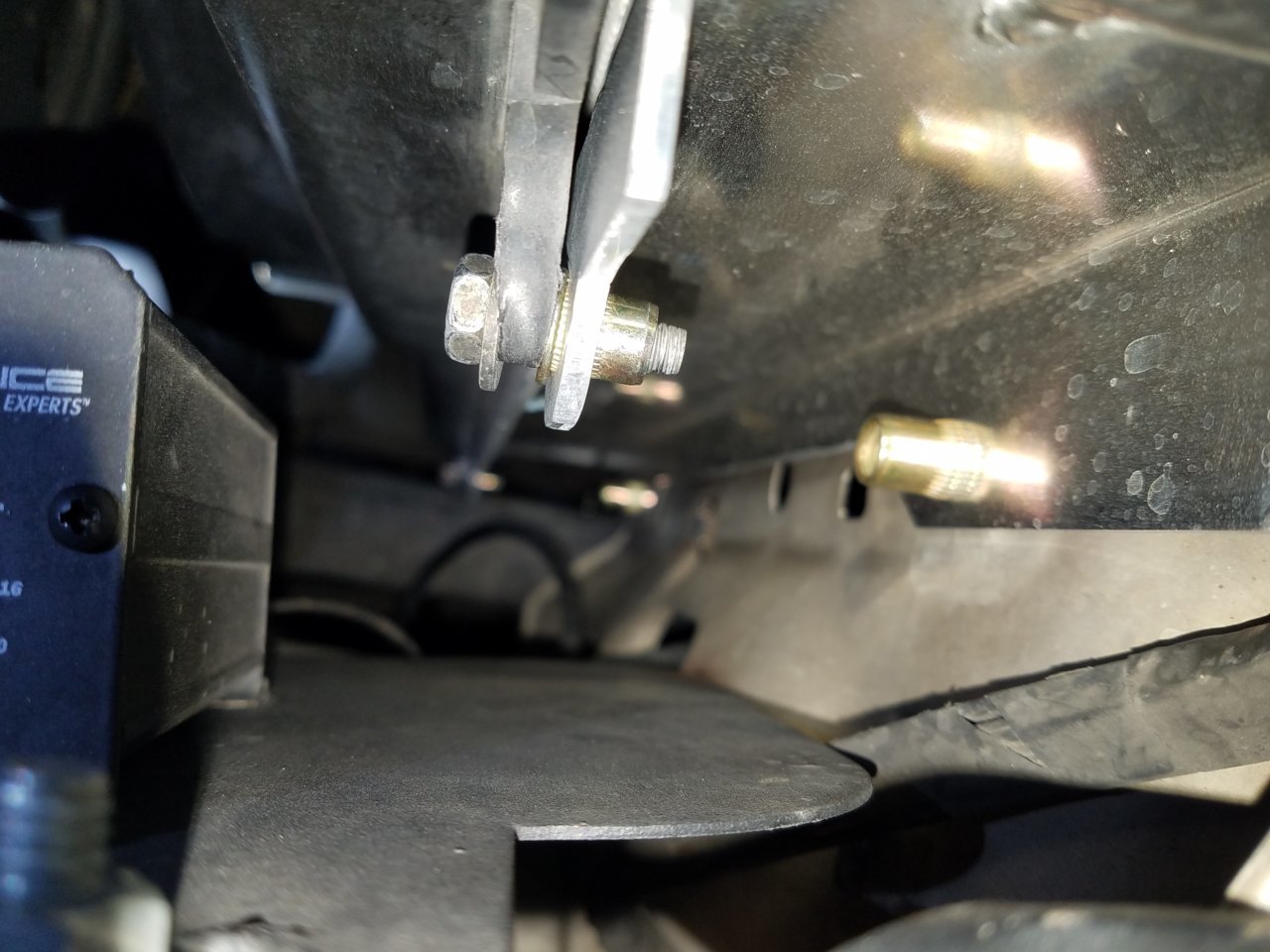

    IM ADDED THIS INFO FROM A YEAR LATER, 35,000 ADDED, AS MY RADIATOR IS LEAKING
    SOME OF THESE RADIATORS ARE HAVING LEAKING ISSUES INCLUDING MINE.
    IT MIGHT BE A QUALITY CONTROL ISSUE, OR A MOUNTING ISSUE.
    SO BE WARNED

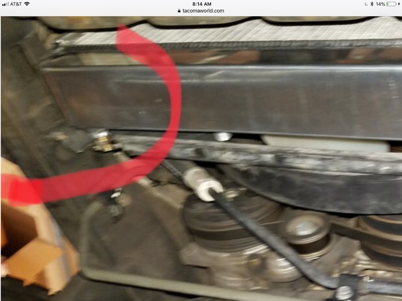

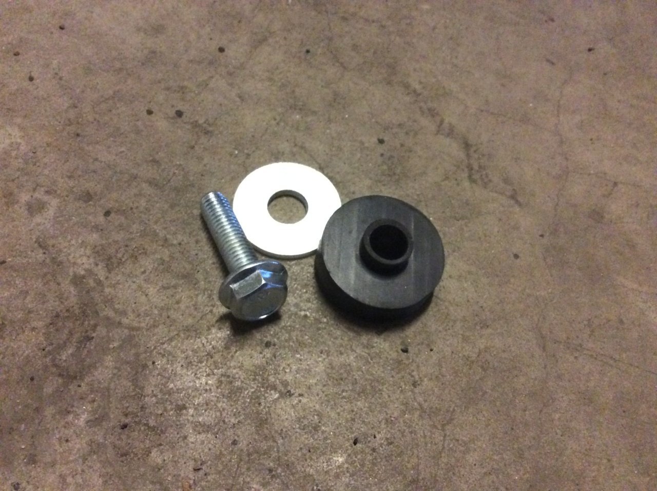

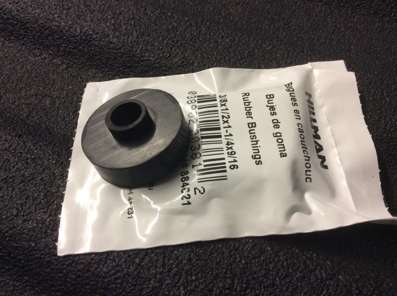

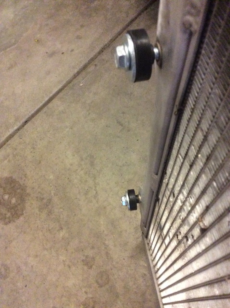

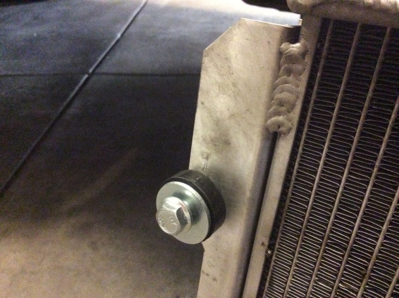

    The Champion has NO rubber bushings designed into its radiator for flex.
    So I’m thinking if you put a rubber bushing in between the radiator and the front cowling, radiator support it might be the trick and there would be some play or flex available.
    You will have to drill out the radiator nut hole so the bushing tail section can
    fit in the radiator support and has some wiggle room.
    The bushings are made by Hillman at Lowe’s
    Checkout the photos.

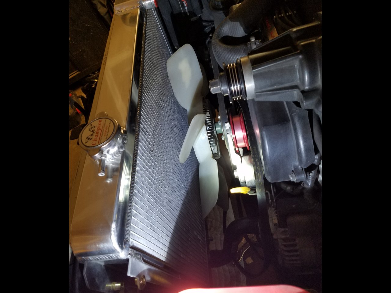

    Thanks for write up with clear pictures of were to trim the shroud.

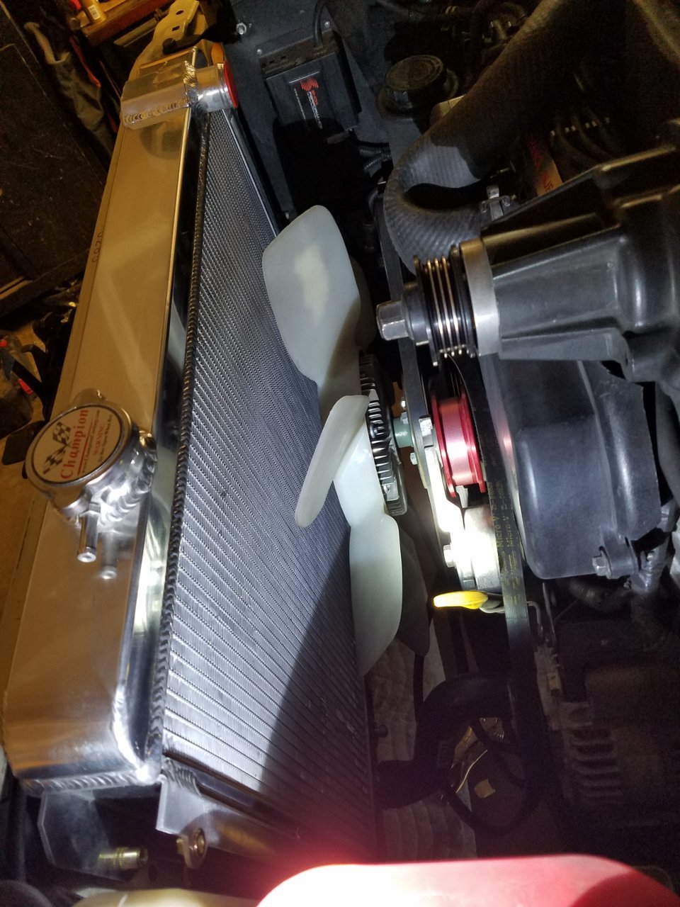

    Do you think the fan could be removed with the radiator installed? Looks a little tight and maybe the fan won't clear the studs?

    When installing this radiator you do NOT have to remove the fan or the fan hub.
    If you want to remove the fan hub or the fan clutch the fan shroud will have to be removed but I do not believe you will have to remove the radiator

    I thinking about maintenance items like timing belts and water pumps were the fan comes off. Would the radiator need to be removed?

    I don’t believe so, it’s not that tight.
    When installing this radiator you do not have to remove the fan or the fan hub.
    If you want to remove the fan hub or the fan clutch the fan shroud will have to be removed but I do not believe you will have to remove the radiator for these items to be replaced.

    You can see with the shroud removed there is plenty of room still for those maintenance issues

    Did a close inspection today, everything looks perfect, but did see a little antifreeze leaking from the petcock, The petcock is made of metal with a brass fitting compared to the stock plastic petcock.
    So I did need to tighten up the threaded metal part that has silicone tape a bit tighter to stop the leak.
    So make sure this part is tight before the install.
