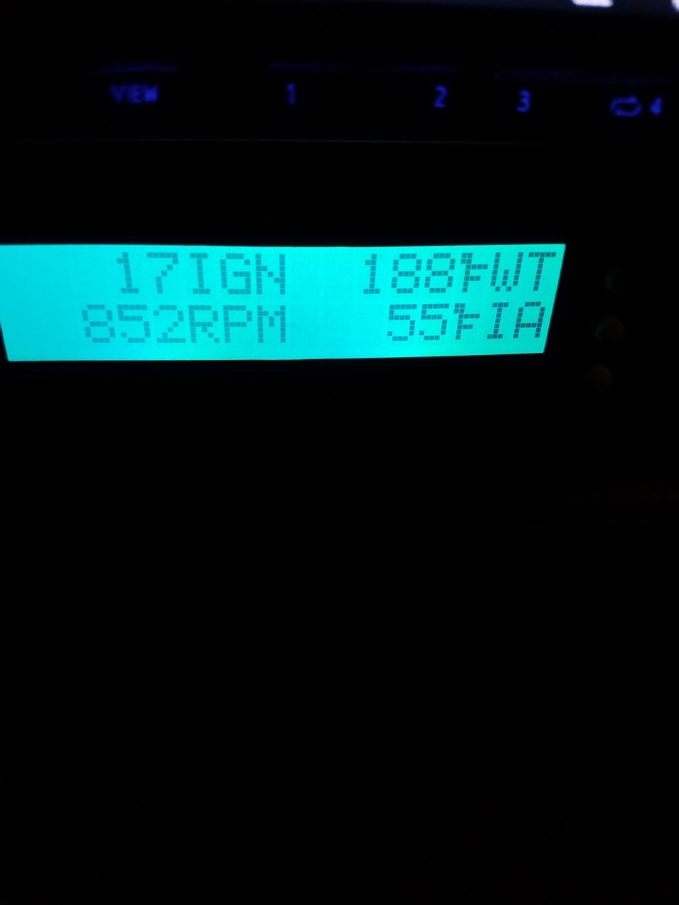

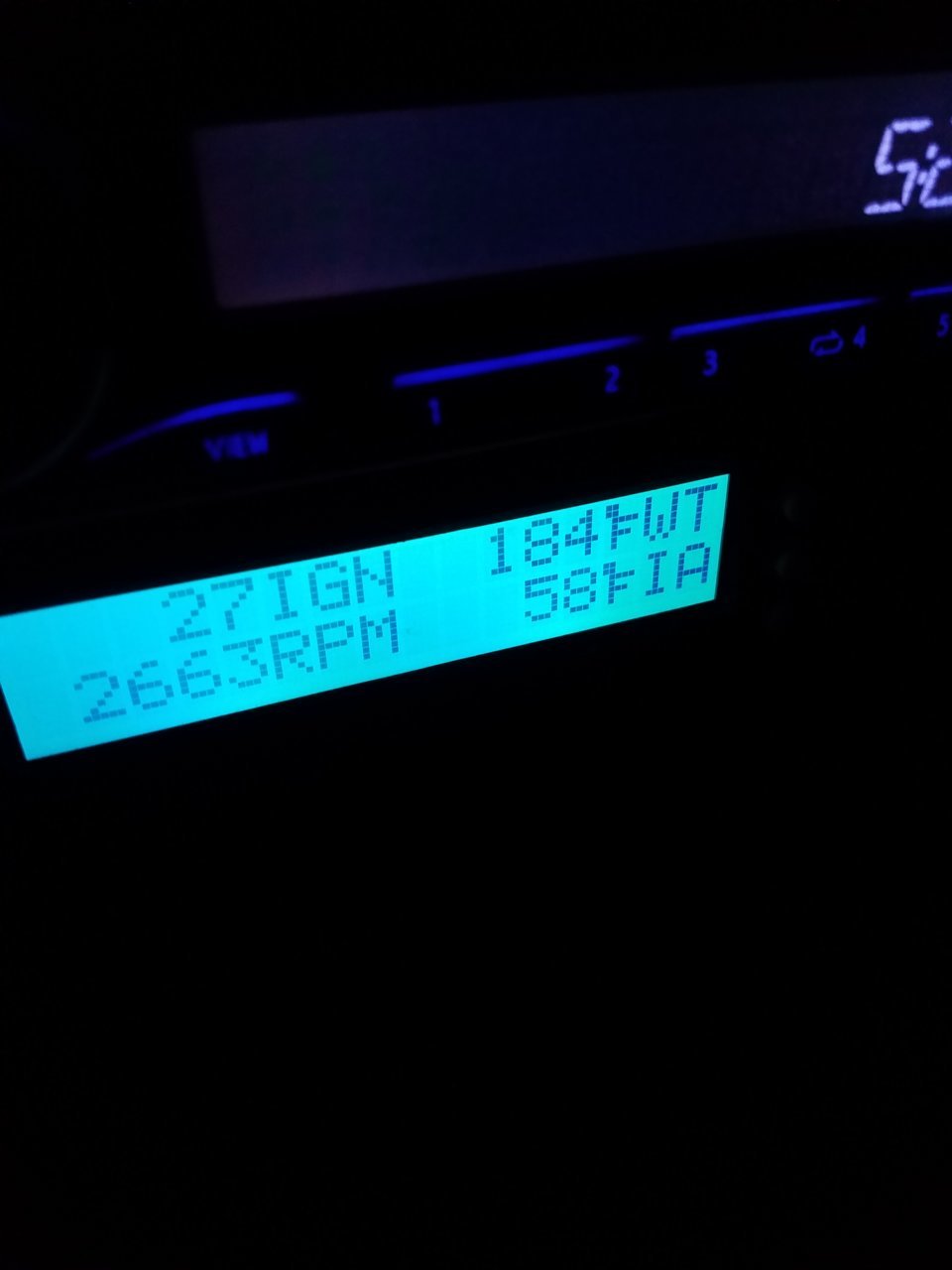

    Well your choices are a custom one that has to cost 500 or more or have the Champion neck modified or live with an ugly filler.
    Depends on how important engine temps are for your situation.
    My temps are 185-190 all day long hot or cold outside
