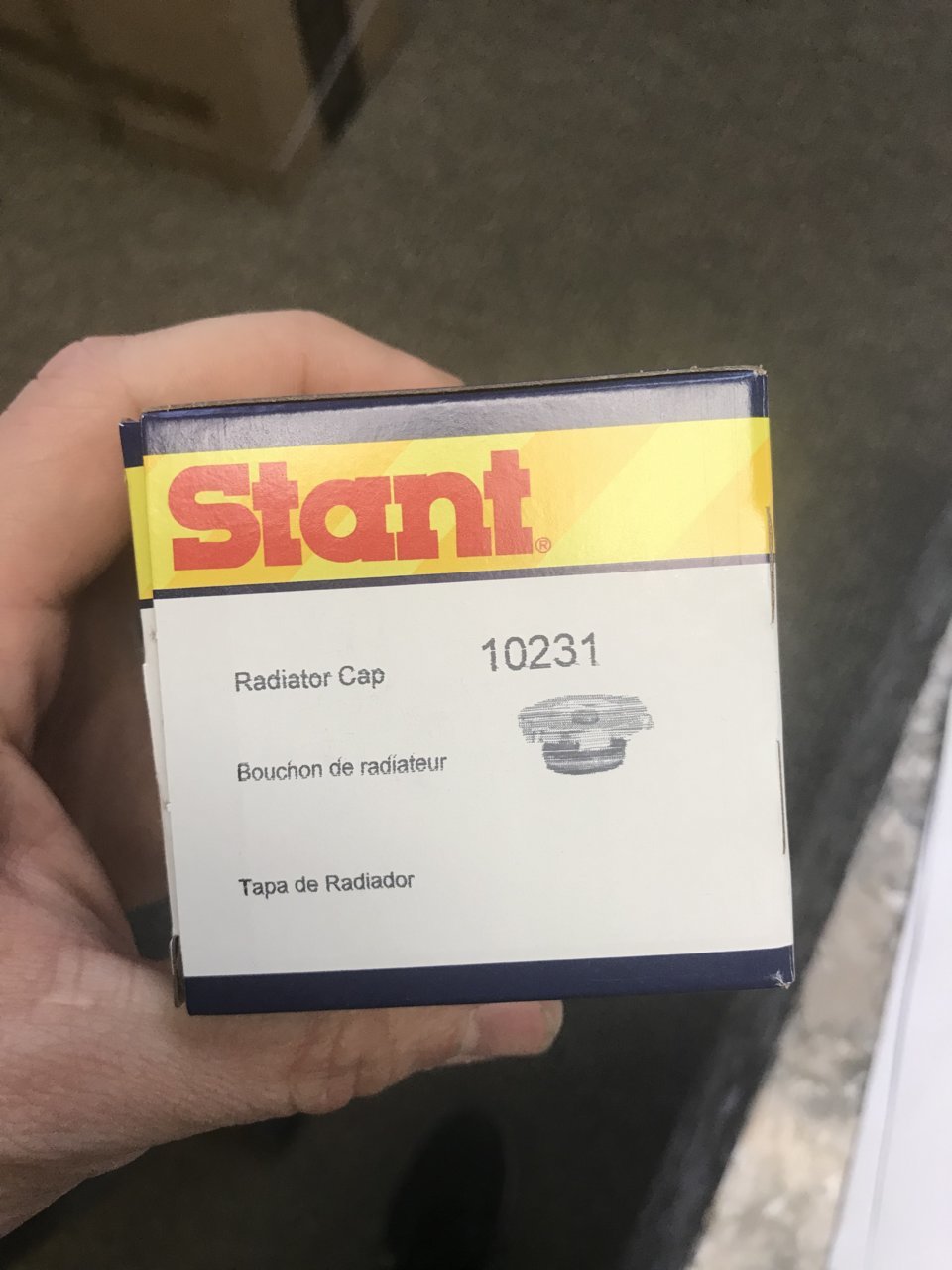

    Not sure why you think it’s odsollete, I just checked and Advanced Auto has the one I bought In stock.
    Either way you have a baseline to start from and can cross reference for a different maker if needed
    https://shop.advanceautoparts.com/p/carquest-radiator-cap-10231/17110019-P

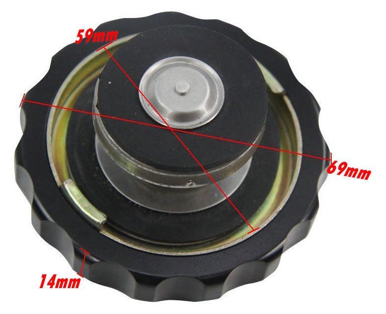

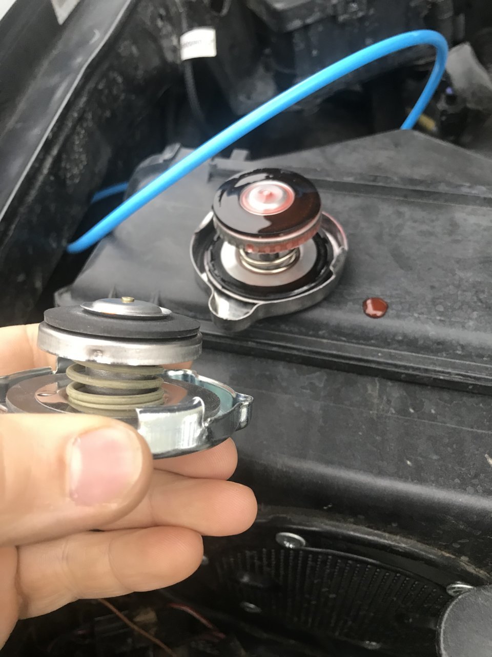

    Oops, I forgot to add that I measured the OEM and Champion caps' inner diameter with calipers and they measured at ~43.5mm.
    I measured the 43.5mm in the same spot as the 59mm is measured in the below pic:

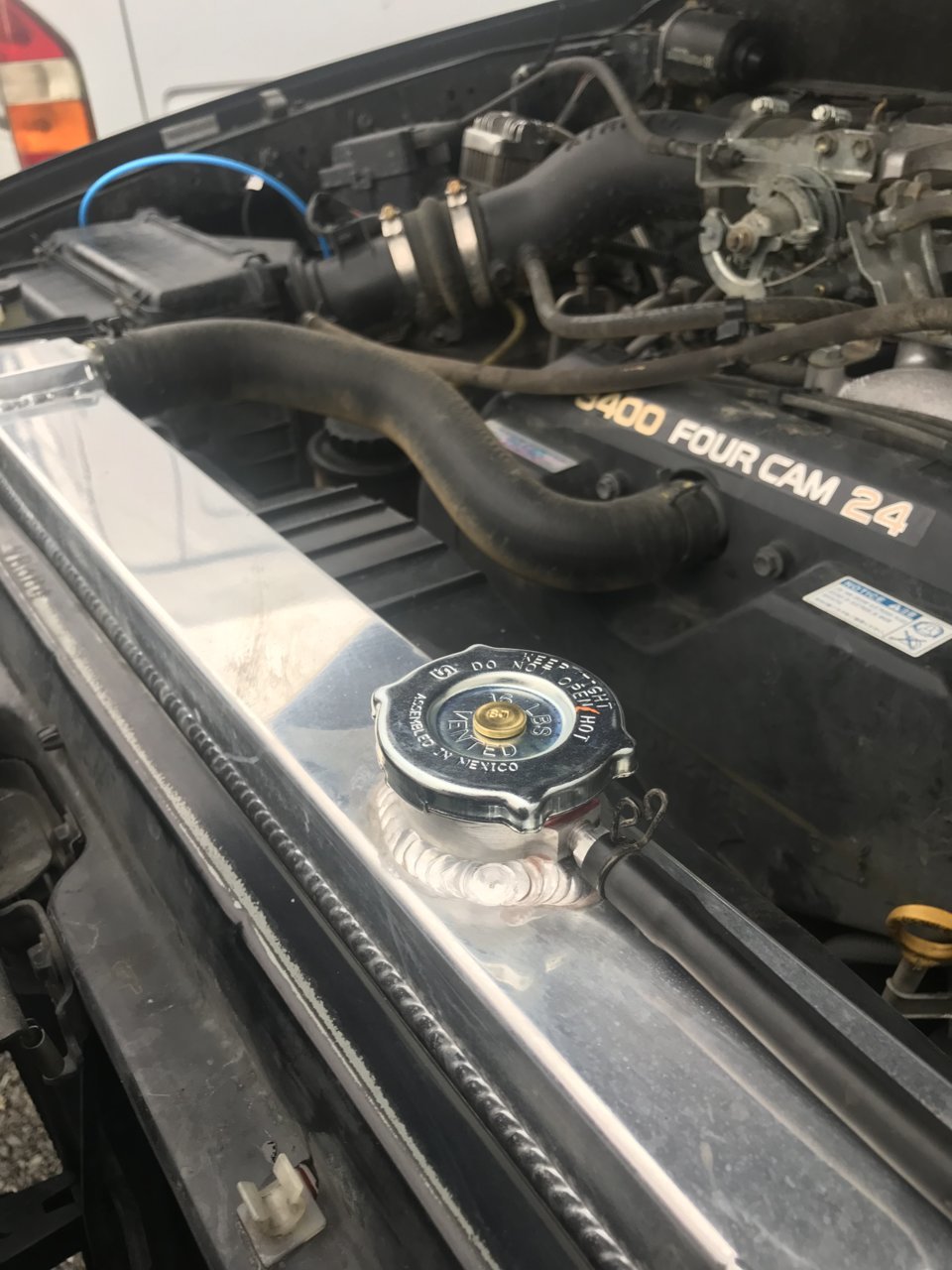

    Just replaced mine today. Here are a few pictures.

    After digging through what feels like hundreds of websites, I found one that said this Stant 10231 (and therefore probably the CarQuest 10231 as well) can be used on multiple sized filler necks to include 1.69" (43mm) O.D., 2.69" (68mm) O.D. and 2.23" (56mm) O.D. So maybe Champion didn't change the filler neck size - only the location.

    It Is What it is ---- Well if you look at the 1st Gen True Tacoma, 3.4 the Rad filler hole is OFF-SET, Plastic filler hole. It would be nice to have the filler hole center-Line. O'well Champion has a Great Warranty Program.
    Only issue I see, is the filling process/ time, if it really impedes the orifice, as you can see in my photos, got some SLAG DEBRI left over in the bottom of the filler hole. Going to keep this Rad, and hold Champion to its word!.

    So I just picked up the CarQuest 10231 and it doesn't fit this new radiator - it's too big. Now I'm wondering if the radiator will even fit our 1st gen Tacomas since Champion has obviously made so many changes. Has anyone with a newer CC1778 installed theirs yet?
    After searching for hours last night, I wasn't able to find any 16psi caps in the 44mm size so if this is the new design going forward we'll be stuck with the factory type 13psi caps.

    I just received my cap in the mail and can confirm the same, the stant 10231 does not fit the new champion radiators. Bummer!

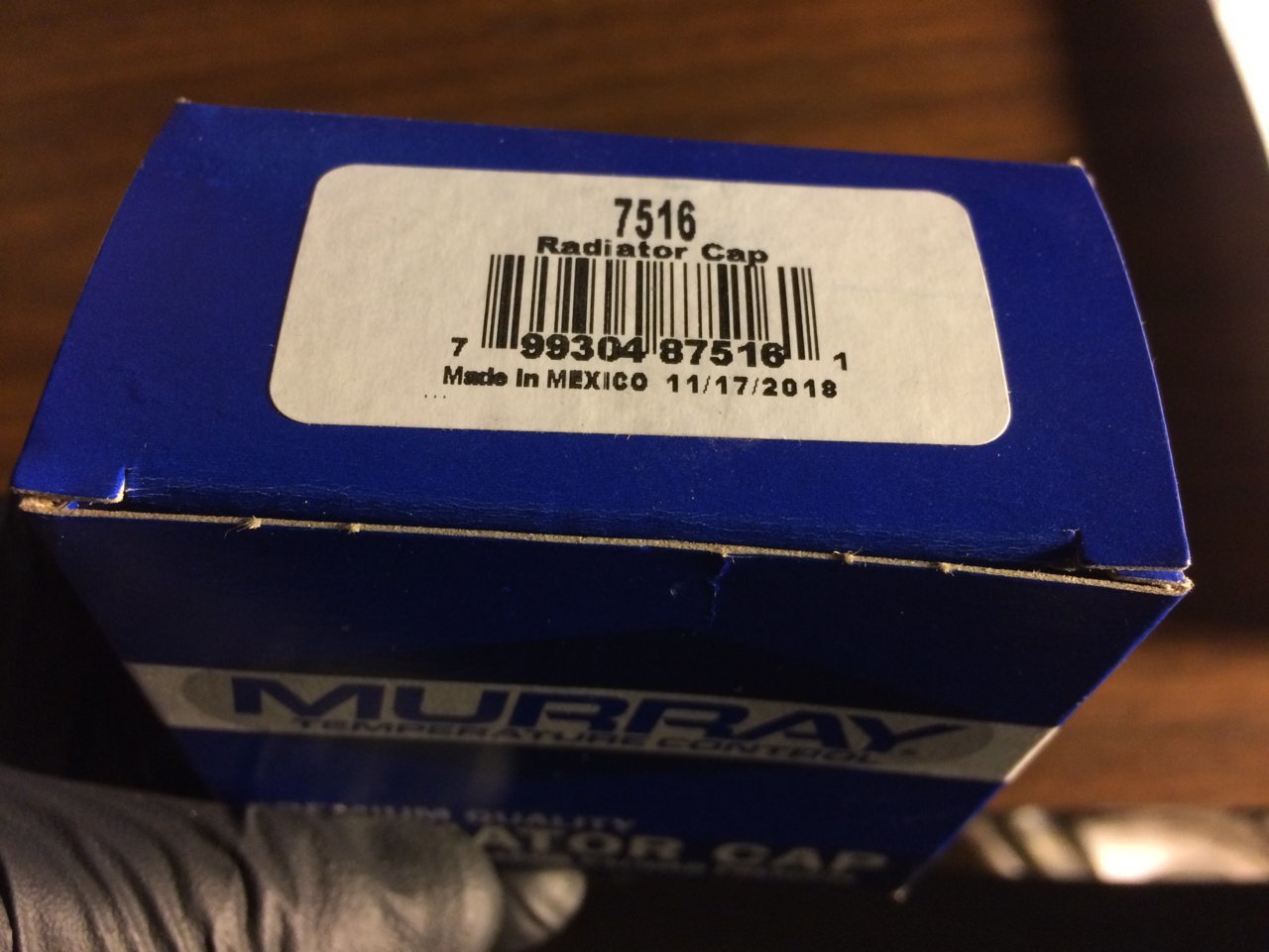

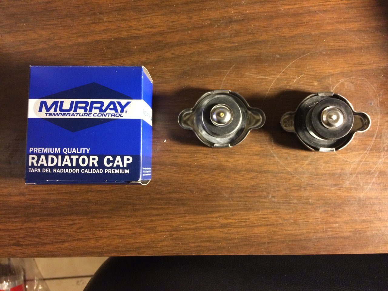

    https://www.oreillyauto.com/detail/...ture-control-16-psi-radiator-cap/7516/4435985

    Oh wow I can't believe they asked if you took the old one out to just check :facepalm:

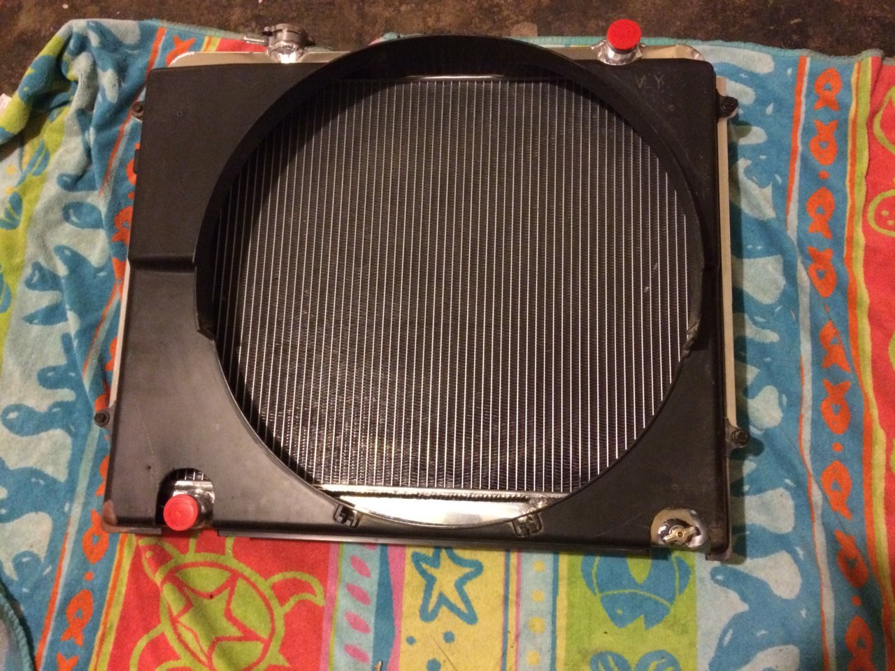

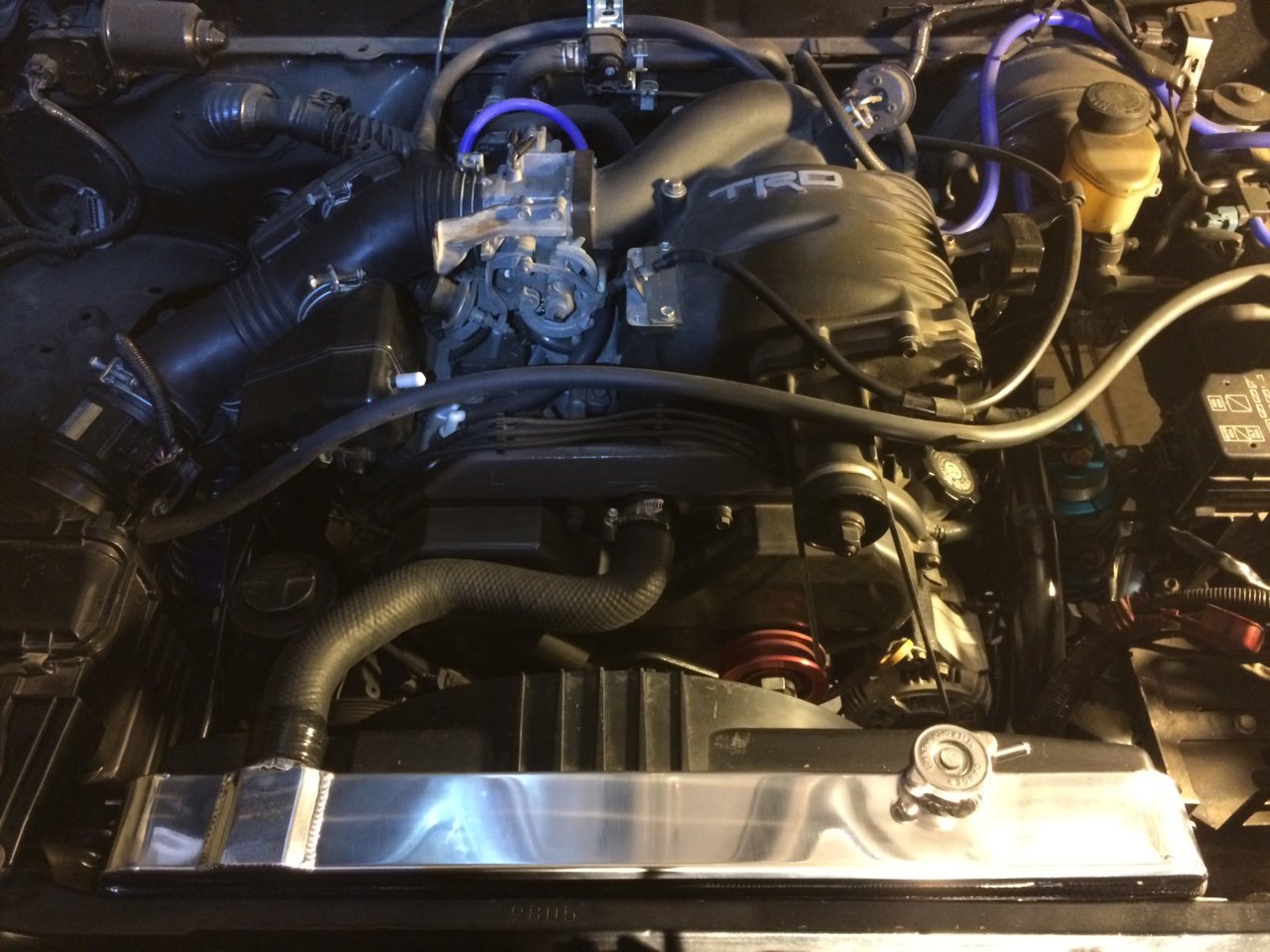

    How’s it working out for you? Everything fit the same and does the fill port offset help or interfere with anything?

    Haven't filled it with coolant yet. Lined up fine and the part of the hood that comes down to the core support would be nowhere near the cap if it was in the middle of the radiator.

    Even if the fill neck is not in the right place as before the benefits of this radiator will be huge. No plastic parts, 3 core instead of 1 core, more antifreeze in the system.
    The biggest problem with these toyota motors in the aluminum heads and this radiator will keep
    the temps much cooler than the stock radiator and added clearance for those needing it Being that it does not drop down below the frame

    Lining it up against the old one, it basically ends at the bottom where the lower plastic tank begins on the stock style tanks.
