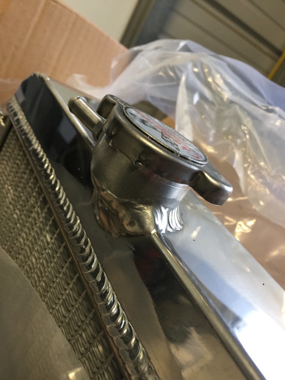

    That different fill port location being off-center is the same as the Denso replacement radiator in my truck. I don't understand why it's such a big issue. The radiator will still function fine.

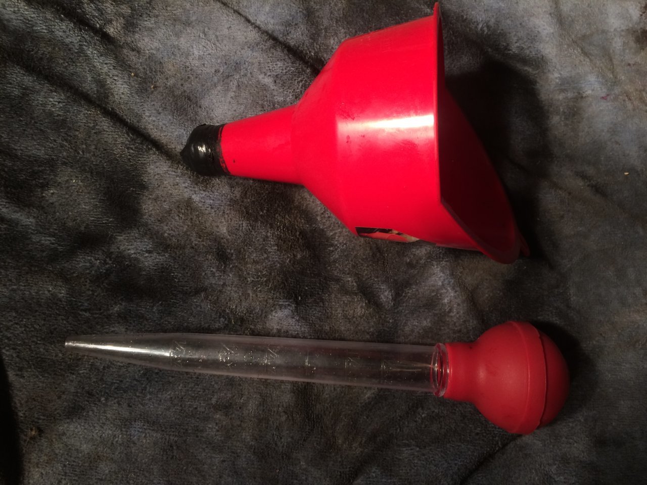

    I've been burping mine - took forever I think since the engine had been completely empty for over a year and the heater core had been open to the atmosphere for that long as well. Dealing with a high idle issue at the moment and with the truck on jackstands running 2300 rpm temps remaining consistent at 183-4

    Did you use the fill kit?
    Should have been quick and easy
    I use this kit and it makes everything soo quick and easy

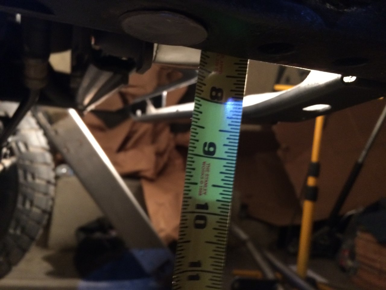

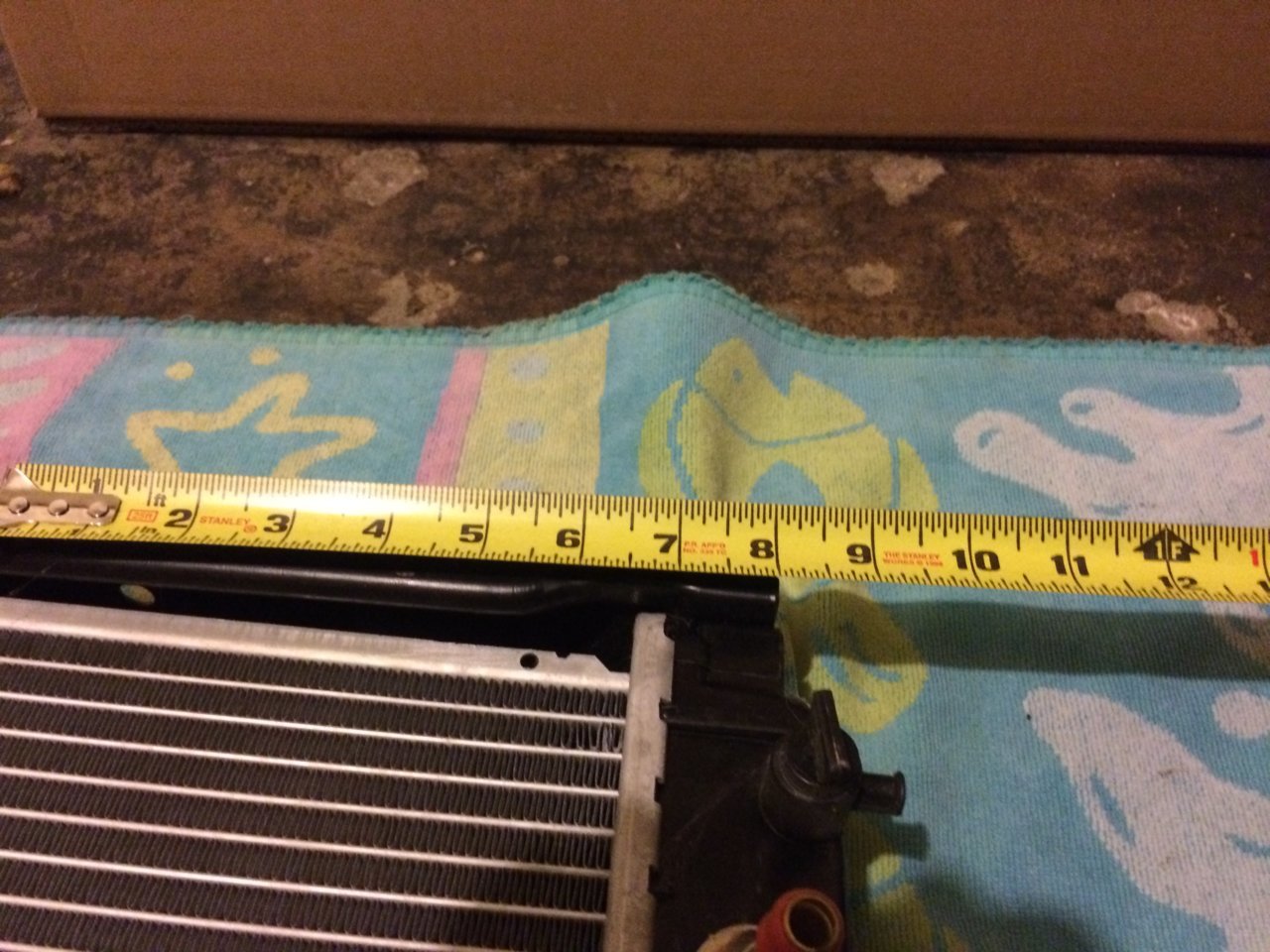

    @TacoJohn4x4
    Sorry let me post some pics
    Essentially it's roughly 1.5" shorter.
    I measured from the lower bolt hole and you can kind of see the radiator is almost flush with the lower edge of the frame.
