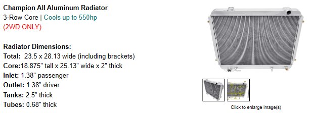

    "2WD ONLY"? This is shocking! Has anyone ask Champion why NOW it is only for 2WD? Is it not made well enough for rough terrain?

    its just the core size. the radiator is ment for a 2RZ 2wd truck.. doesnt mean it wont fit ours. just a smaller core is all

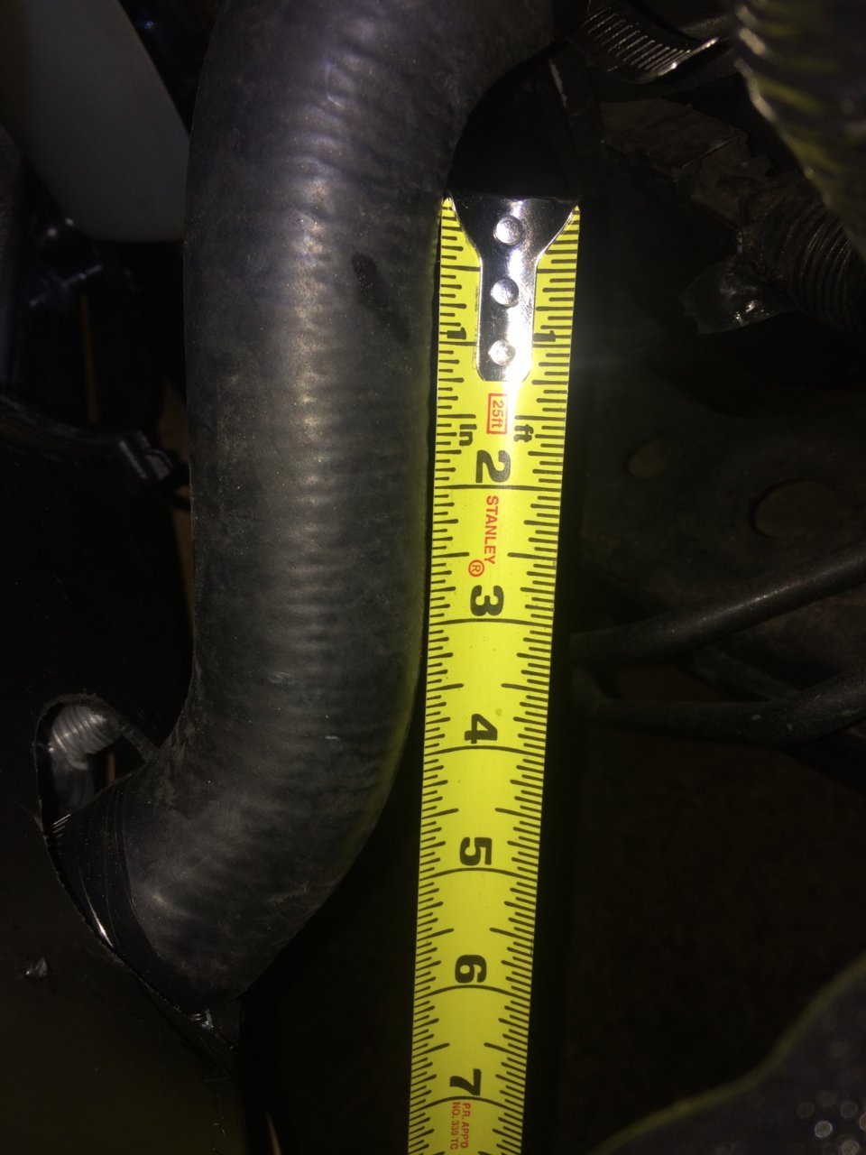

    In other news since i dont have a body to test this.. Who wants to give 16572-07030 and try and see if its a direct for the 5vz and champion radiator. Its the lower Hose for a 5 lug 5vz truck (which use the smaller radiator i do believe)

    the lower one in the picture is the hose ive found.. its shorter than the factory 4x4 one for sure
