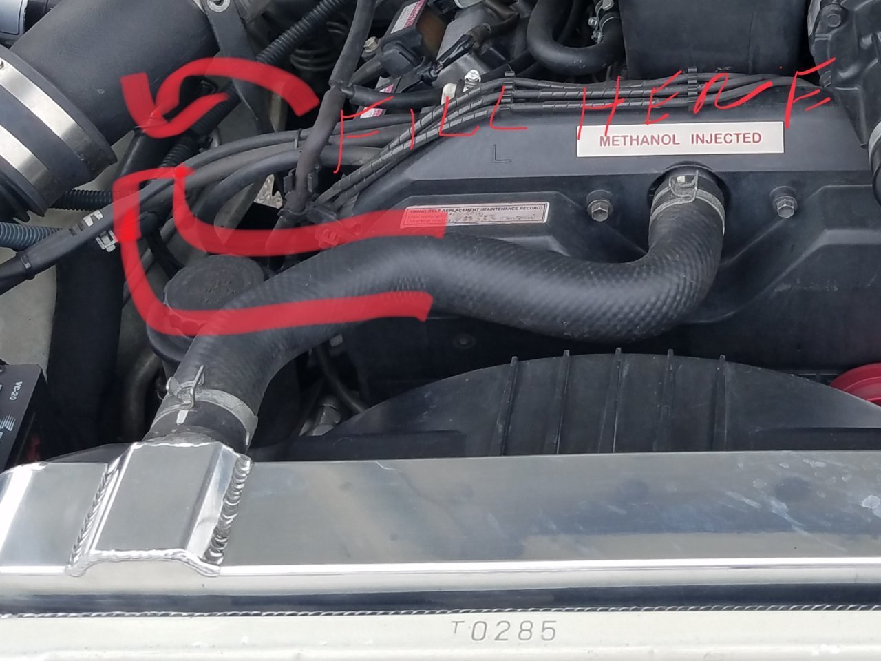

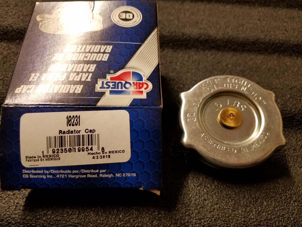

    I think @pullingin said the new radiator filler neck is a different size and needs a different radiator cap.
    You can use the same stock upper radiator hose.
    Just make sure you fill the engine side of the radiator by bending the upper radiator hose backwards up in the air and filling from that hose, then reconnect and then fill the radiator side and make sure the heater core valve is open (cable)
    https://www.oreillyauto.com/detail/...ture-control-16-psi-radiator-cap/7516/4435985

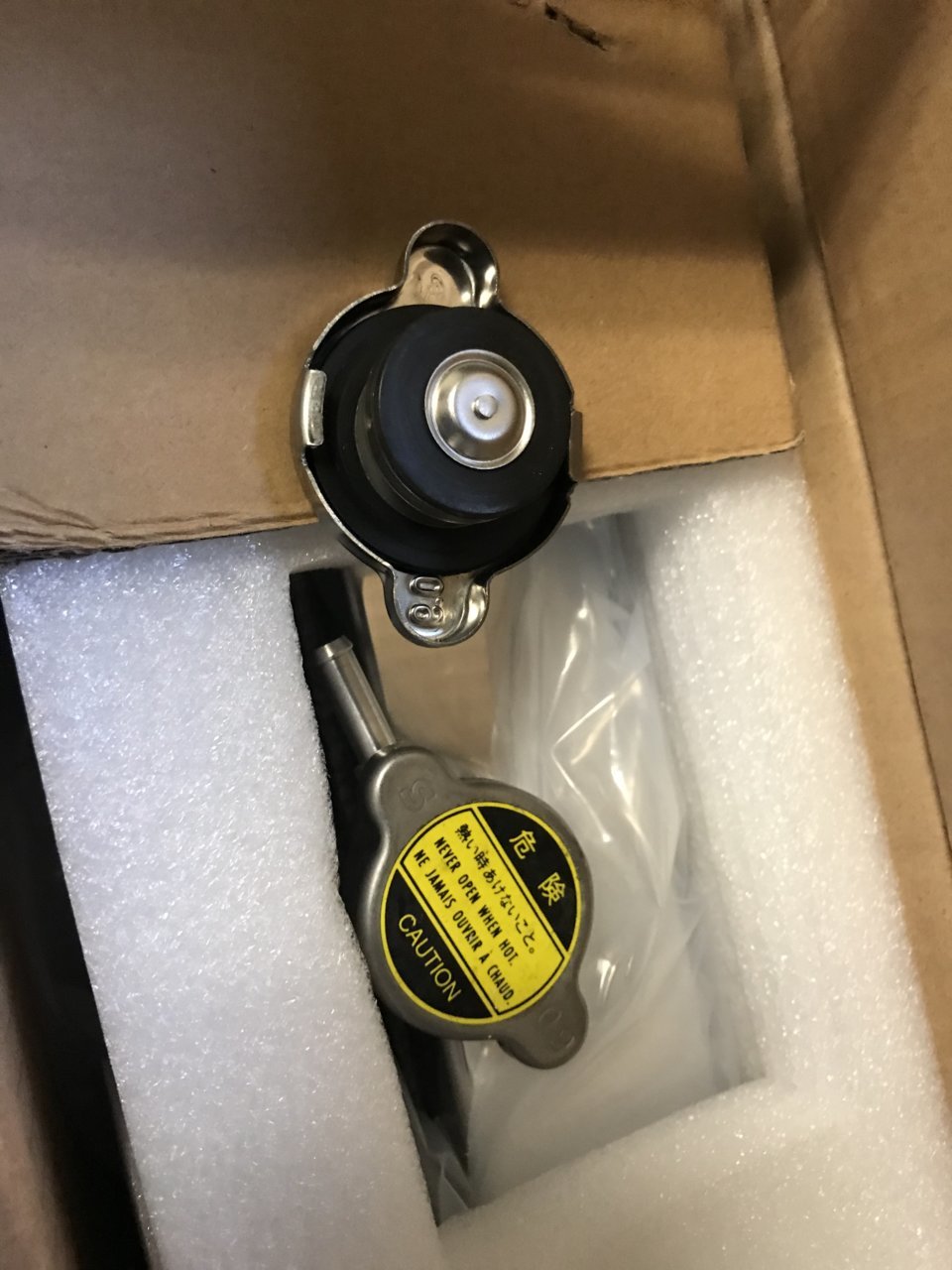

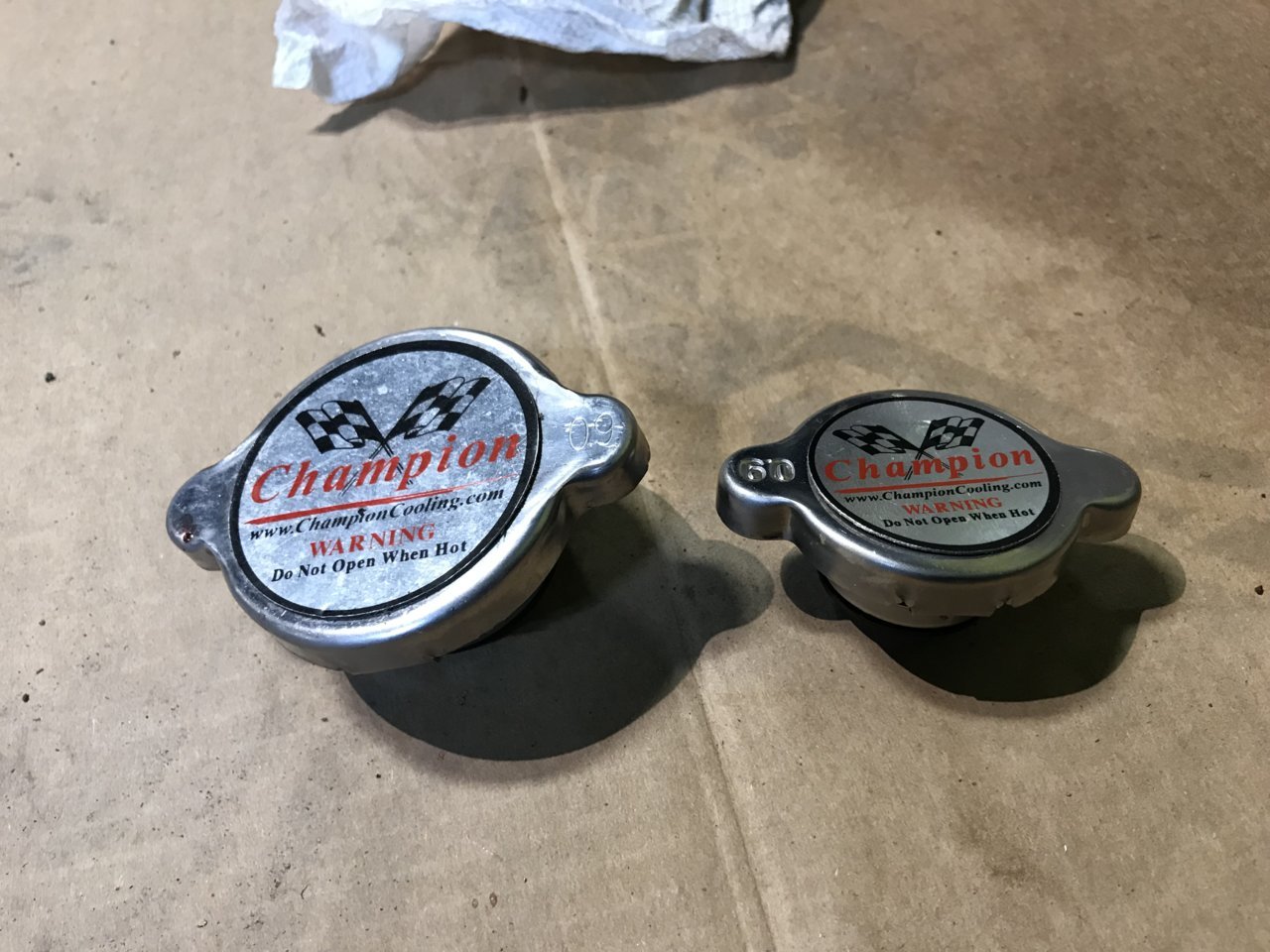

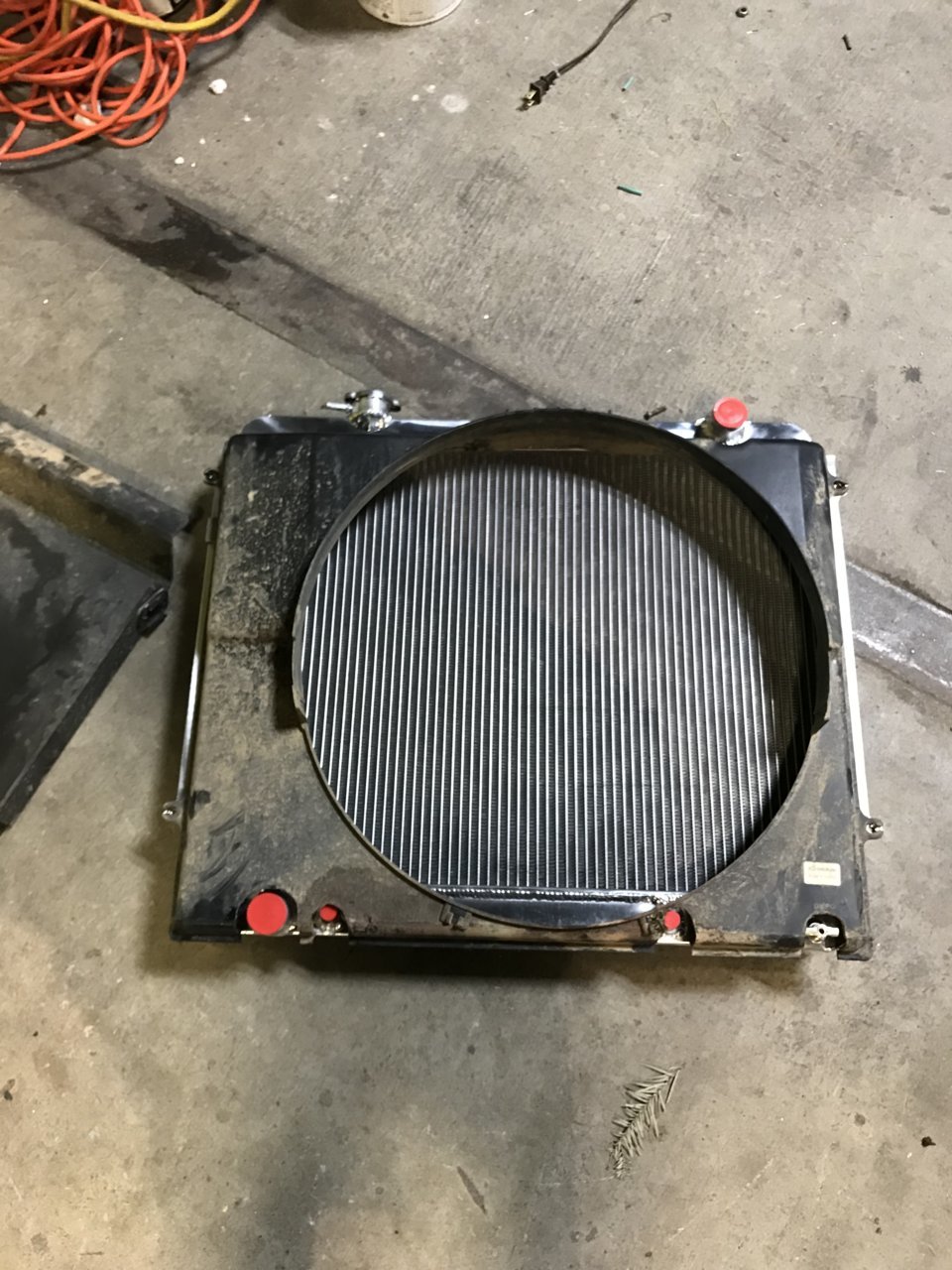

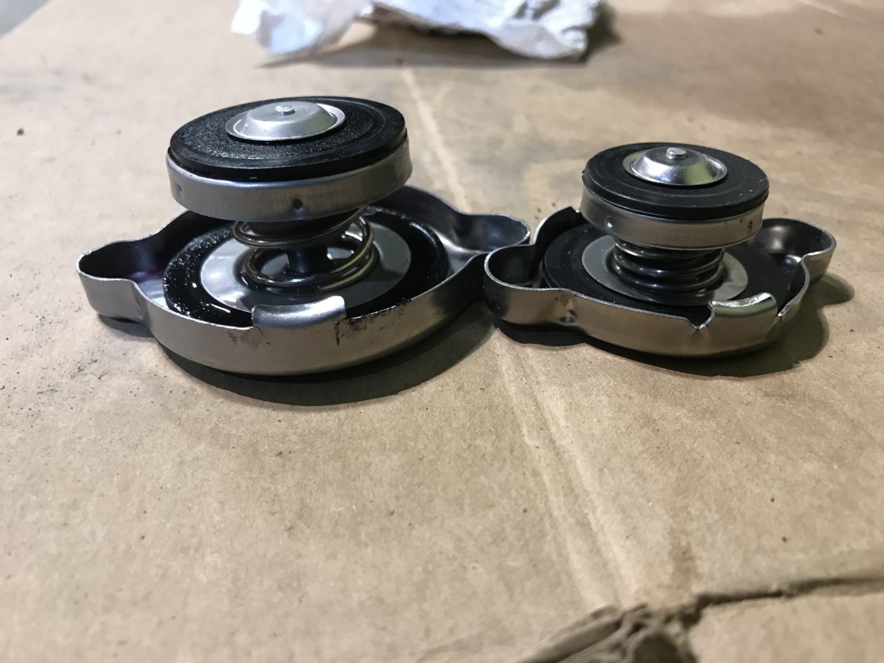

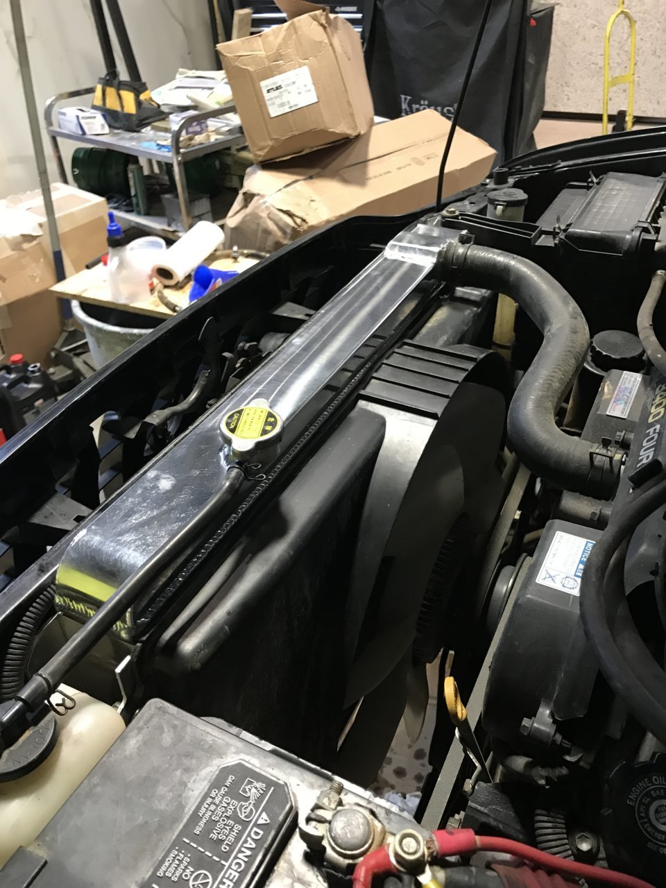

    Replaced my old style radiator with the new style. So far no leaks, also a few updates the new radiator cap is much smaller then the older style but the good news is that the stock radiator cap fits the new style radiator. Here are a few pictures of the install.
    As far as the warrenty I still need to ship back the old one for them to let me know if the prepaid amount will be refunded (not including the both way shipping) will let y’all know how that goes.

    Looks like that will work just fine!

    It's a radiator cap, not a purse. Who cares what it looks like so long as it keeps the coolant where it is supposed to be, at the correct pressure?
    If it's this big an issue, find a shop to weld the bung on straight. Problem solved.
