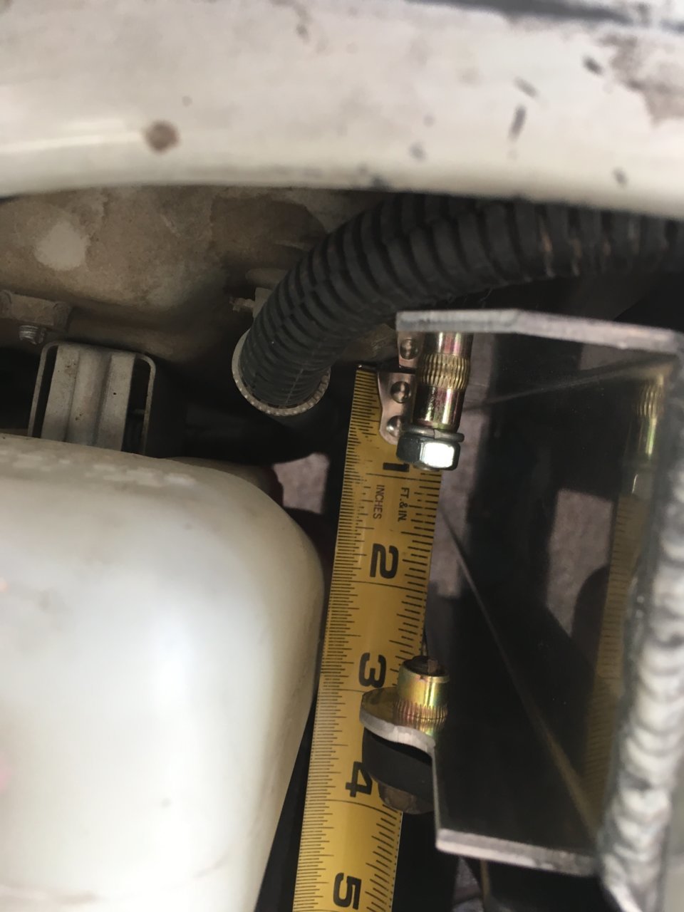

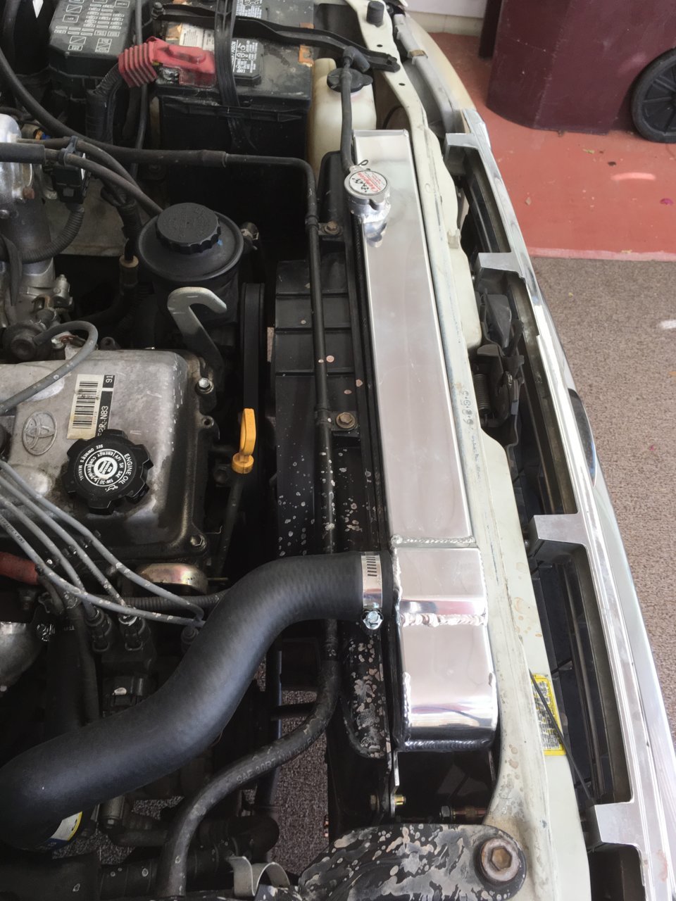

    Hey kids, I found that the factory mounting bolts seem to barley catch in the Champion nut zerts. I am going to buy longer bolts today. I am thinking of getting them long enough to go past the end of the nut zert and add a nut to the end. There's plenty of room for it. What are your thoughts?

    Had the same issue. Buying longer bolts today.

    Sorry I threw away the info. I believe they were M-8? I just took one down to the hardware store. Here's some pics.

    The ones that hold the rad to the core support should be m8x1.25, the ones that hold the fan duct on should be m6x1.0
