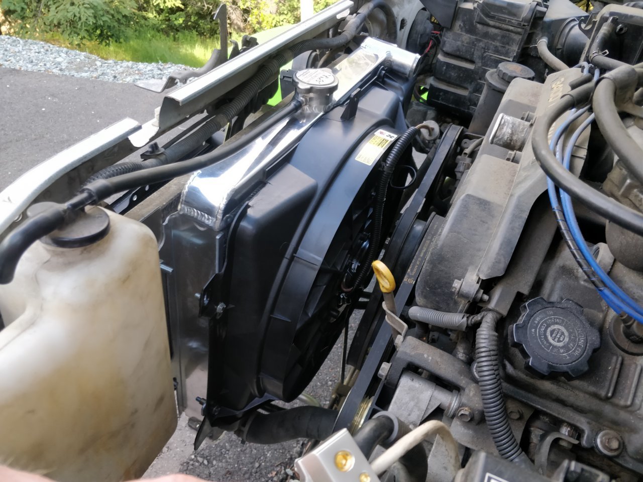

    What electric fan is that?

    It's a 3.8 (I think) v8 older ford Taurus fan. The swap is very popular for 22re guys so I just bought one brand new for around $80. Has two speeds, can hardly get the truck to operating temp if I leave it on high speed. Great fan for the setup

    Another good electric fan is the 97 Dodge Intrepid fan.
