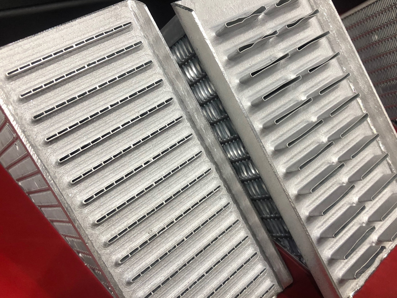

    Probably going to have one made with Extruded Cooling Tubes (ECT).
    This is an old technology but new to having it added to the radiator and is far superior.

    The Extruded Cooling Tube design are rated at 60-100 pounds and are made of much higher quality thicker aluminum.

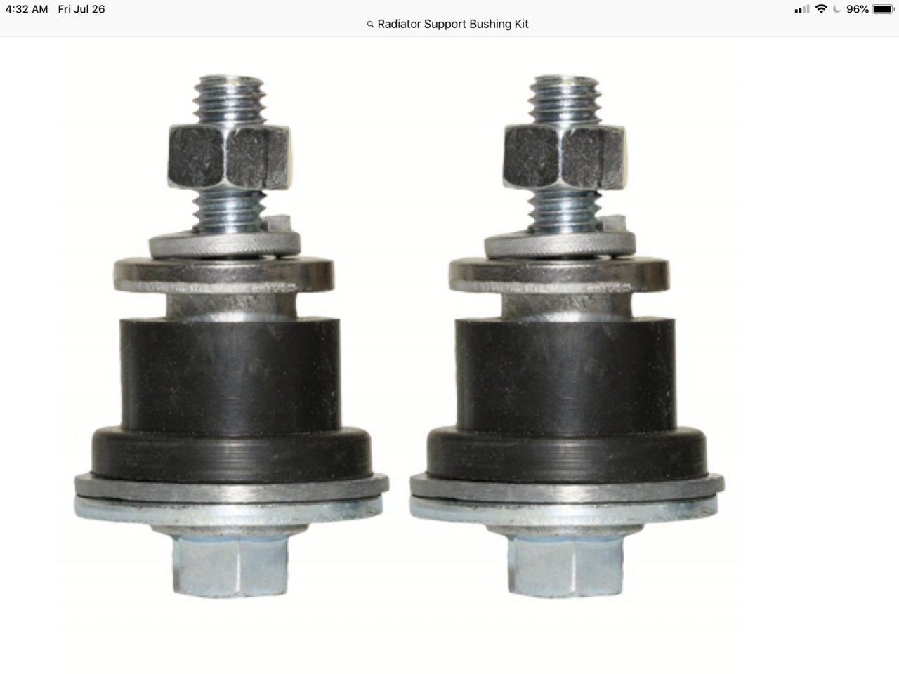

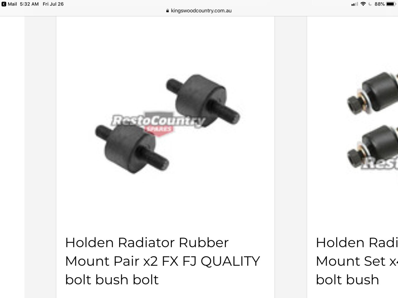

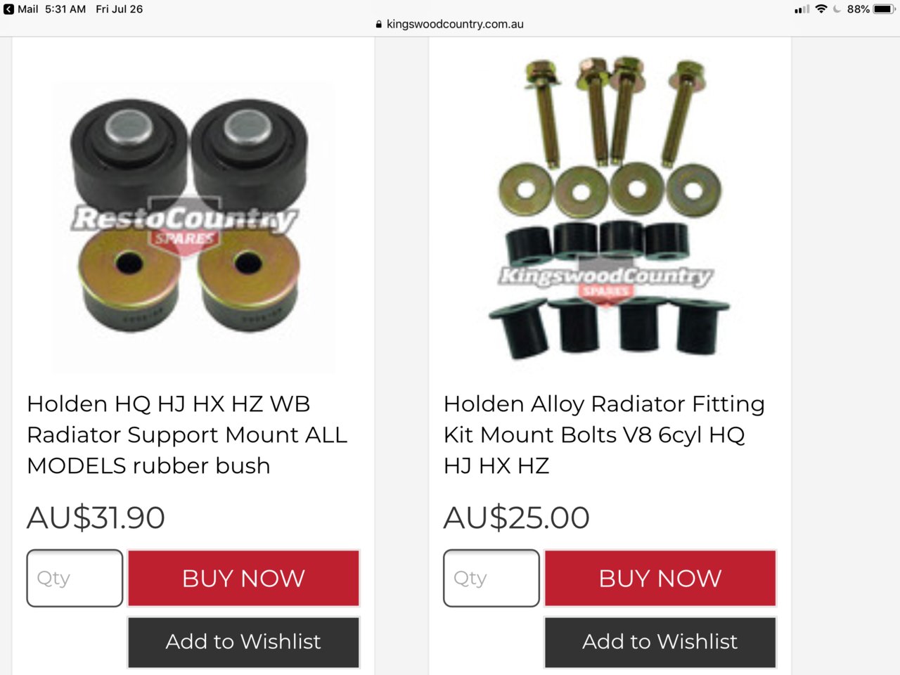

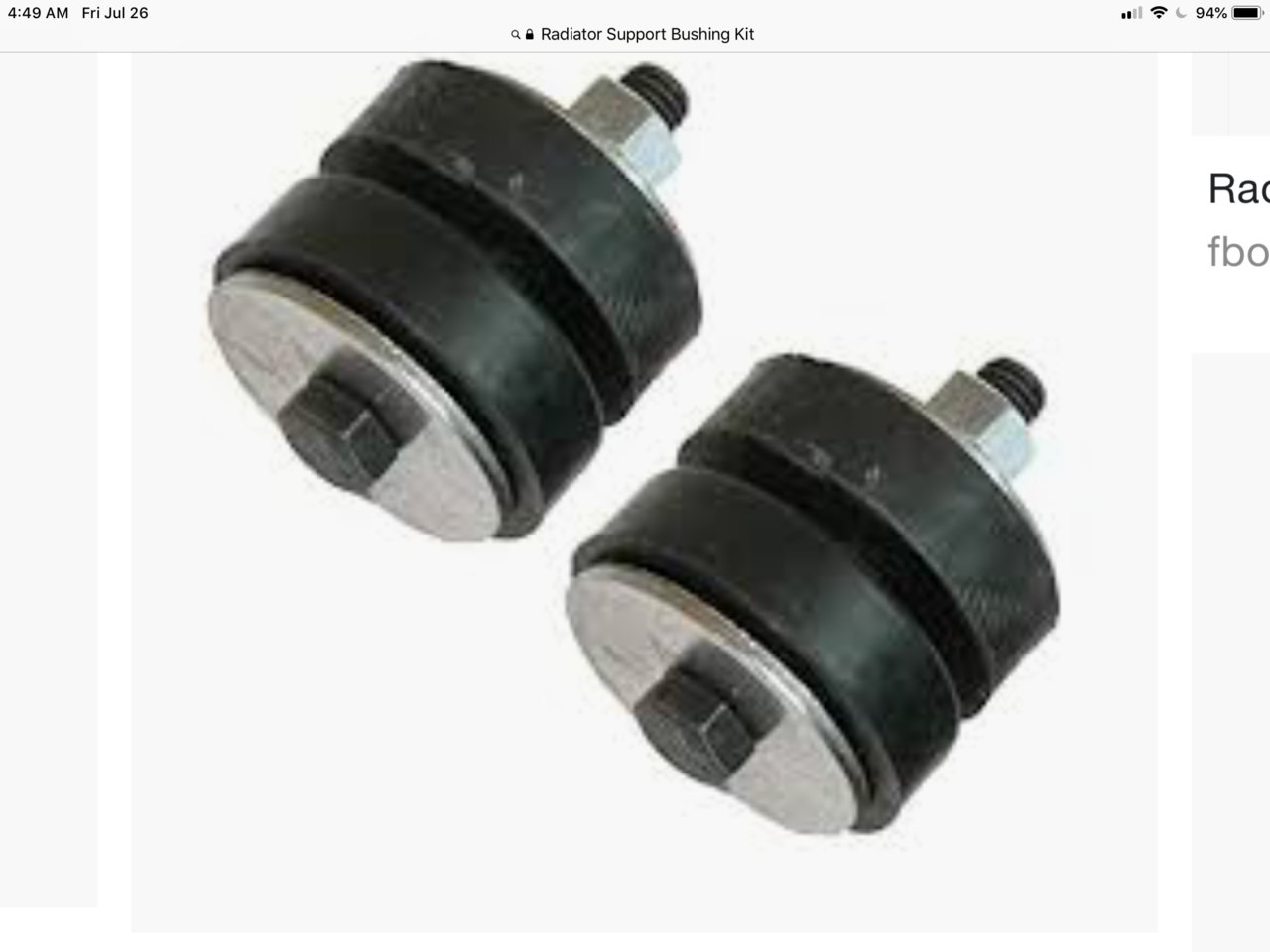

    Has anyone done a radiator bushing kit or modification? So that the radiator has some flexibility instead
    of a direct solid bolt mount.
    If so what type bushing or setup did you go with.

    Could be because the Tacoma’s do not have radiator bushings. Possibly a simple fix with adding
    bushing to either side or one side of the radiator and the mount so the radiator can flex a bit. I think most vehicles have radiator bushings.
