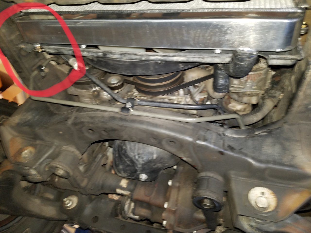

    If you have the 3.4 motor you want the shroud that came with the 5 speed model not the automatic shroud as it’s 2” taller.
    You still will need to trim the shroud for the peacock and lower radiator hose
    and if you have an automatic transmission you will need to make cutouts for the lines

    Nah I did mine with the shroud on. The bottom half of the part that wraps around the should just comes off. Held on by two clips. I didn't have an issue putting it on with the shroud and connecting all the lines

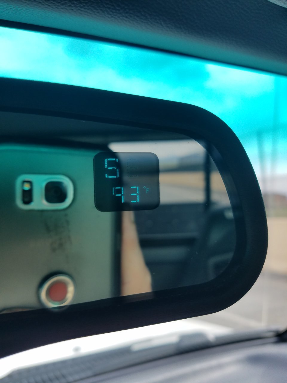

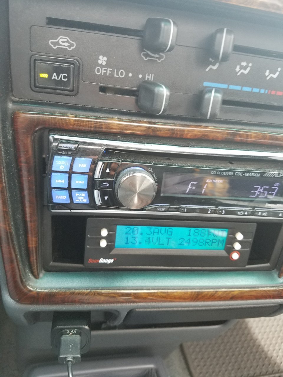

    New radiator performance for me is wonderful
    93 degrees outside
    AC on full blast
    20 mpg
    Radiator temperature at 188
    I will check back when temps hit 100 outside
    Thumbs up

    Drove 40 miles both ways from 7000 feet to 8500 feet. Idle temp was 188° and driving temp was 186°. Hottest it got climbing hills was 188°.
    Fuel mileage was around 22 mpg average after newMAF.
    1997tacomav6[OP] likes this.

    Yup, those are about the same numbers I’m running now,
    Perfect
