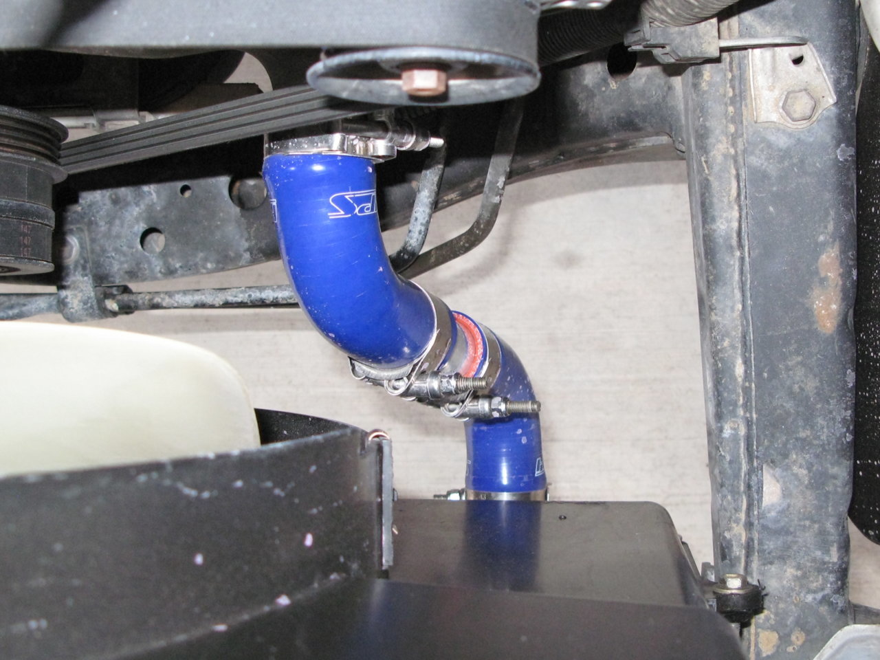

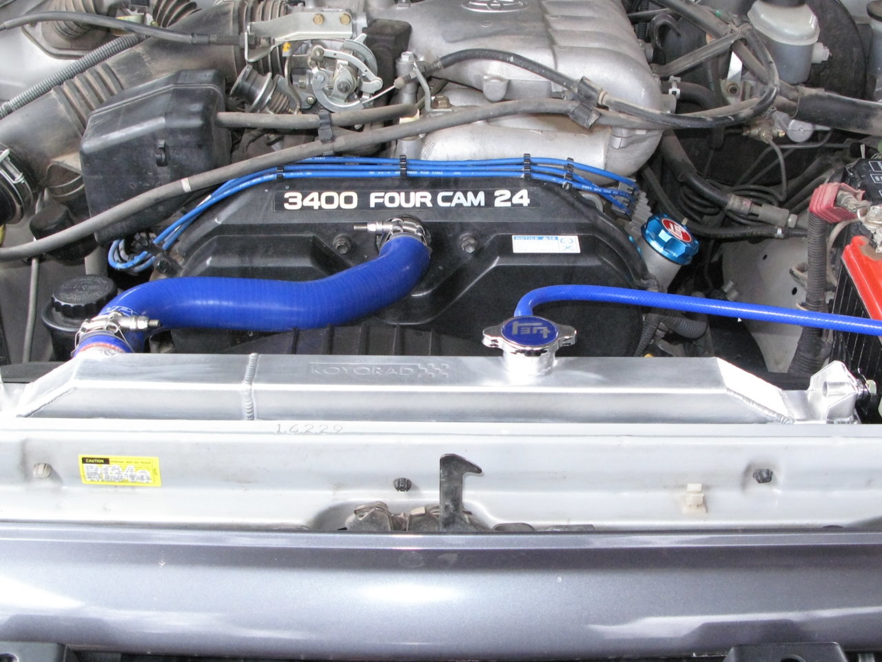

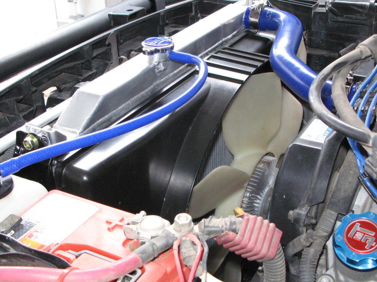

    Hello I just wanted to share with you my recent radiator swap. My truck is at just under 190,000 and the top tank split just after I did the oil change and grease job in November. I have been out of work on medical leave and thought this was a good time to start on it. I had wait till after January 6 to order the radiator. I followed the route of STLharry and ordered a Koyorad radiator through Battle Born Offroad. It took a couple of weeks with UPS miss shipping the radiator for 3 days, I did get the cap on time. I had prepared the truck with system flush and cleaning as old radiator sprayed the engine compartment good. I have a ARB bumper and decided to not remove bumper, winch and grill. I used 1/4 drive with a 6" extention and lots of patience, and it worked just fine. The radiator lined up and I only had to curse one bolt for a moment but all went good. The only problem was the radiator being taller the bottom hose was about 2" short. My solution was to cut lower hose in the middle and add an aluminum extension. I also changed hose clamps to t-bar clamps. I have had no problems yet and I hope this is the best way to go. I will include some pics and keep forum informed of any future problems.

    Looks good so far, that looks like a 4runner top tank which probably will not fit the 1995-2000 hood tho.

    yes the radiator is listed for a 4 runner. I forgot to mention it, sorry.
