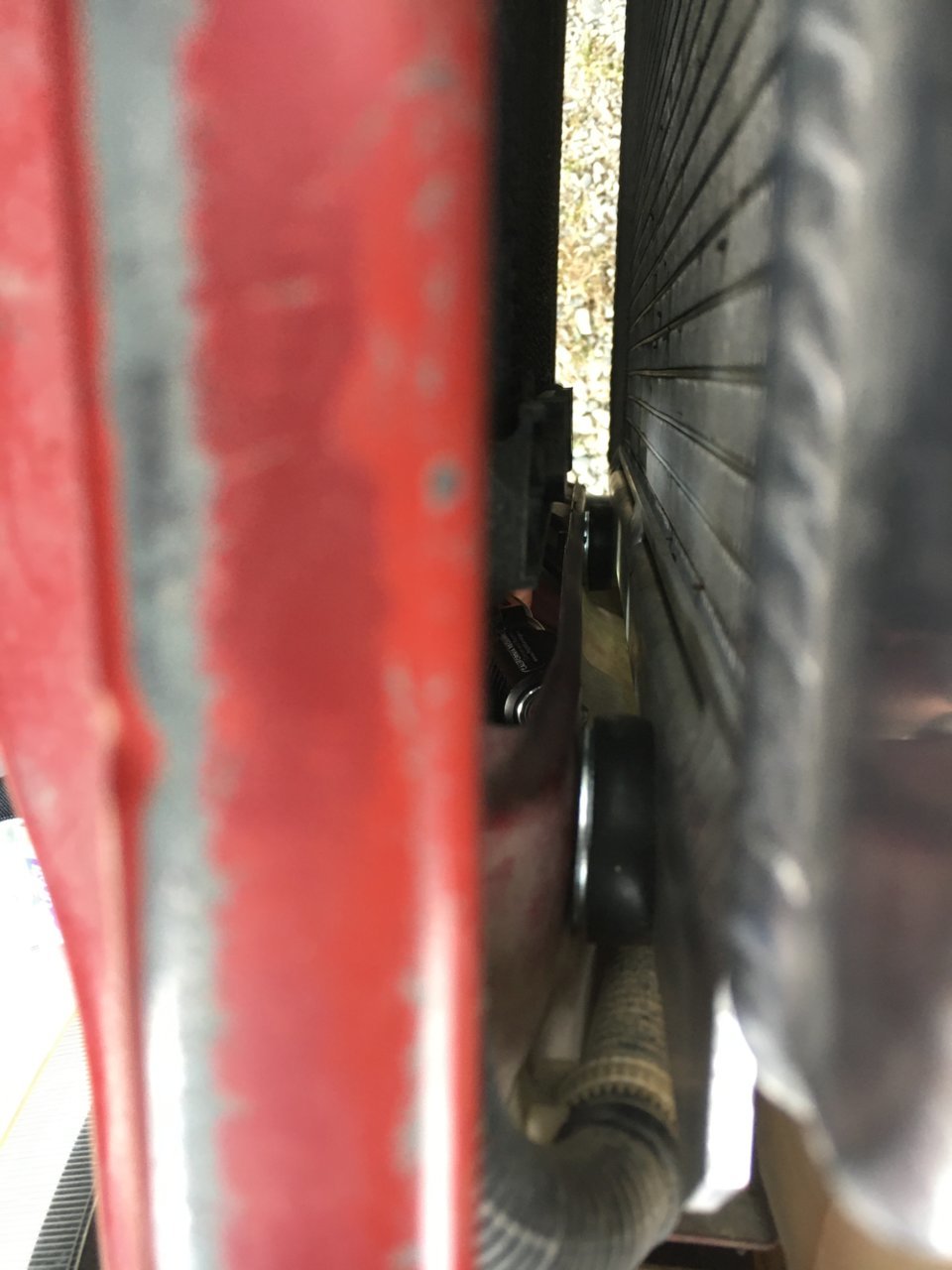

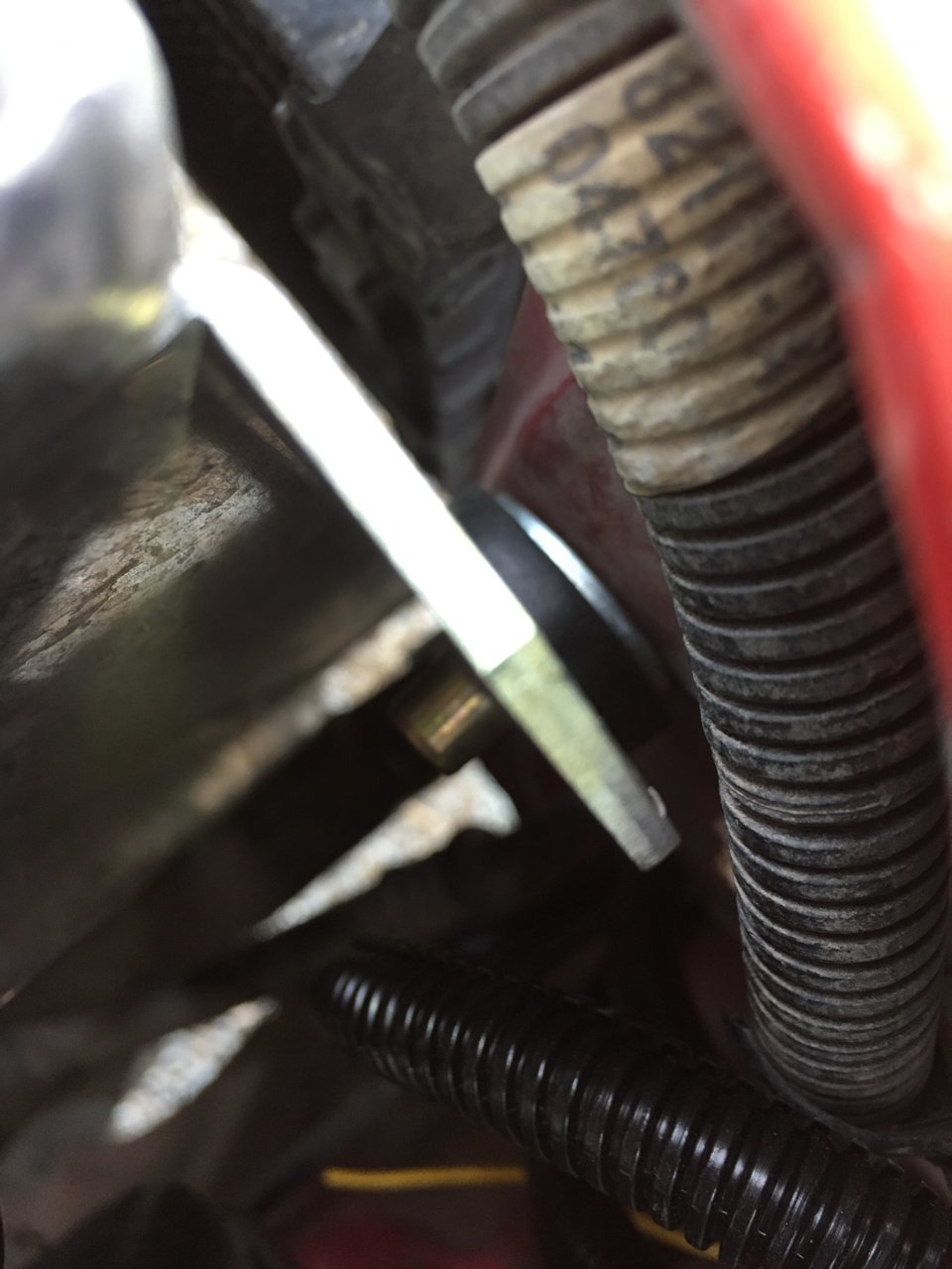

    I found some bushings at Amazon:
    $15 Hard-to-Find Fastener 014973175368 Bushings, 3/8 x 1-1/4", 5-Piece
    https://www.amazon.com/gp/product/B00OP3C614/ref=ppx_yo_dt_b_asin_title_o07_s00?ie=UTF8&psc=1
    Added some washers and M8-1.25 x 30mm bolts so maybe that will help it last longer.
    Talking with some techs at a radiator place, they thought the brackets might not be welded on in enough spot- just tacked and the thicker core can’t flex as much. So I figured I would try some bushings like the Hillmans above and start the search for something as a back up/ replacement maybe a Koyorad # http://battlebornoffroad.net/battle-born-offroad-specials/koyo-radiators/vh010665n/i-7532947.aspx
    Or this one:
    https://www.radiatorexpress.com/Product/radiator/toyota/2001/4runner/base/34l-v6/222485/1375163
    Still looking at this time- the Champion isn’t leaking yet but with a trip up the AlCan in a couple months....
