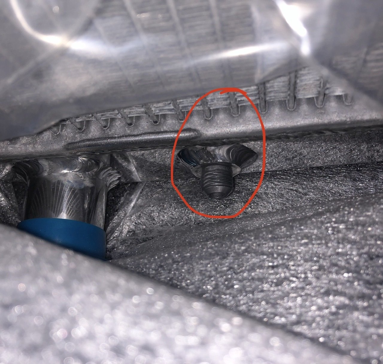

    For those with the champion radiator, did they come with the trans cooler fittings? Mine did not come with fittings. Just male AN fittings. Do you reuse the OEM fittings? If not, does anyone know what size these are?

    Mine came with them
    Check around in the bottom of the box they could be floating around down there
    they should’ve been in a plastic bag taped to the radiator.
    If not, call Champion and let them know.
    i’m sure they’ll send you some new ones free of charge.

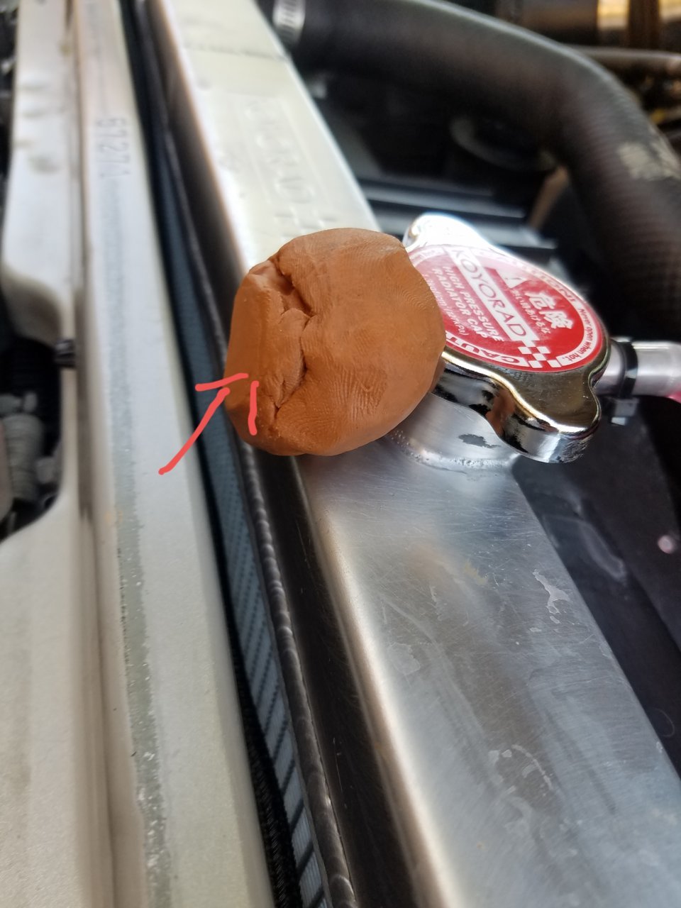

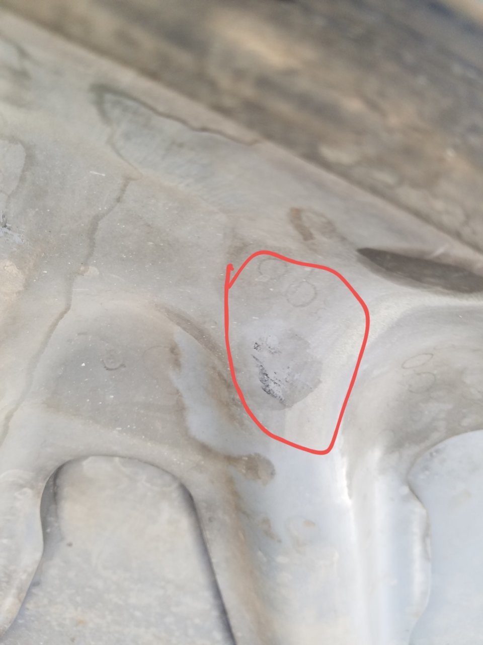

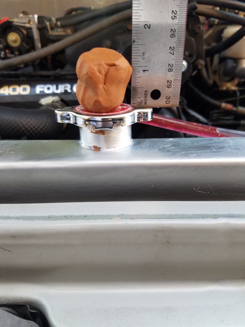

    Was anyone tried the Koyorad in the 2000 and older trucks? There would have to be a huge difference in the hood for the radiator not to work. Here's a few pics of a clay test I did on my 2004. Also the Koyorad doesn't hang any lower then the stock auto trans radiator. Fan shroud lines up perfectly.
    Touched a spot on the front edge.
