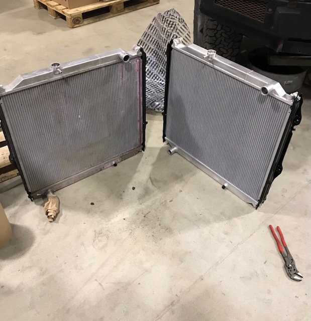

    I stuck an update into my post from before after receiving a warranty replacement.

    Check the radiator hoses for leaks! I did have a warranty failure, but after installing the replacement I was still leaking coolant. Turned out to be my fault for under-tightening the hose clamps.
    FYI- The first radiator failed right where a column of fins attaches to the upper tank. Rear-facing, drivers's side, upper corner. Verified with a pressure tester and soapy water after I replaced it.
    Overall it's really too bad, though. The Koyorad Racing radiator seemed like a great replacement for the frequent-failure Champion units while also offering improved cooling. I can attest to the improved cooling- both with aftermarket coolant temp and EGT gauges.

    That's VERY interesting. I think I'd rather use the OEM-recommended fluid and a stock radiator than the Champion with green coolant, then.
    FYI Koyorad Racing says to use OEM-recommended fluid.
    What type of fluid, coolant or antifreeze does Koyorad recommend?
    50/50 coolant antifreeze mix is mandatory. Use OEM manufacturer's recommended coolant. Note: Coolant additives do not contain the necessary anti-corrosion properties as 50/50 coolant antifreeze mix. Coolant additives should not be used. Prior to installation, a complete cooling system flush (including heater core flush) is mandatory in order to eliminate any old coolant, contaminants, mineral deposits, and previous additives. Dex-Cool is not to be used with Koyorad all-aluminum radiators. Follow vehicle factory service manual for proper filling of the cooling system after a Koyorad all-aluminim radiator has been installed. Reference vehicle owner's manual for coolant capacity, then 1 additional gallon on-hand to top-off.

    There is a third aluminum radiator option from Cold-Case now. Just not sure if it will be any better than the Champion or Koyorad. I called them today and wasn't convinced it was really stronger. All they could confirm was their test truck had been running it for 4 months. @1997tacomav6 is probably right and these things are too flimsy to hold up to any flexing. I'm just not sure I want to drill out my radiator support for a custom braced radiator that I can't guarantee I'll be able to purchase again down the road.

    You don’t drill out your radiator support, you use the oem holes,
    You may as well just keep replacing it then every 150k with an OEM type

    I was just referencing a post you made that said your custom one wasn't a direct fit. I might've misunderstood. I'm not afraid to drop $1000+ now if it saves me from replacing my radiator every 5 seconds.
    My issue with replacing with OEM type is that the original OEM radiator part numbers for our trucks are out of production. Denso doesn't make one of the same quality of the 15 year old stock one I removed in February. The new "OEM" standard just cools worse. Even when removing air from the system and running the same thermostat the truck just runs hot. So I took that rad out and put it in my project truck for now.

    1KZ motors NEED to be kept cool, which is why I went to the Koyorad Racing aluminum radiator. (Just search some combination of "1KZ" + "losing coolant/overheating/cracked head/etc" to find other forum threads on this topic). If it came to it I wouldn't be opposed to dropping in a fancy "custom" radiator, but I'd much prefer to keep everything as close to stock as possible. At least the Koyorad unit just bolts in (and thus could be replaced with a Denso unit in a pinch if I needed to.)
    x2 on current radiators for our trucks not measuring up to the original OEM units installed in the factory (made by Delphi/Harrison, I think).
