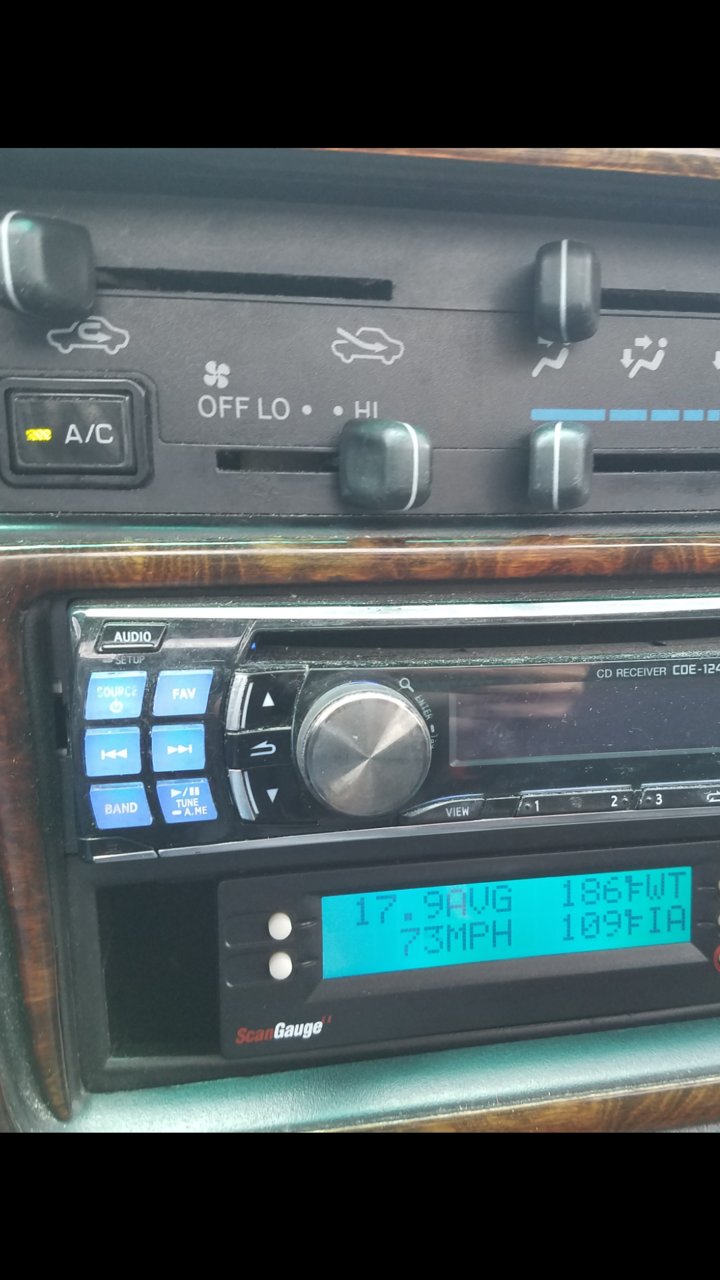

    This has to be up there as one of my best upgrades for the dollar.
    It’s 97 degress outside and the engine is as cool as a cucumber pushing 186°-188°
    with AC on full at 75 mph with a 185 stat. What more could anyone ask for.

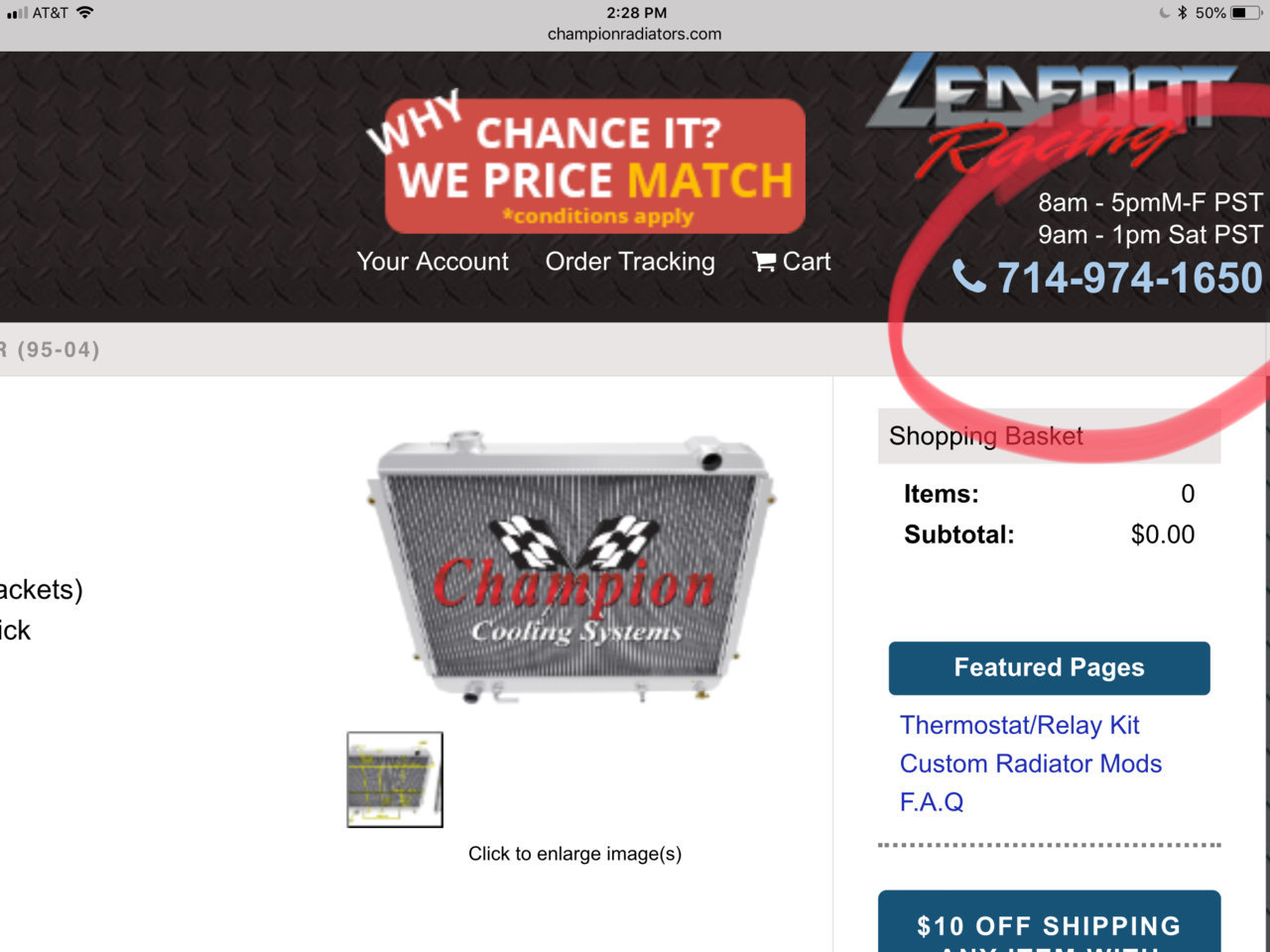

    Well looks like these are all sold out for now, geee I wonder why, :), none on eBay and the company says out of stock.
    I just talked to the guy and Will not have any more for 3 months,
    There is one left in the back George says.
    So if you need one now call ASAP or wait 3 more months.

    How do I get my scangauge II to pull coolant temps? I have it pulling AT temps already.
  11. Jun 14, 2018 at 4:38 PM
    #111
    1997tacomav6
    1997tacomav6 [OP] V6 5sp,RegCab,TVS1320 Supercharger,Haltech, 800k
    Oct 5, 2013
    #113940
    10,391
    John
    Denver
    97 reg cab, v6 5sp 300hp supercharged, Methonal Injection, 800,001 plus miles, Original Owner
    V6 5sp,RegCab,TVS1320 Supercharger, 56mm pulley, methanol injected Haltech ECU, AC Tvs1320 supercharger,(MUST DO) every 125,000- 150,000 needs rebuild Projector headlights HID 5 speed manual Amsoil for all drive train Smaller 56mm custom pulley, (MUST DO) 2004 DESNO fuel injectors, zero ping ping, 2004 side door mirrors Dick Cepek Rims, Michelin tires LTX, ATM Pathfinders Dynopro ATM ( that last 100,000 miles) Now running Dynopro ATM mud and snow tires KN cold air intake Cat back dual exhaust with ss exhaust tip, Raised exhaust tail pipe to 2" below body line Optima*dry cell battery,red top Alpine sirius radio, 200 watt amp, focal is165 split door pod speakers Focal door speakers Subwoffer behind seat Viper alarm, Electric Locks Dark tinted windows, bucket seats corbeau lg1 Tacoma Rubber floor mats TRD fender extenders, Bilstien shocks, King shocks JBA UCA trailer iv hitch, electric brake control, Drilled slotted brakes, High carbon steel (MUST DO) EBS green stuff 7000 series pads(MUST DO) TRD engine oil cap TRD stick shift, Marlin crawl shift kit. Rear sliding window 2002 4Runner functional hood scoop cut into Tacoma hood, 4Runner dual overhead map light Gentex Auto dim + Compass + Temp, garage,rearview mirror Snow Methonal kit stage 2 Custom 3 core aluminum radiator Linex bed liner Haltech stand alone ECU, Intake supercharger gauge. Stainless steel brake lines, Custom leather wrapped steering wheel, Haltech stand-alone ECU,
    The two top white buttons on either side just keep pressing till the engine temp shows, that’s all very easy
    You can pick engine temp as one and intake temp as another on one of the 4 buttons
    You DONT need to down load anything for temps

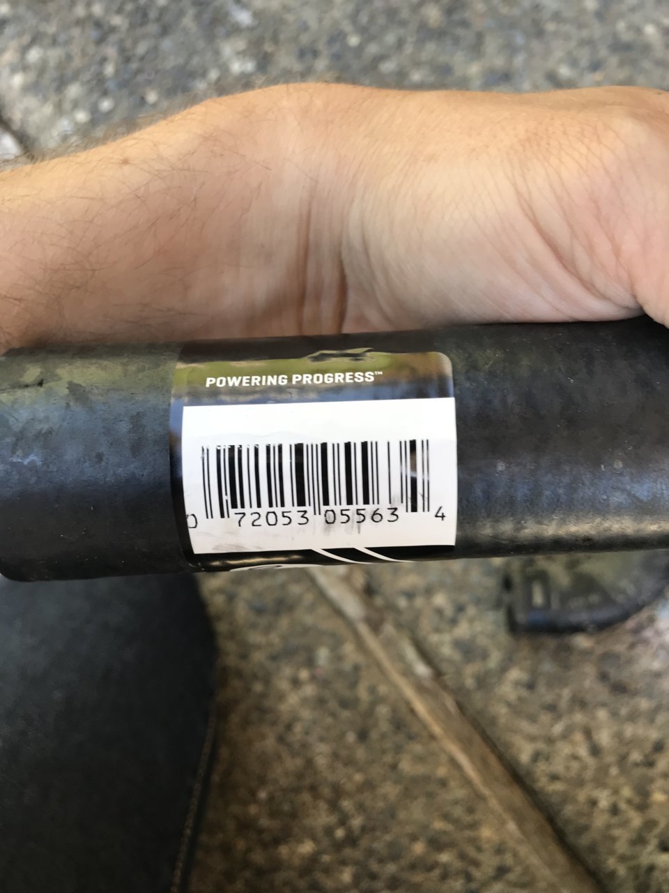

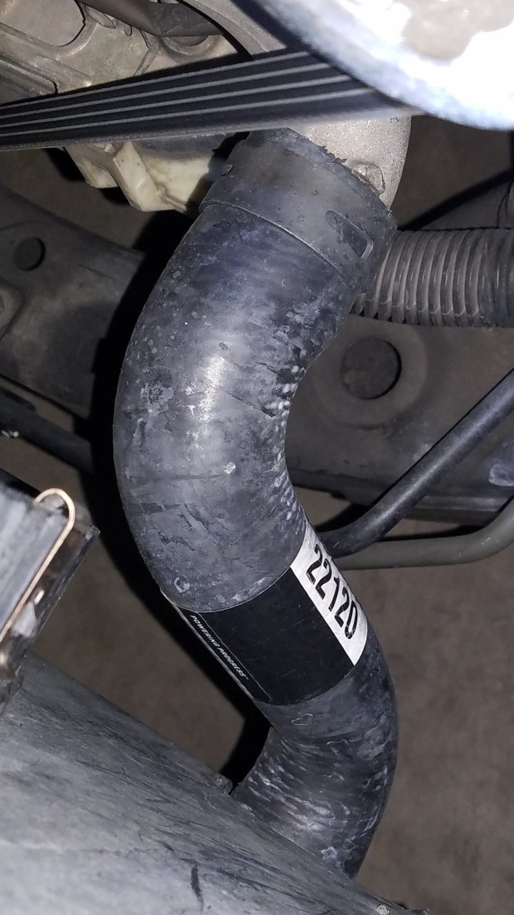

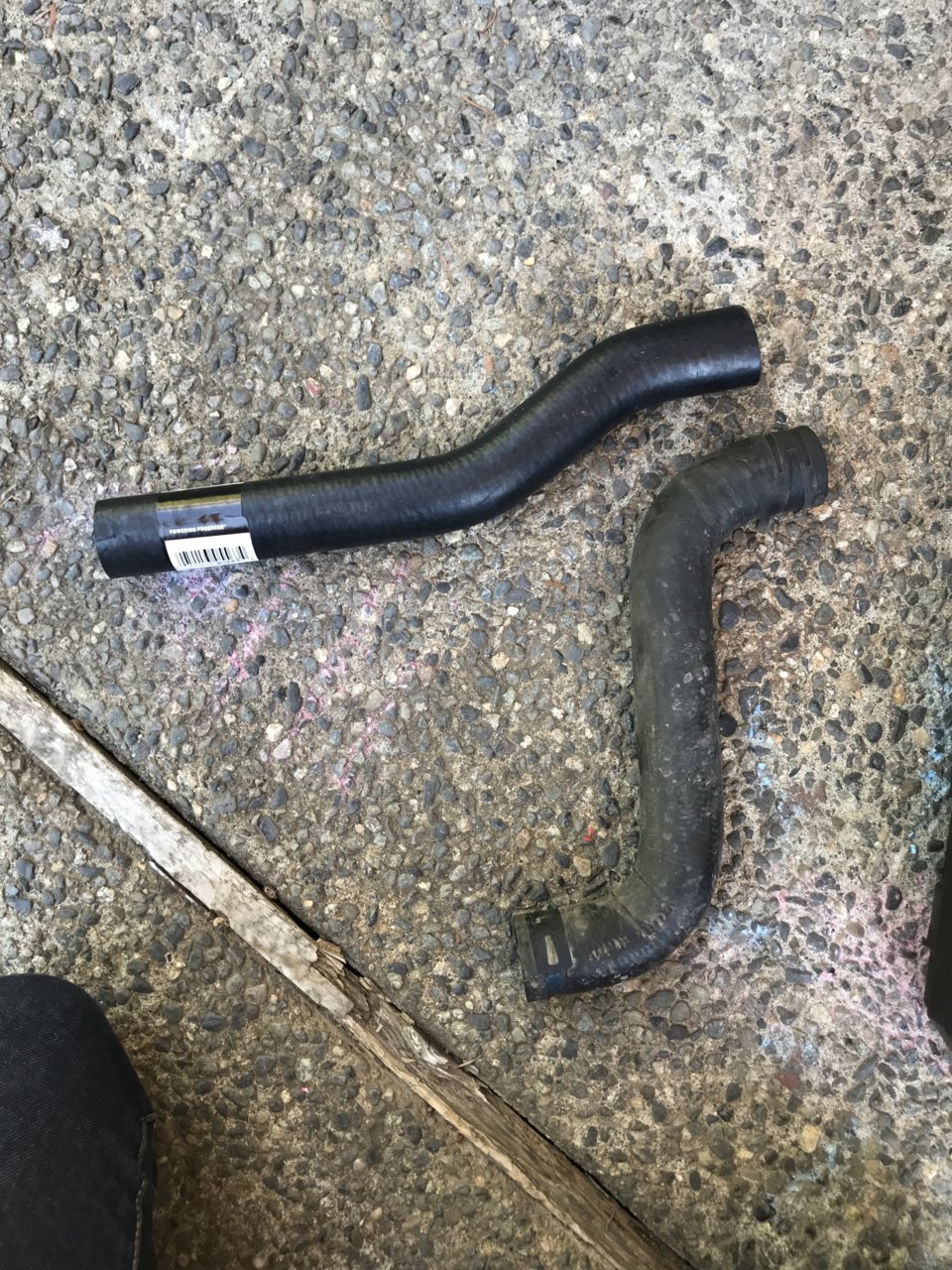

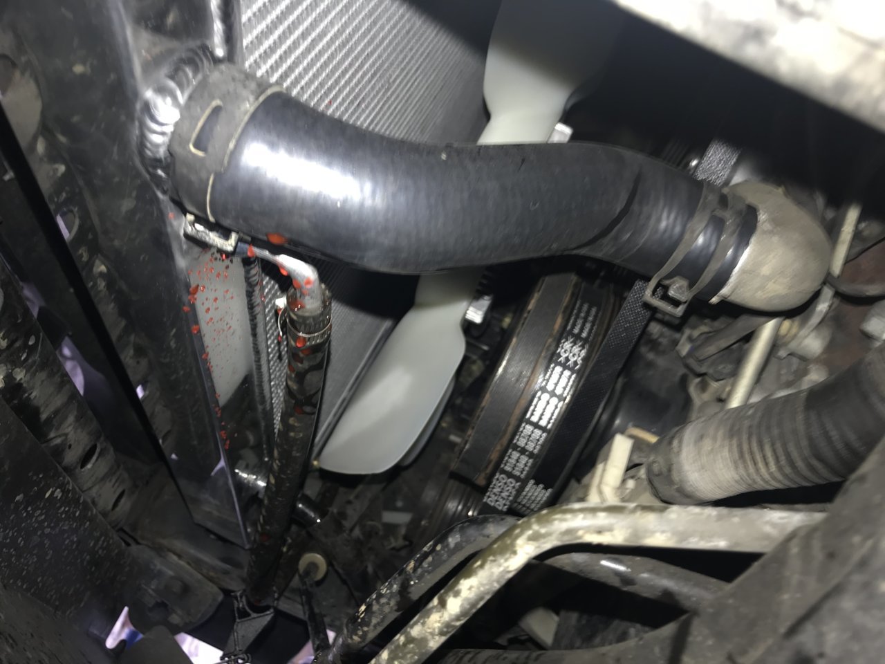

    Installed my radiator today, Only thing missing is the fan shroud. Took the truck out today and it ran 200-206 (without fan shroud). Out side temp was 83f. Not sure what temp truck ran at before. I’m guessing temp will drop down once shroud is installed.

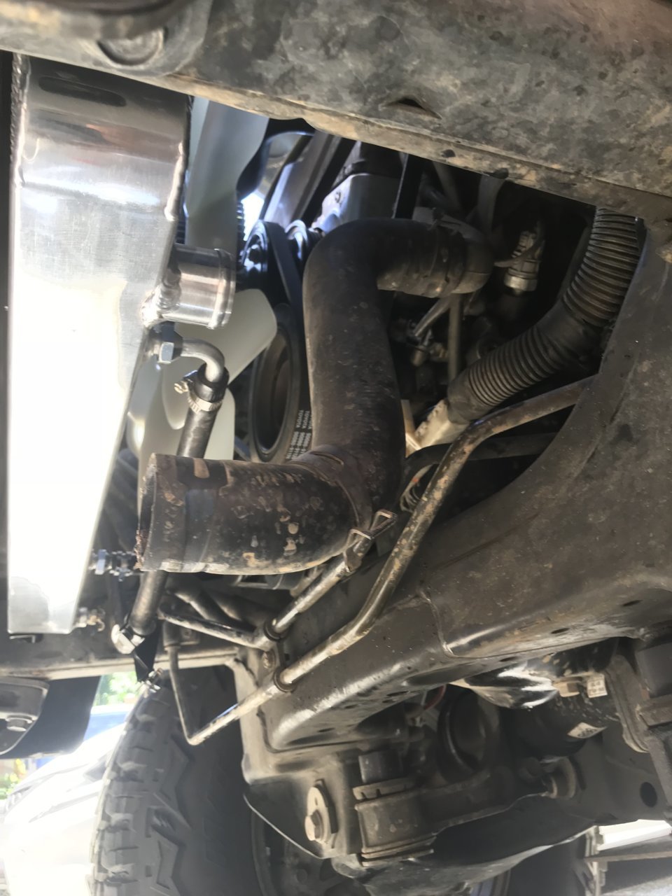

    One thing I do want to mention during the install I had to get a driffrent lower hose. This was because my truck is auto and the champ radiator is smaller (more like the manual). I had a hard time finding the correct hose to fit. Finally I found that the 85 4runner manual transmission hose was the one I needed. Well here are some pics Incase anyone has same issue.

    any pics of the lower radiator hose installed?
    whats the update with the shroud on?
    thanks for sharing

    Mmm the Gates 22120 model hose should have worked with a few cuts for trimming.
    Stock lower hose will not work

    i would like to see what it looks like with this other radiator hose.
    thanks

    Ill get you a pic later today.

    Here is a pic of the hose at the bottom of the radiator. It’s a little wet from earlier when I opened up the radiator cap. Still looking for the radiator shroud.
