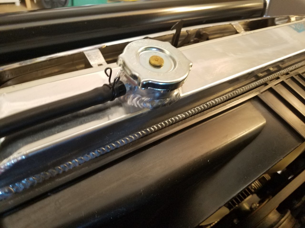

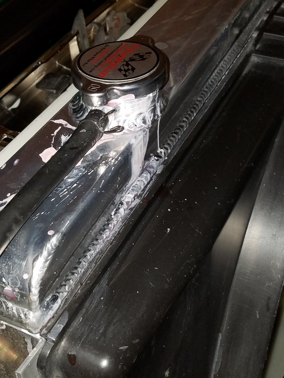

    So I have had the radiator for a while now, the Outside Temps up by 100 degrees or so and the engine still runs at 188 on the highway and sitting in traffic it pushes 195 degrees, if you rev the rpms it drops back down to 188 so all is good
    UNTIL this morning I did an inspection under the hood.

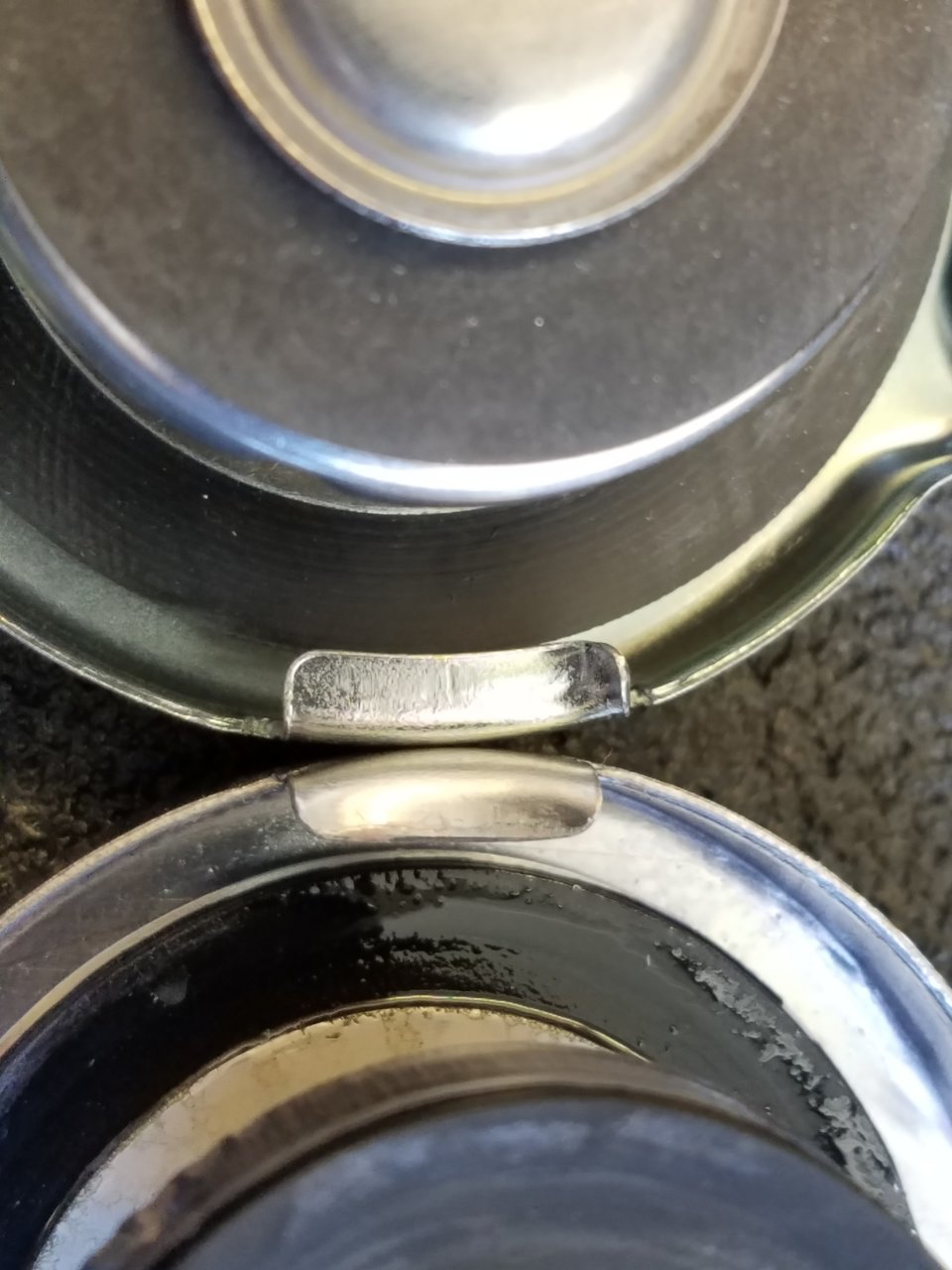

    Mmm, what the heck, the radiator cap was leaking as shown around the bottom lip, so I did some googling and apparently the radiator caps that they use are kind of junky. There are lots of posts of the caps leaking with these radiators.
    I went and bought a car quest universal cap (16 pound) and compared them side by side.

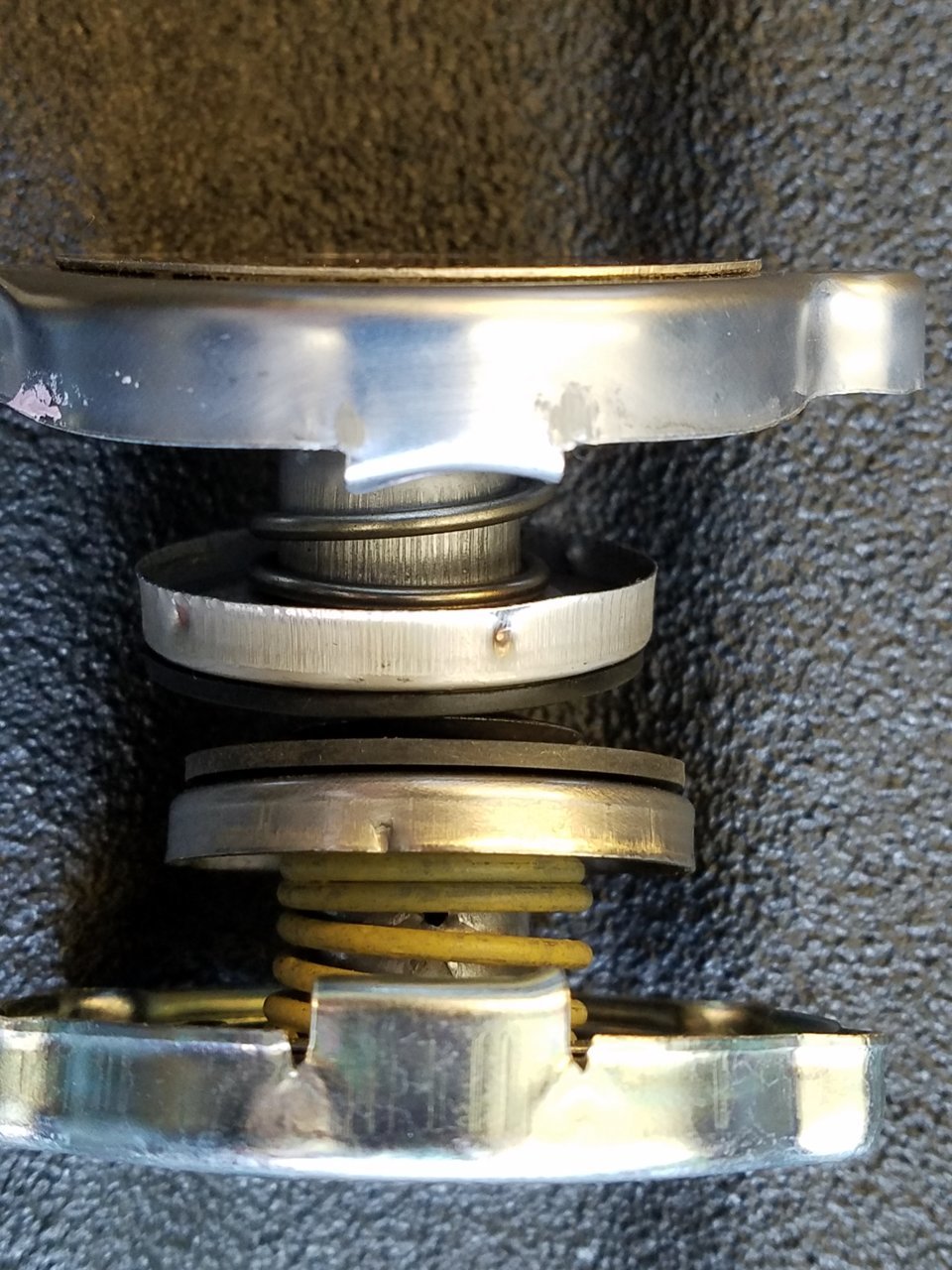

    Yup the Champion cap is made cheap. The problem is the two prongs( locking tabs) that latch the cap are small
    and bend easily thus not making a tight fit.
    You could get a vise grip and bend them to make the fit better or just spend 8.00 and get a better quality cap. My advice is just get a good aftermarket cap.
    You can see the difference here on the two caps.
    The car quest cap has large locking tabs, spring looks better quality and locks on to the radiator better
    New radiator cap installed and good to go

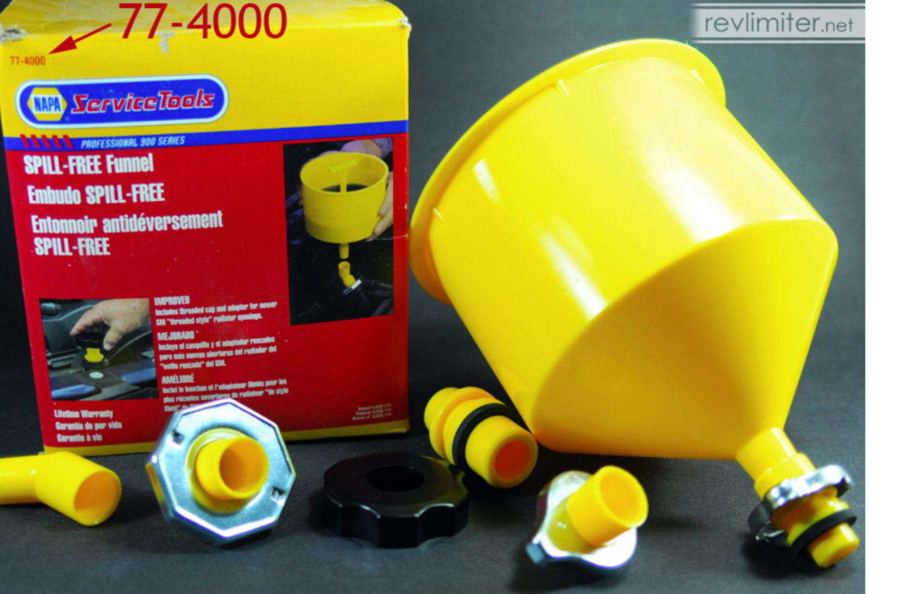

    Might have some air pockets in it, keeps puking out the water. Any tricks besides pouring it in through the upper hose first.
  5. Jul 9, 2018 at 9:22 PM
    #125
    1997tacomav6
    1997tacomav6 [OP] V6 5sp,RegCab,TVS1320 Supercharger,Haltech, 800k
    Oct 5, 2013
    #113940
    10,393
    John
    Denver
    97 reg cab, v6 5sp 300hp supercharged, Methonal Injection, 800,001 plus miles, Original Owner
    V6 5sp,RegCab,TVS1320 Supercharger, 56mm pulley, methanol injected Haltech ECU, AC Tvs1320 supercharger,(MUST DO) every 125,000- 150,000 needs rebuild Projector headlights HID 5 speed manual Amsoil for all drive train Smaller 56mm custom pulley, (MUST DO) 2004 DESNO fuel injectors, zero ping ping, 2004 side door mirrors Dick Cepek Rims, Michelin tires LTX, ATM Pathfinders Dynopro ATM ( that last 100,000 miles) Now running Dynopro ATM mud and snow tires KN cold air intake Cat back dual exhaust with ss exhaust tip, Raised exhaust tail pipe to 2" below body line Optima*dry cell battery,red top Alpine sirius radio, 200 watt amp, focal is165 split door pod speakers Focal door speakers Subwoffer behind seat Viper alarm, Electric Locks Dark tinted windows, bucket seats corbeau lg1 Tacoma Rubber floor mats TRD fender extenders, Bilstien shocks, King shocks JBA UCA trailer iv hitch, electric brake control, Drilled slotted brakes, High carbon steel (MUST DO) EBS green stuff 7000 series pads(MUST DO) TRD engine oil cap TRD stick shift, Marlin crawl shift kit. Rear sliding window 2002 4Runner functional hood scoop cut into Tacoma hood, 4Runner dual overhead map light Gentex Auto dim + Compass + Temp, garage,rearview mirror Snow Methonal kit stage 2 Custom 3 core aluminum radiator Linex bed liner Haltech stand alone ECU, Intake supercharger gauge. Stainless steel brake lines, Custom leather wrapped steering wheel, Haltech stand-alone ECU,
    You have to open the heater valve( push heater lever on) and use a burping kit if you are still having issues, the heater core lines are higher then the top of radiator.
