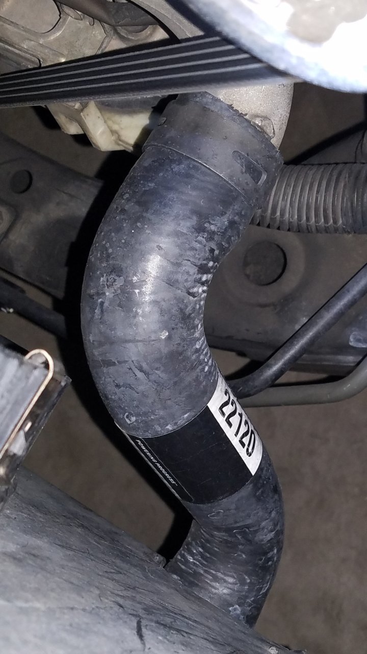

    What lower radiator hose did you end up using?

    To make it easier make sure you have some silicone spray lubricant for the hose and Lube everything up because that lower hose is going to be really really tough to get on either side as its 1/8" smaller then the pipe size and water pump outlet, if you are using OEM clamps the silicone will help with these 2 clamps also get a new radiator cap as the champion ones are no good and they'll end up leaking on the top where they fit together

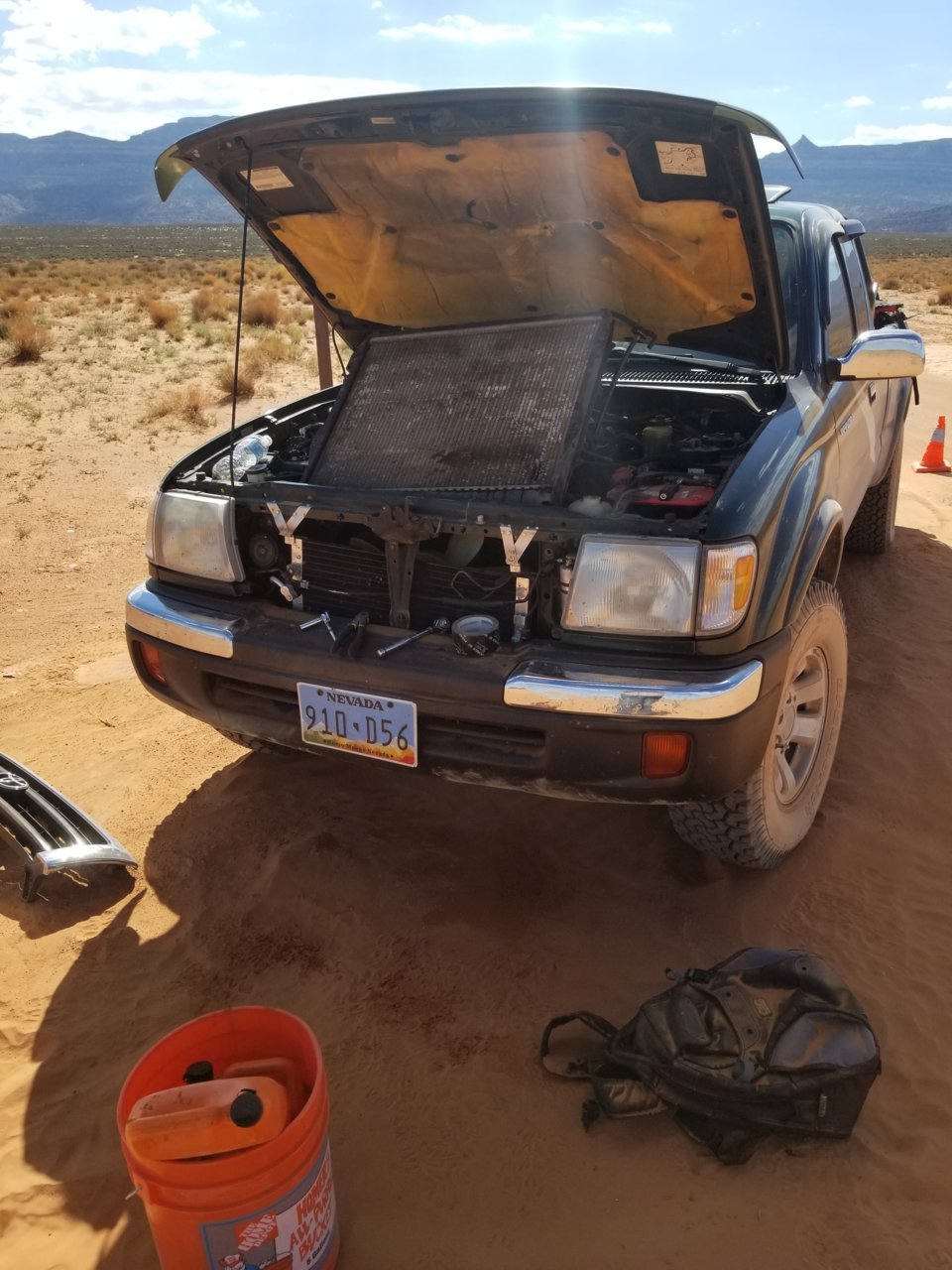

    I read this post back in may.
    I immediately went to get one, out of stock.
    I called 2 times, next mont.
    I placed an order with Jegs that showed shipment September 24th, that cam and went and was cannceled with no estimate for availability
    I called Champion now they say :sadviolin:hopefully by the end of the year but not cretin. :(
    Then this happened. My condenser bracket broke slaming into the radiator down this rough 60 something miles from pavement.
    It ripped the radiator. I did a trail fix, pulling out the aluminum on each side of the damaged tubes crimping the damages tubes shut and then using the egg trick to get back the 200 miles to the nearest radiator.
    So now I will be tuck a stock aftermarket one for a while.
    But im going to weld this one up for a spare in case of another freak incident in the middle of nowhere.
    1997tacomav6[OP] and Dalandser like this.

    Glad you got home safe. How bad was the crack, do you have pictures? I want to know how the egg solution works and how big of a cracker it can fill.
    As for the radiator being out of stock, if Champion doesn’t have them in stock ordering from Jegs is not going to help since they don’t stock those radiators and pretty much ship them from Champion. I need one as well to better fit with my allpro plate bumper. I’ve talked to Champion and they said hopefully in October-November but next year should be expected. If these are container orders from overseas who knows when they’ll get them especially if they haven’t filled the “container” yet.
