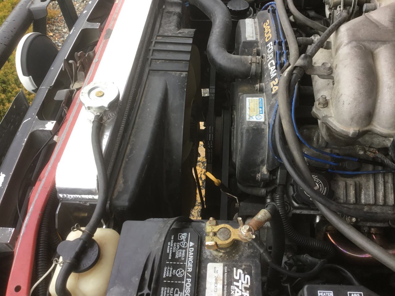

    This 4Runner radiator definitely will not work with the 96-2000 Tacoma hood. Hood hits the radiator cap section.
    The newer Tacoma hood from 2000-2004 it might work if you cut a notch
    out of the hood support for the radiator cap or use a big hammer to bend the hood support.
    The overall size will work but the radiator cap Location is the problem. It’s alots taller, probably would need a different skid plate depending on what u have too because it will hang lower too, It’s actually a better radiator because it’s
    a lot tall overall size.. If I could have figured a way to make this one fit I would
    have gone this route.
    If you had the top radiator tank section trimmed down and or had the radiator cap section moved to a spot where the hood didn’t hit, it just might fit or a low profile
    radiator cap tube section might work too.

    Spacing between the fan and core is just shy of 2” on mine- it is the model with a 20” tall core.
    I’m pretty sure they all come with trans coolers, might even have the fittings-mine did, and the fittings I seem to recall.....

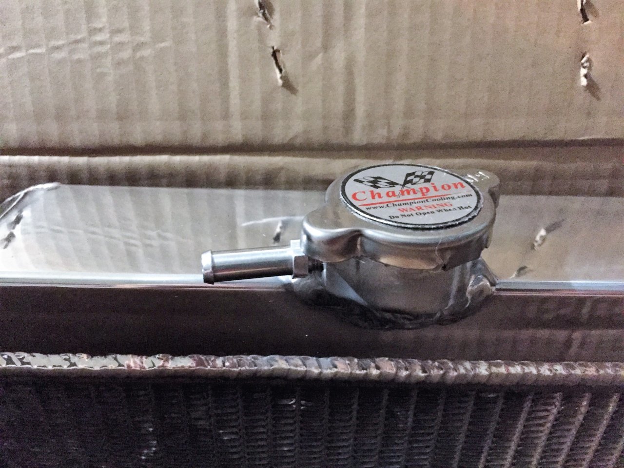

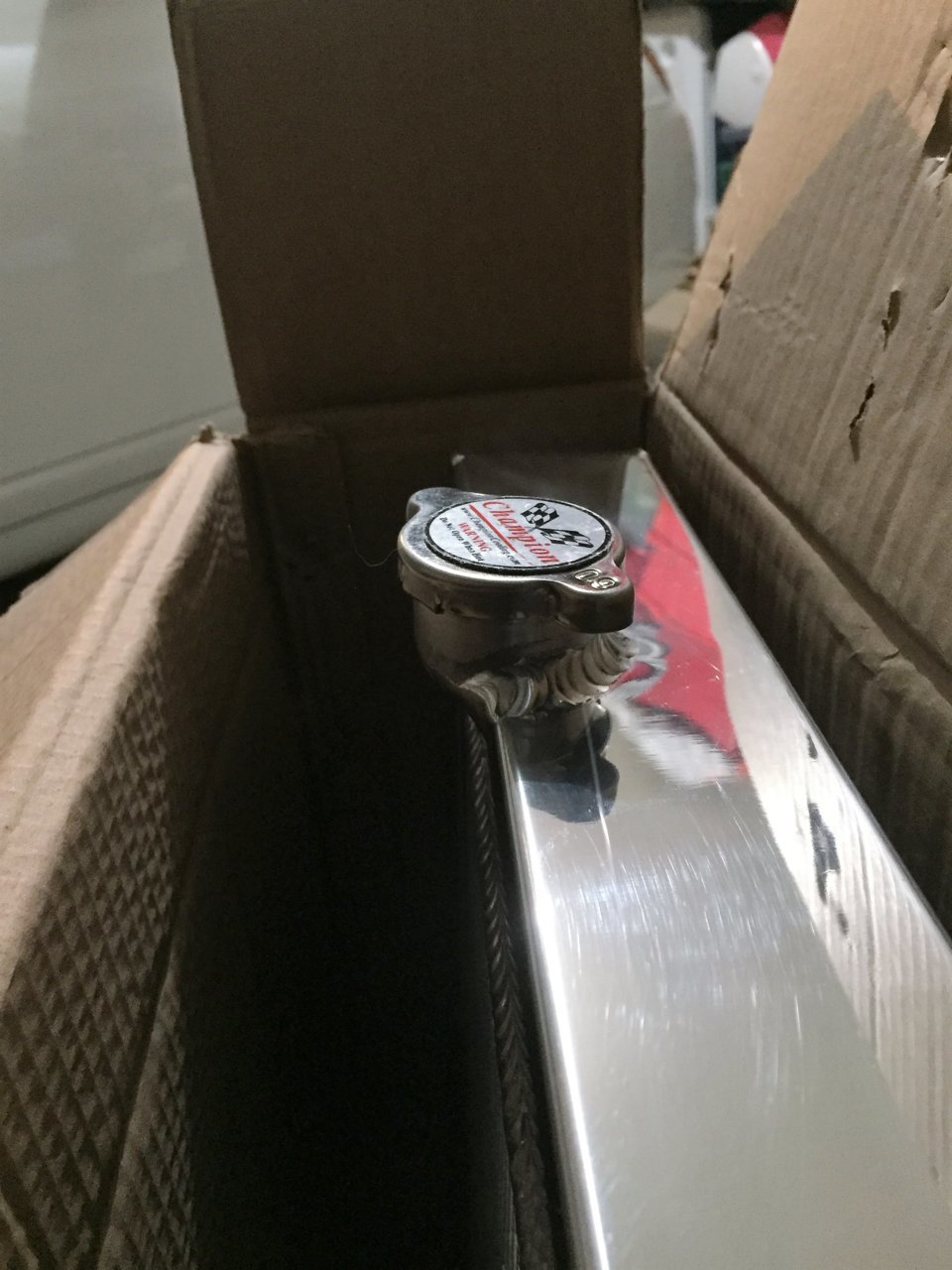

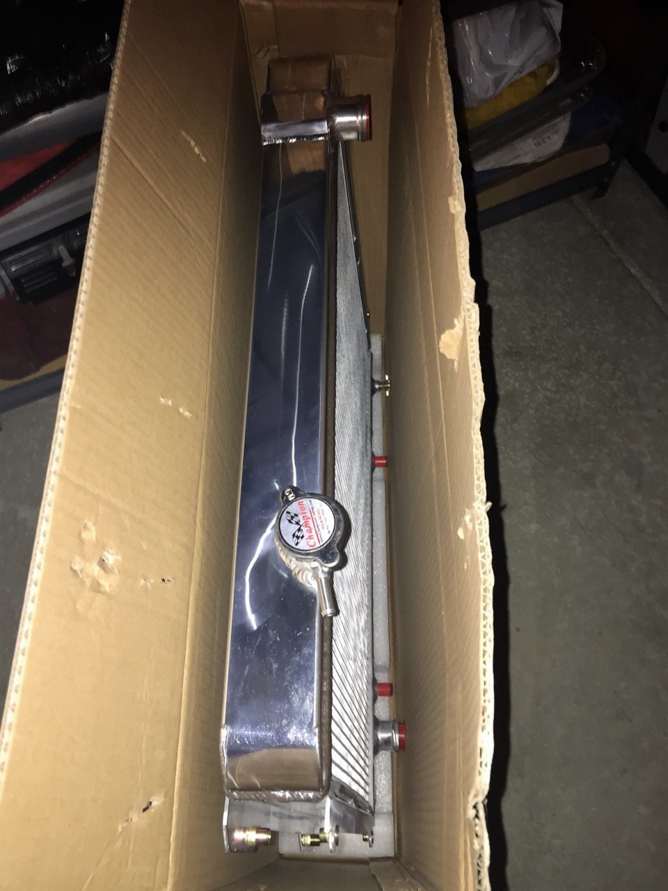

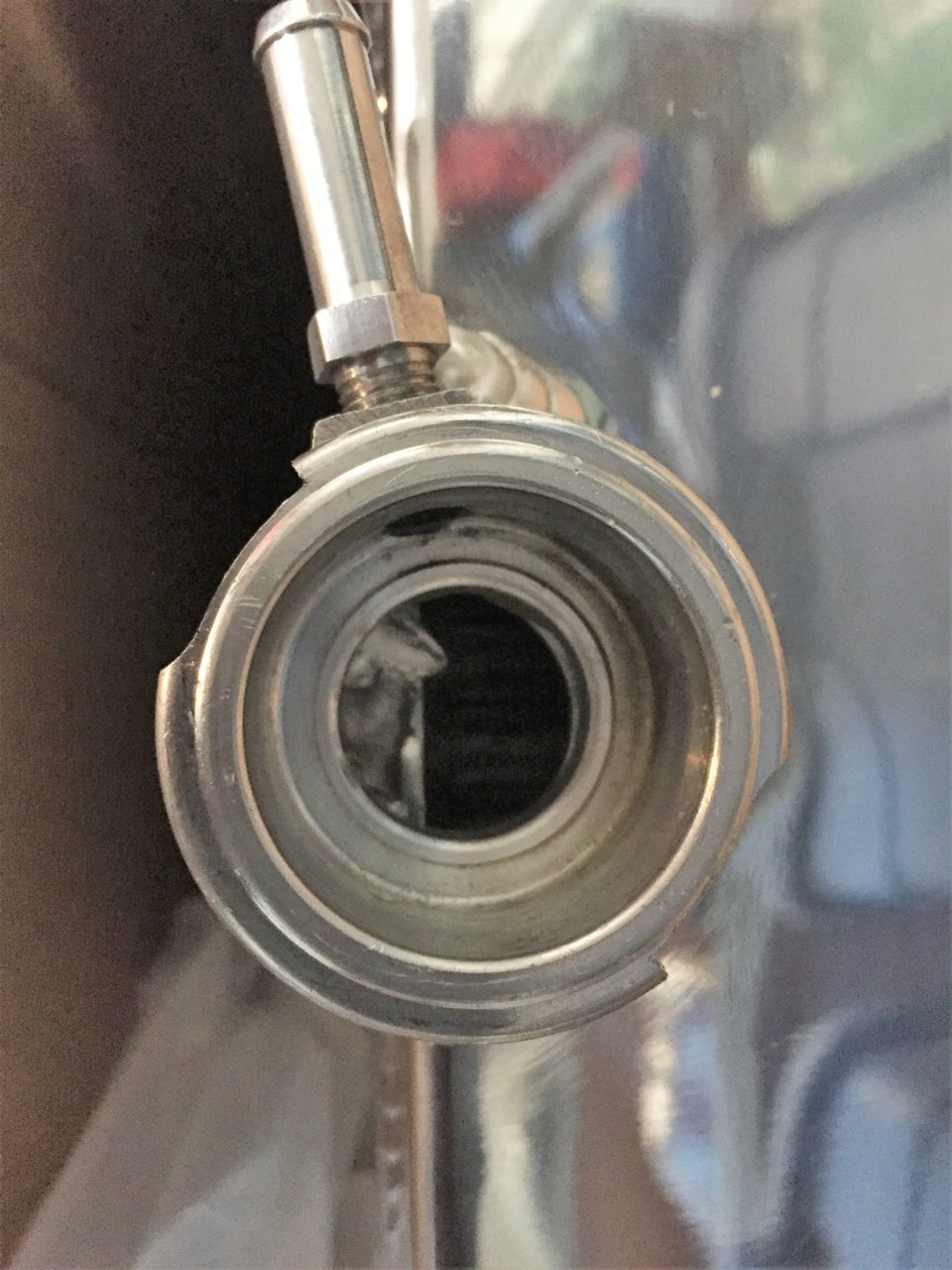

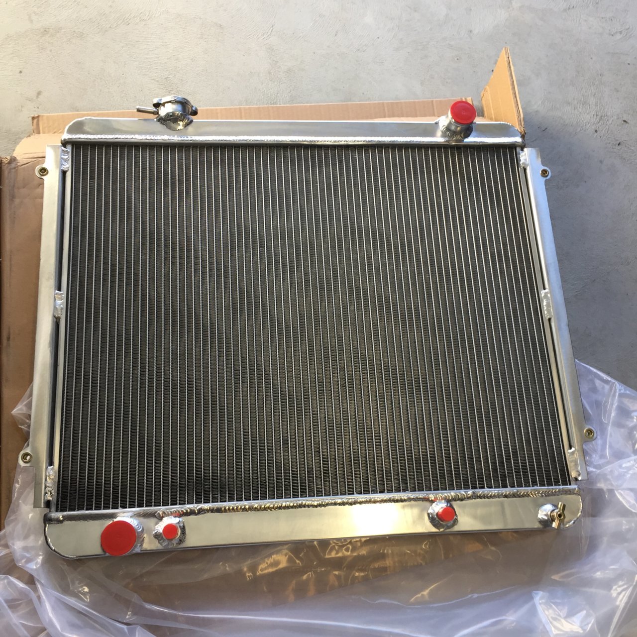

    Just open my Box---Well not sure if this Rad is a " REJECT" I notice the filler Hole/ cap way - Off line, not sure if this location is ok or not. ??
    Any- thoughts. ??
    Part# CC 1778

    Interesting, it’s definitely a reject

    Central Valley
    2002 Tacoma DC 4x4
    Mine is the same.

    WTF, Better call the company ASAP
    I would say it’s a recall thing now,
    Better have the buyer inspect the radiator before it’s shipped

    WOW, What a FFF Bummer, waited a &*^&*^*&^^ Year for this Rad...……. Maybe its off to the side for a reason, Clear the Hood.

    Not sure but I already contacted them. I purchased it through eBay from Champion using my AMEX so I’m not worry about getting my money back. I would like to get a correct replacement and not have to hassle with this though.
