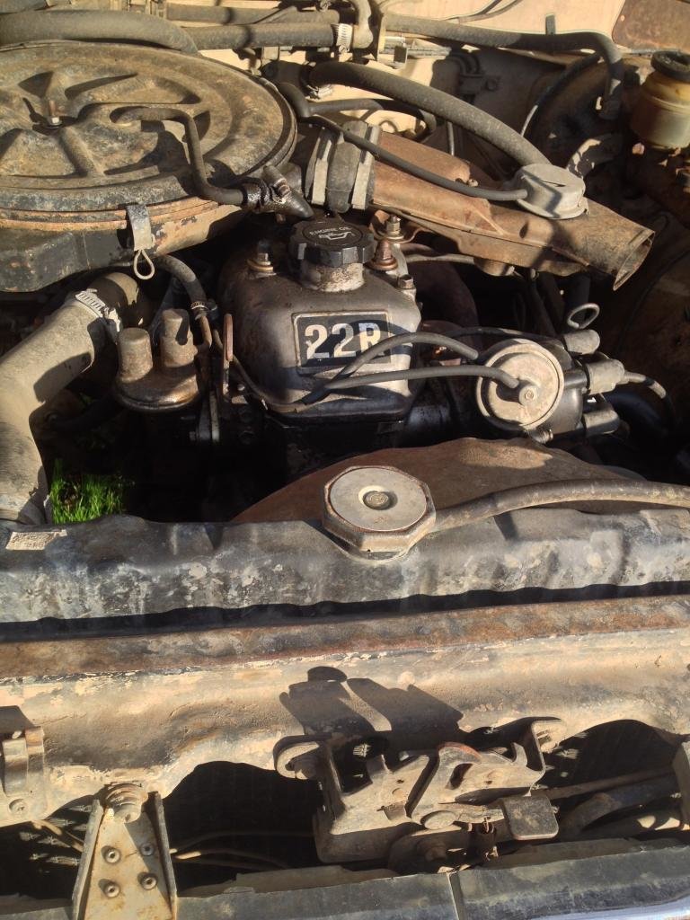

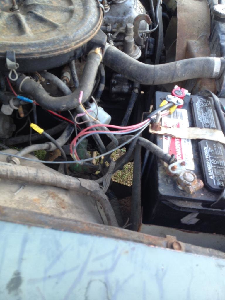

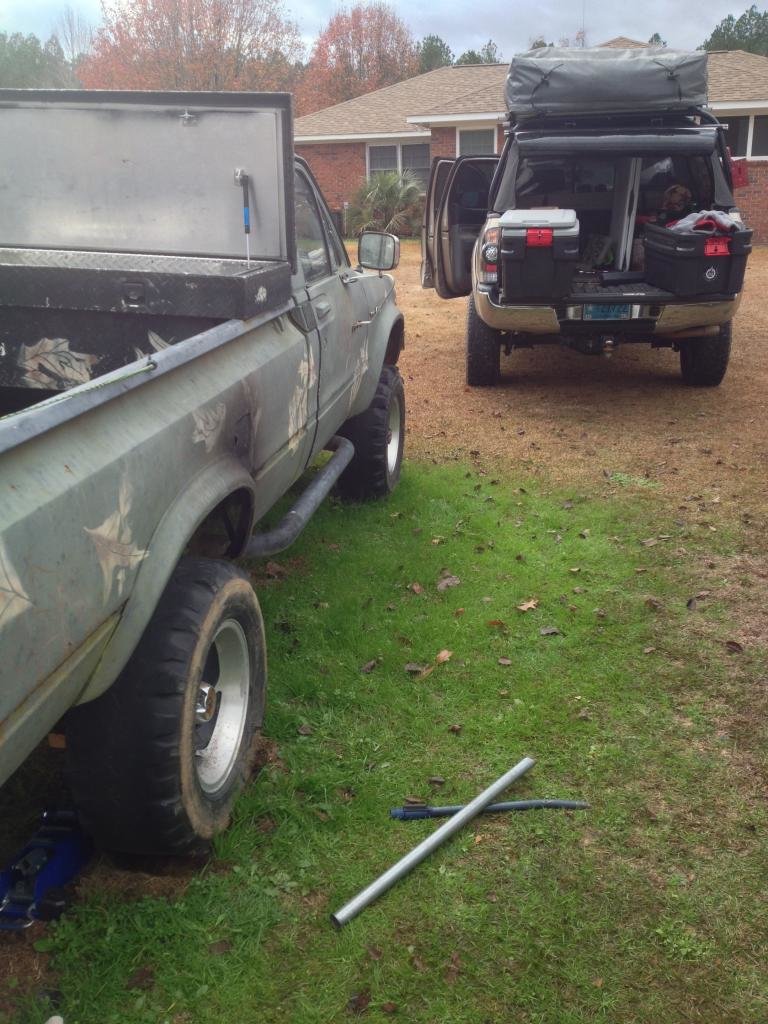

    Aiight fellas, i actually got some work done.
    -Changed the oil (4qts of oil if memory serves)
    -Changed the fuel filter
    -Fixed the rear tire(leaked air)
    Alright now for the real problem, I bought a battery a couple months ago and for some reason, the truck won't crank up on it's own unless i give it a jump with my rig. Its not the alternator because i disconnected the (+) when it was running.
    Today i came home from college and tried to crank it up, naturally it wouldn't start, so i jump it off using my truck. I let the truck on it's own for a while, and then i cut it off so i could change the fluids. I attempted to crank it up so i could move it out of the tall grass and just made a clicking sound( like a dead battery sound). I couldn't believe it. I changed the fluids right where it was but i still dont understand what the problem could be.
    Any tips/suggestions/solutions would be greatly appreciated.

    Your battery needs a good long slow charge... I got a new battery and mine did the exact same thing and even when I would drive for around 30+ minutes it still wouldn't crank back up. Got the battery tested & it was fine so I replaced the alternator & voltage regulator and it still didn't fix it. Finally I borrowed the battery from our farm truck and put mine on charge(slow setting) for overnight & all day the next day. Been fine for months!

    it's an 82'... lol there aint too much going on electrical wise, but i'd never do it on my DD honestly.
    Whats wrong with doing this btw?
  6. Dec 4, 2014 at 5:42 AM
    #106
    ajohnson
    ajohnson Glamour Shot
    Apr 19, 2009
    #16145
    8,496
    Andy
    Charlotte, NC
    07 DCLB TRD Sport Prerunner 4x4
    Things and stuff and such
    Disconnecting the battery can disable the voltage regulator, the alternator can produce a power spike and damage electrical components.
