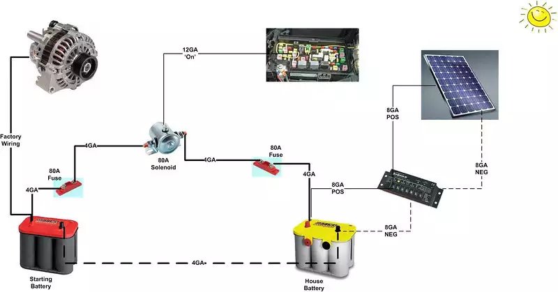

    well finally got off after working about 100hours this week, went to check out the fridge to make sure it still ran(pretty hefty investment), and it wasnt, the battery that ive been using hooked up to the battery box isnt charged and the 50$ 20w Amazon solar panel connections to the charge controller have been corroded from weather i guess.
    Fuck it.
    I figure i got two options now
    Get one massive battery to tie into the fuse box and run my Fridge,seat heaters, and potentially 2 more aux lights should i decide to add them on the front bumper OR
    Run 2 smaller batteries, but that gets a little tricky and i dont think i reeally need two batteries, i'll prob be running a winch eventually so maybe the one Bigger battery can handle it.
    Regardless, i'll hook it up to the bussman fuse box and clean up the wiring..
    What say ya'll? Im thinking one big battery should be fine for simplicity's sake, but running 2 batteries + 100w solar panel would be pretty sweet as well when i do get time to get back out camping/traveling..
    Input?
